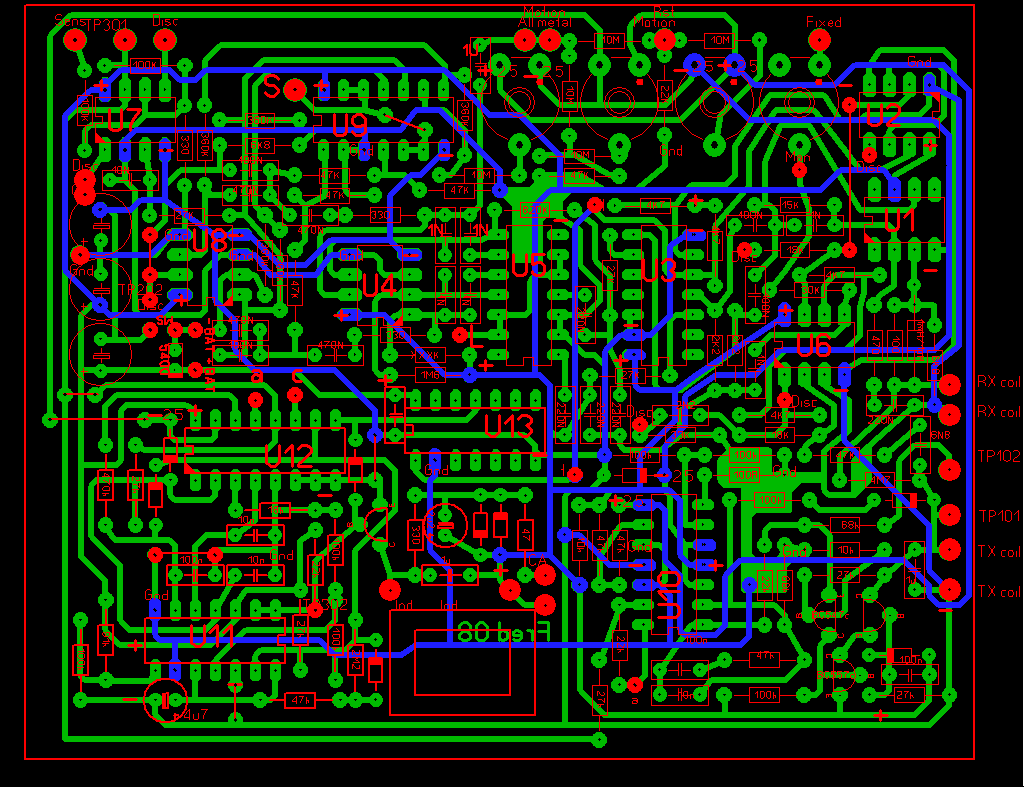

    • Hi,
      I've made some mods... added -2.5 and +2.5 rails + connections.
      Changed some pads to bigger ones and checked a bit...
      I think there could be some other mistake... so better check well first.
      Kind regards,
      Max
        Kind regards,
        Max
        Hi Max,
        thanks,
        I have been improving my version too,most are small details, did you make big changes or found importnant mistakes so i can correct them too ?
        So we don´t end with two very differents PCB
        regards,
        Fred.
          Hi Max,
          thanks,
          regards,
          Fred.
          Hi Fred,
          not big mistakes just that at U12 and trimpots you made no connections to -2.5 and +2.5 or pads but I've used your layout, my idea is always we all use same pcb at the end... so why don't use last version and just mod it more ?
          I've made that changes but would be really good if you will check pcb layout and spot if I missed something along the way...
          Kind regards,
          Max
            Hi Fred,
            Kind regards,
            Max
            Ok yes Max,
            yesterday night i made a lot of small corrections , nothing important but rounded corners etc. ,i will post it here soon with your mods.
            thanks,
            see you,
            Fred.

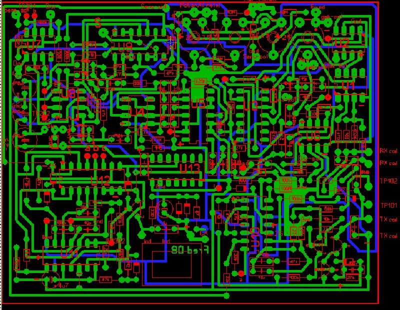

              • Last version with merged mods from Max.
                I used i slightly diferent path.
                From now on i will only mod the last posted layout,so we dont have 2 diferent versions.Also a list of mods made would be usefull each time.
                Here beside small details, i used a jumper to "B" connection and changed value of resistor from U12/12 to 27K instead of 22k .
                regards,
                Fred.
                  regards,
                  Fred.

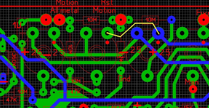

                  Hi Fred,
                  you already made some corrections, good. I think the best way to help you now is signaling where are problems in pcb so I'll do by pictures and just you will make modifications using sprint layout.
                  This way we'll end up with a unique pcb design.
                  Here's the first I spotted already: I think we need that yellow track there.
                  Kind regards,
                  Max

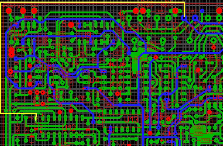

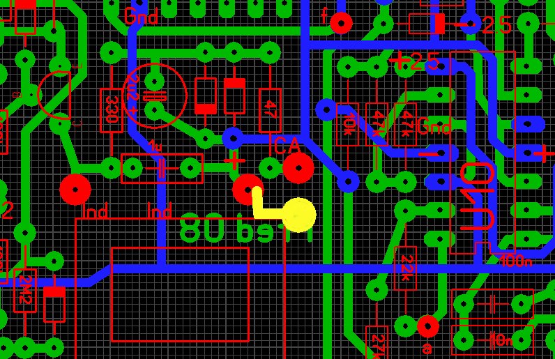

                  • PS: we need also this -2.5 point connected to -2.5 rail and an extra pad for C.A. at +
                    Kind regards,
                    Max
