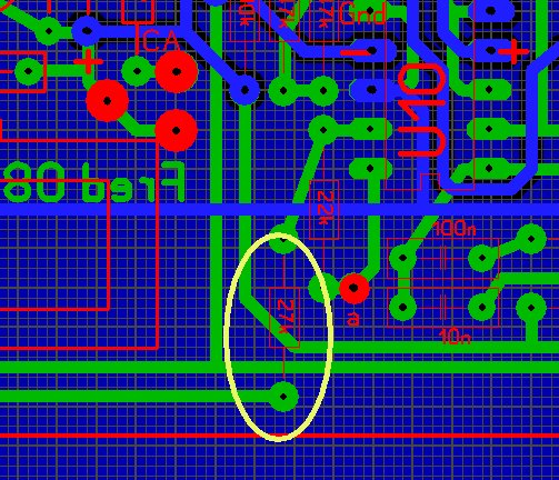

          • Hi,
            another little mistake found: 27K for 22K at unity gain inverter.
            Changed to 22K.
            Kind regards,
            Max
                      Changed to 22K.
                      Kind regards,
                      Max
                      Ok, i mistaken with other resistor.Twice...
                      regards,
                      Fred.
