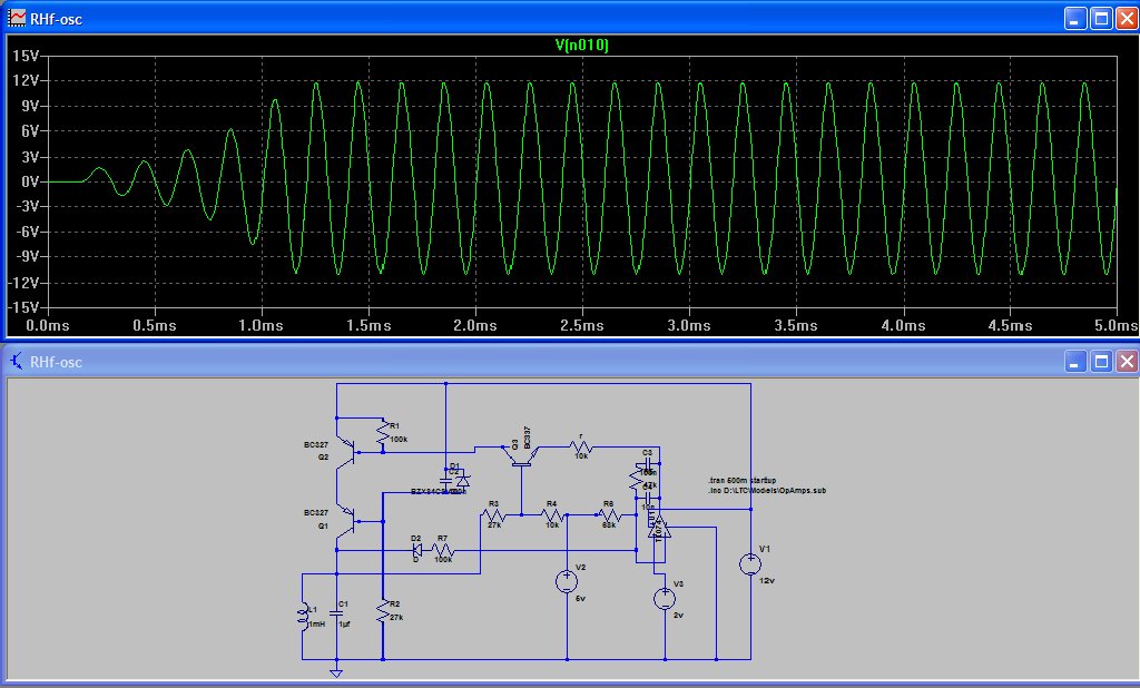

      • Hi Eugene,
        very good! We got it!
        In the picture you can see simulation for 3.5ohm, about 24Vpp sinus!
        I tested with 10ohm series resistance at coil! And works too now!
        But at 10ohm one get just 11Vpp of signal... sure.
        Kind regards,
        Max

          • RELIC HAWK
            Amazing MAX !!! Clean oscillation now , no distortion or envelope/modulaton like the first few simulation's from to much feedback . You have optimized the circuit with the BC327'S and the BC337 !! Now the TX coil will have some tolerance +,- , and not be so critical on it's specs .The oscillator circuit may be better than the original . So we are teaching the "student's" at the Minelab office again today . This project is going quite well !!!!!! ................Like "Crocodile Dundee" from down-under said : "Put another Shrimp on the Barbie".............Aziz , Your Smiley's are Cool , especially the "Tire Marks".... Good Day to everyone !!!....... I Gotta get back to my "Integrated Circuit" Writing's.............Eugene

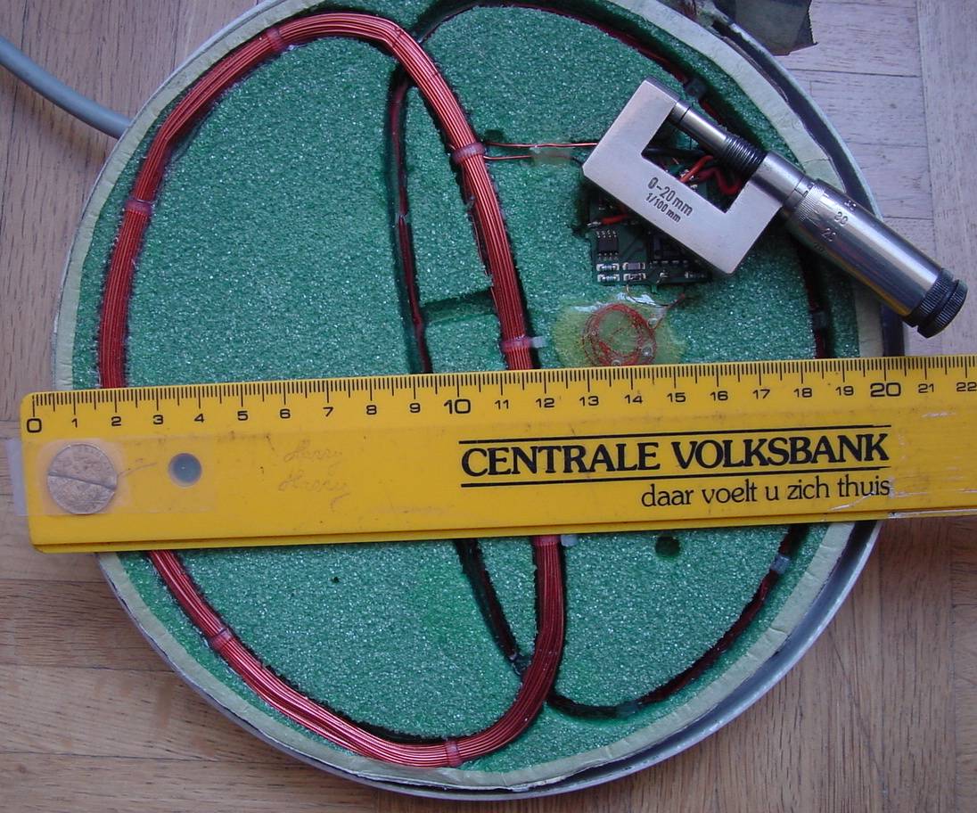

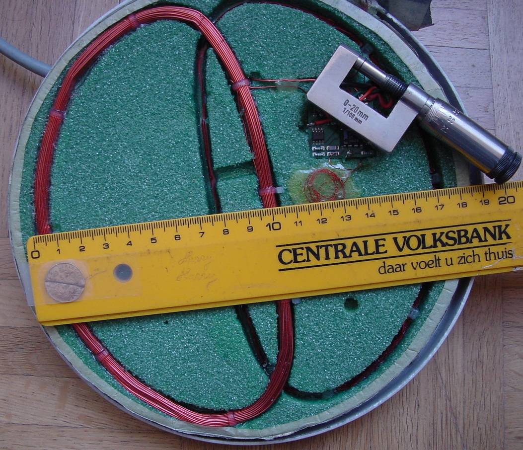

            • Again on coil;
              yesterday for the first time i checked those datas for coil, included on schematic. Not accurate!
              My original coil, like i posted earlier, are 41 ohm for RX and 3.1 for TX.
              So... i took 0.2mm wire and wounded on 30cm diamm. circle, gave me over 100 ohms !!!!!?
              So it is not 0.2mm wire, for sure!
              Point is to draw 30cm circle and form former to wound wire.Later take off windings and squeeze them to form "D" shape. Formed that way "D" shapes perfectly matches original RH coil size. So...assuming that number of winidngs are correct, i checked resistance and like posted - not accurate.
              Today i will try with thicker wire. My idea is first to match resistance and later measure inductance. Both values we do have - noted on schematic and of course i can measure and check on my original RH coil.
              So...give me day or two i and will have most accurate datas for original coil.
              Original or as close as possible to original coil must be made FIRST, to void any further missunderstandings about oscillators work, drifts, interferences and simillar....
              Agree?
              Regards!
                Again on coil;
                Agree?
                Regards!

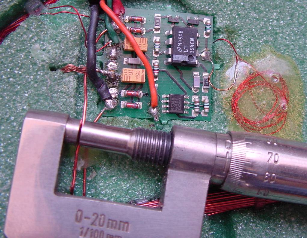

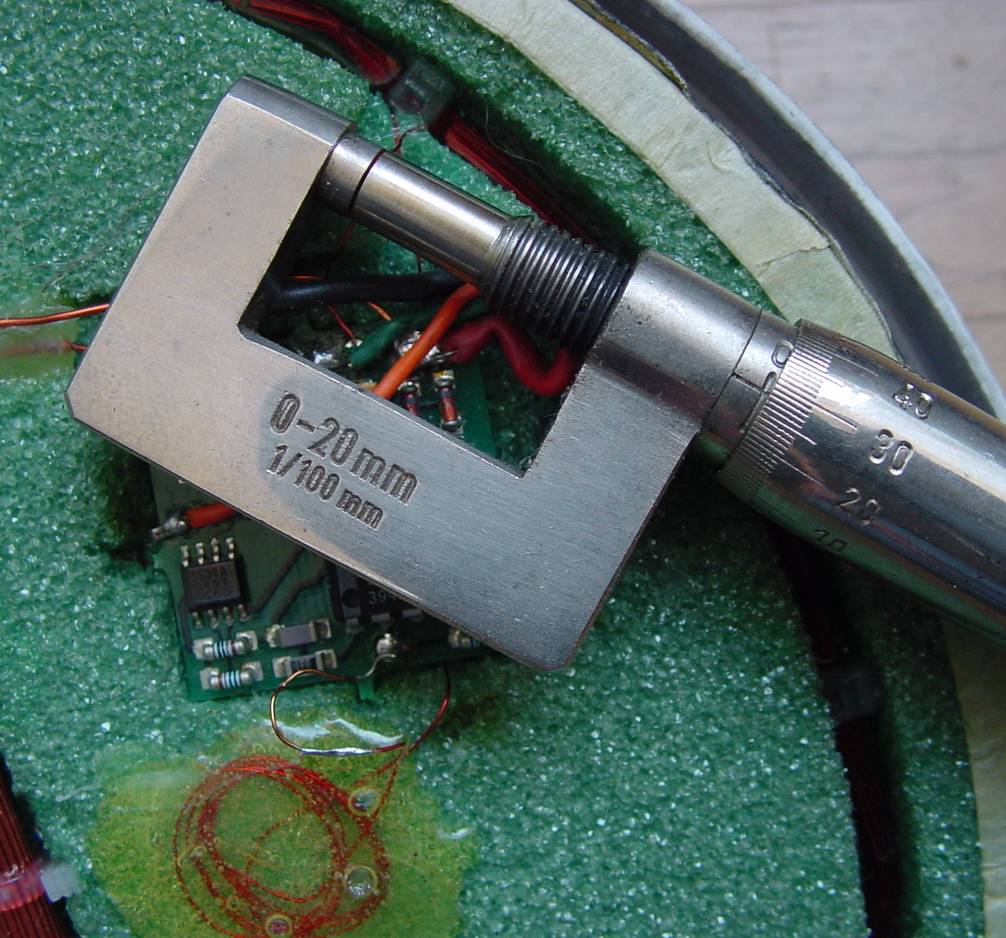

                • Hi Max,this is ml sov coil.
                  • Attached Files
                    • Attached Files
                      • Attached Files
                        • Originally posted by nakky View Post
                          so on that is 0.65mm! But probably wire is thicker there than in RH coil.
                          Sure ML like big wires...
                          Kind regards,
                          Max
                          • Yes...could be wire from 0.26 to 0.28mm....
                            Now need to find that wire gauge...
                            Most important is that i just measured again inductances on original coil; those are as noted on schematic: 1uH(TX) and 15 uH(RX).Coil is as posted 35mm, outer diammeter.
                            "D" shape from original coil, converted to circle gives exactly 30cm diammeter. So....there are enough elements in our "quotation" to conclude the rest and succesfully make proper coil.
                            Regards!
