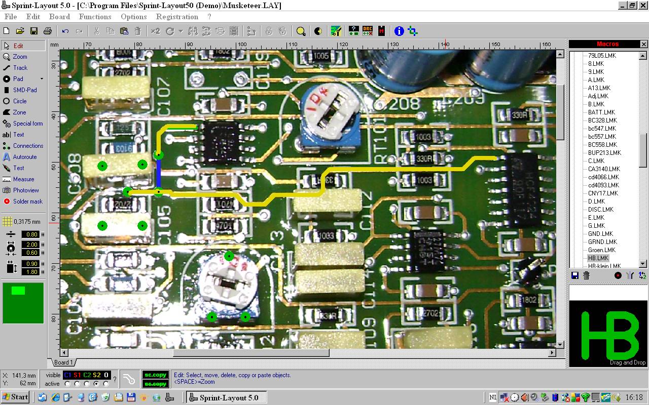

    I took a look at some pictures kindly provided by eclipse ... still cannot figure out about "f" stuff... cause difficault to follow but I see interesting stuff.
    ...all double op amp ic are 27M7, that would be nice having too there

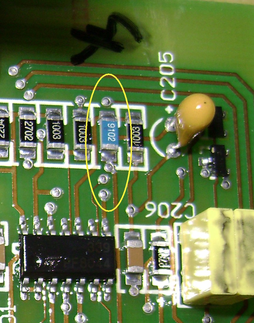

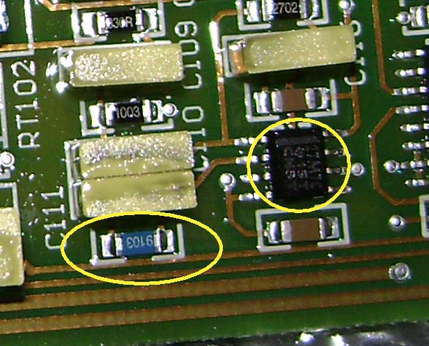

    • Hi,
      I found now the 91K... so it's right in schematic we have.
      But why there are 910K resistors then ??? Different from our schematic.
      I found 2 of 910K till now, we haven't in schematic.
      Kind regards,
      Max

                      dang... you miss the RH on ebay! I saw the last offer was low for the value of machine. You lose that bargain... anyway... we are doing good here... probably you'll get enough informations to build one at the end.
                      Yes, they are not the same stuff... I think the 910K resistors are employed to lower the gain of some particular stages that have the bad tendency to saturate easy. But probably more than 95% is the same schematic... I see many similar pieces in the picture.
                      The brown smt with no labels are the decoupling caps 100nF at op amps.
                      Thanks for posting that pictures... everything is useful.

                              • Eclipse,can you make two better pictures from the total board,top and bottum side or can you trace the F line ?It is hard to do with this pictures.Grt Nakky.
