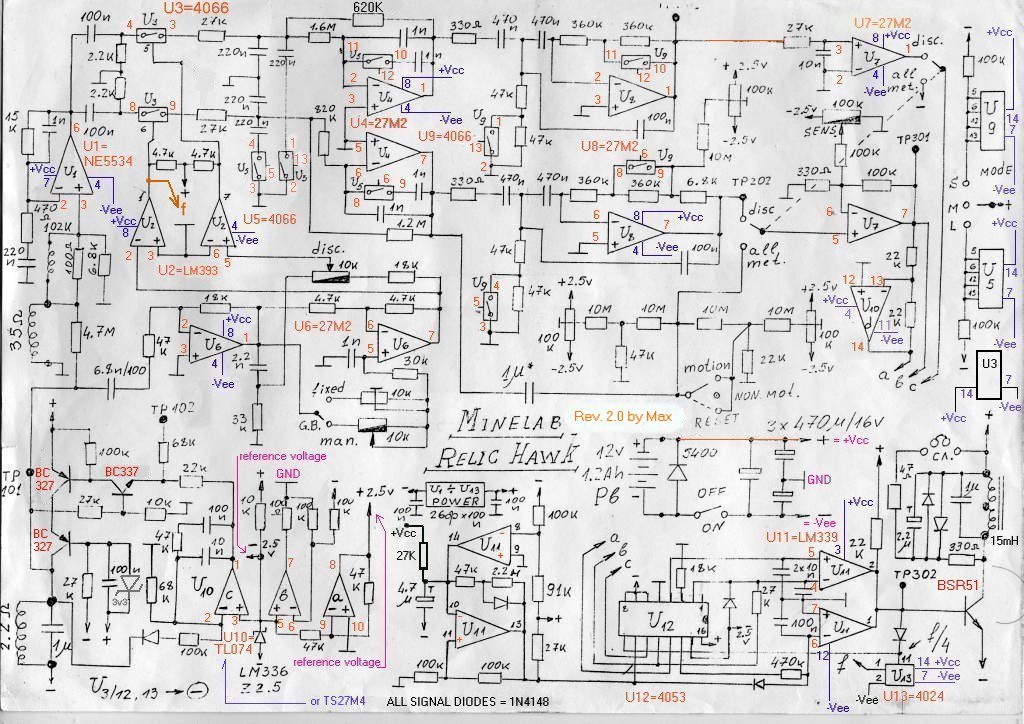

    I've solved battery checker issue.
    The first you need to look at 4024, look at pin2, reset. It must be connected at -Vee not at GND... this is a very stupid mistake or intentionally faked connection.
    Then you can leave circuit as in schematic (if you still trust original one... ) and you'll get, about 1Hz pulsating tone when battery will drop under 7V.
    Now the problem is... 7V for a 12V gel type means the battery is faked too... or damaged I mean... cause it's too low for normal, good operations. So you'll run device, this way, knowing zero about potential voltage imbalance due to battery till it will , in practice, die.
    Smart solution:
    put a 27K on pin14 of U11, then you'll get right pull-up action you need.
    Behaviour is different this way: when battery goes down 9.45V you'll get a steady unbreaked tone... so you MUST know your battery is discharged.
    Consider also that for gel cell this mean about 1.575V per cell, so a good value of discharge... rational and as expected for the unit and batteries of this kind.
    The "smart" behaviour is like in AN/PSS-11 old mine detector... that I think inspired ML about this piece of circuit.... it's a steady tone for low battery, you wouldn't ignore it when on a minefield!
    Here revision 2.0.

      • Hi Max,
        Thanks for new version
        4024 supply change is very important , i may afect other stuff too.Did you try it after that?
        For voltage detection i would intead try to play wut the 91K resistor value.
        I dont think those errors where intentional.the all looks "logical" .
        Hope someone here will buy the RH from UK and show some pictures.

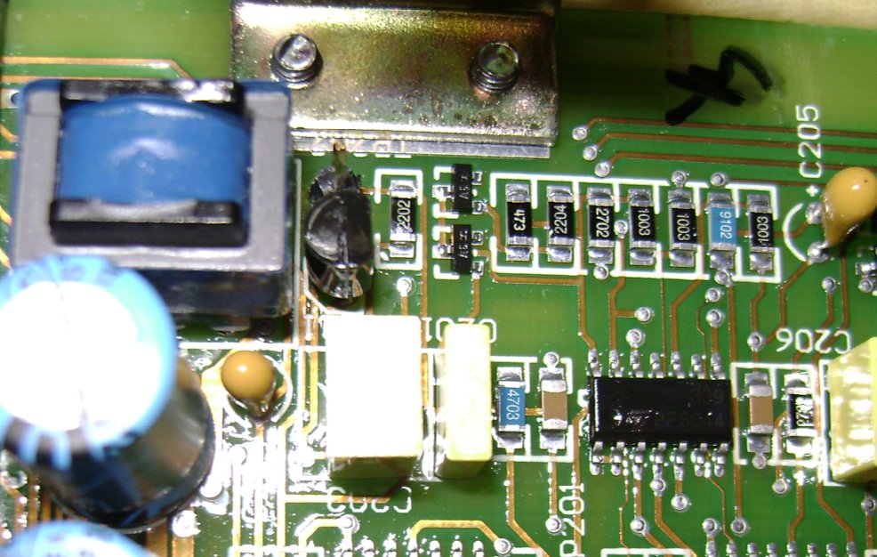

            they are different at audio stage: there are 2 SMD transistors in Musketeer that there aren't in RH. The 2 transistors are probably some push-pull stage but I'm not sure about...
            You can see them here... difficault to follow cause tracks are partially covered by components.

                Hi Max,

                Hi Fred,
                well yes... it's really a stupid mistake there... but not so dramatic as effects if supply voltage is high enough... device will works too cause reset will get a logical zero.
                Where it's really problematic ?
                If you don't change that... the 4024 will simply stop working at 10.75V along with the rest of circuit ...gates...etc and you'll never be alerted of e.g. battery drop or why it suddenly die that way!
                I think some bulgarian folk runs here and there with 3 or 4 batteries always fully charged! Cause still ask himself why that dang thing die at 10.75V!
                PS: if not intentionally faked... how explain the schematic on page 1 ? I mean also there the reset connection is wrong (floating... so can get noise...) instead that at -Vee as required.

                • Hi Max,
                  Yes you are right about the other schematic, strange indeed .
                  But reset input at 2.5V above reference cannot be very good .
                    Max,
                    This time, those are diodes. BAS16 to be exact (see attached PDF data sheet). SOT23 case. The key is the "A6" marking. If you look at all the other pictures, youll see that they are used all over the Musketeer board (in fact everywhere there is a general purpose diode).
                      Max,
                      I think you may find that under 10.75 V, the oscillator no longer works (at least simulations indicate this).

                        Max,
                        J. L. King
                        I knew that before, only was affraid Max could think that now i am fooling arround. Yes...this time those are diodes not transistors (life is strange, i never thought i would say this!)...
                        No, seriously...Max if you look more carefully on RH too, you will see those 2 there also. But second look on latest photo .... seems one is diode for sure and other could be transistor!? 3 routes...or i saw wrong?
                        Anyway, on previous RH schematic (faked one) those 2 diodes are present in audio stage. Reversed actually, protection...limitter...the hell with Minelab's mumbo-jumbo designs!
                        I remember for sure that those are dides on RH. When my RH burned, i tried to locate problem and checked all componnets in audio part. Beleive me or not i desoldered those two and checked with multimeter - diodes for sure!
                        But i am not sure in Musketeer case...could be transistors?

                            Max,
                            J. L. King
                            no... I've tested on my PCB it stays up and running still at 6.5V only.

                              Hi Max,

                              Hi Fred,
                              it was at GND... so a bout 5V from -Vee, that could be good enough if +Vcc is high enough.
                              That's why it worked also with pin2 at gnd, but then, device stops working at 10.75V that way.

                                ok... they are diodes this time ... but the question is ... how the hell Musketeer drives the speaker directly if the stuff is the same that at RH ?
                                Really confusing stuff...
