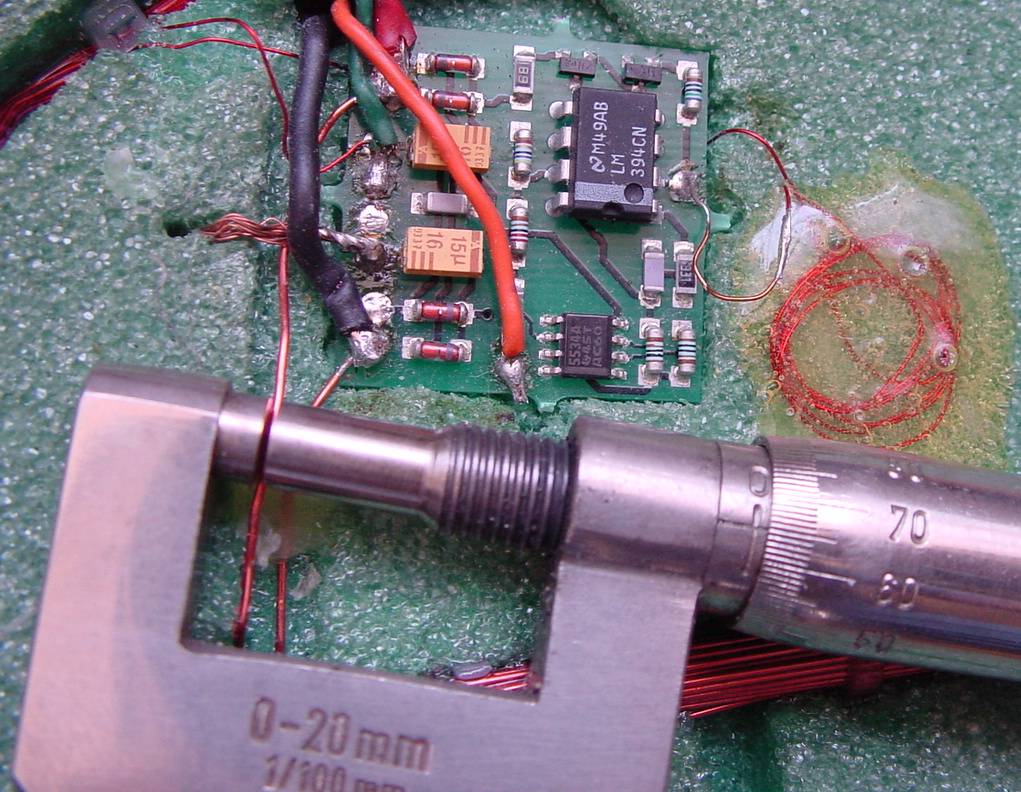

                            I also started thinking that original coil could have something hidden (e.g. a small circuit + some additional coil) to prevent such ferrous signal to be amplified further... but I cannot be sure of this... I haven't RH or a RH coil... cannot do anything to confirm these suspects.

                            • Somebody can scan a coil in some hospital.. , and to post photo here and we will know if something is hidden
                                yes, it's a good idea... I think could be something there that make this puzzle so difficault...
                                for example in the sov coil picture provided by Nakky there's a ne5534 smt + an lm394 supermatch pair...
                                Sure detectors are different but... who really knows what's inside the big RH coil ? Is just wire... or there's more... like some phase network + amplifier and the like ?
                                Real puzzle!
