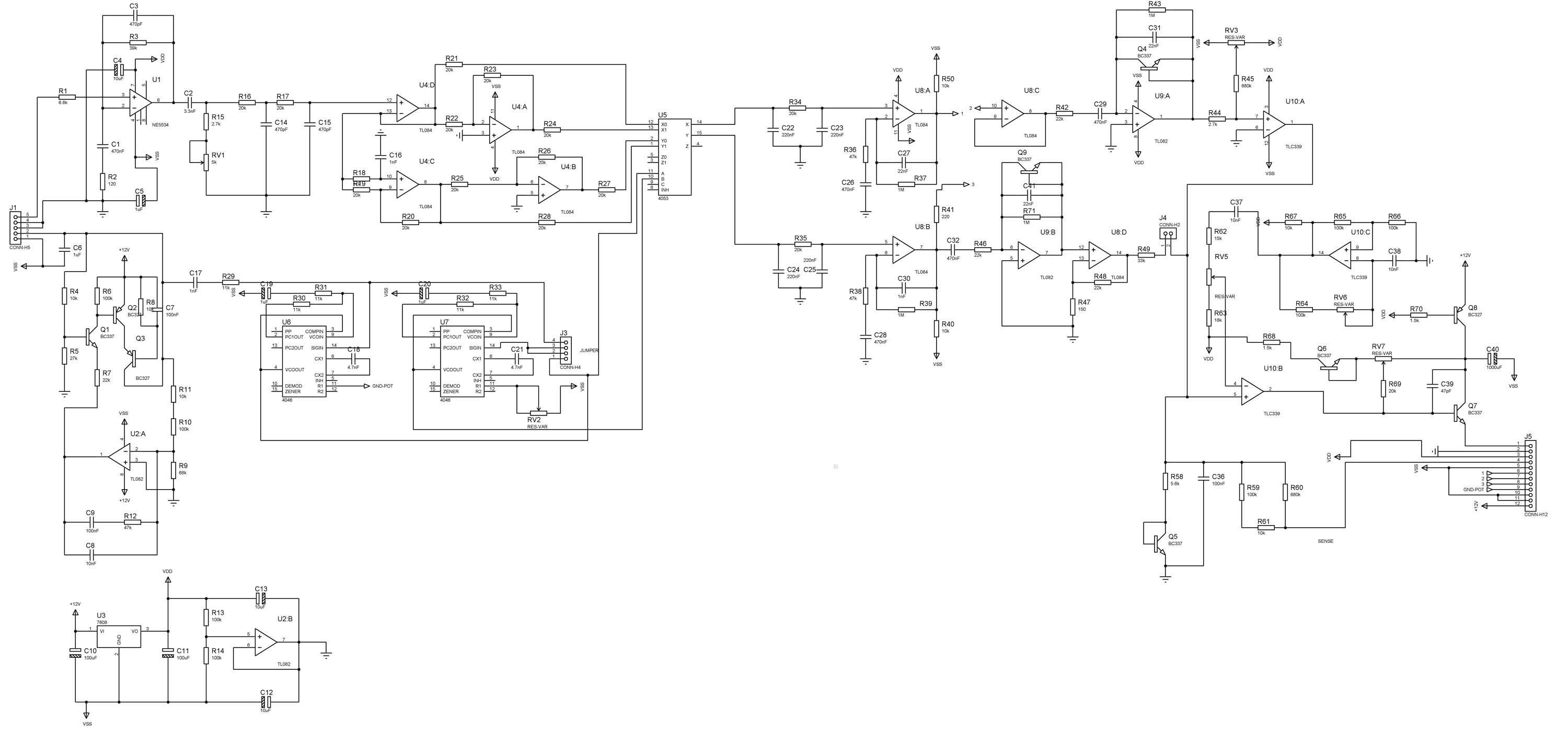

    • Since RH hit the stone here is
      Old idea, but fresh for the forum, never posted before.
      Fisher 1266 + Relic Hawk. Never done on pcb, never tested. Just raw concept of combining RH TX/RX circtuit with Fisher 1266 with ML RH coil type.

        What's this new schematic ? Hybrid stuff ???

                      I spent a few hours Today "again" digging in the Geotech archive Dungeon !! Anyway , I did not get the answers I was looking for. On this forum a few years back were several photos of assorted minelab coils , some were an X-ray image and some were torn a part. Charles of upstate New york had some great posts about 3 years ago , but no photos anymore !!! I found some posts that had a little red-x in the corner that means they have been removed , which is ok to me . All I want to find out is , why some minelab coils have the little circuit board inside the coil and why some do not . I guess it might be a Pre-amp or used for some kind of impedance matching or even some kind of EQ "equilizer board" for Broadband BBS . Maybe this little board can be used in several minelab detectors , and if there is a minelab detector that needs just the search coil and doesn't need the little boards function , it will not send a low dc voltage to the little boards switching transistor , and then it will act as just a high impedance load and do nothing more. I wish I can find all those photos . Another Unsolved Mystery on Geotech !!! I am still searching till I get all the answers / Specs that I need , or find all those great missing photos..................Take Care Everyone ..................Eugene
                      • I am guessing that RH does not have any circuit inside the coil just a small round (25mm) winded coil which is 1uH on the schematic. If i remember right its used for adjust phase shift. No other components used
                            yes, seems so. But we have it on PCB ???
                            So maybe the problem with disc is there!
                            Maybe that is a compensating small coil used for phase alignment and must be inside coil housing... not on PCB!
                            Hell, this is an important detail!
                            Do you mean the "102K" stuff there ??? But it's 1mH not 1uH ! Mistake in schematic ?
                            Kind regards,
                            Max
                            • 1 micro (1uH) it is. It work both ways on board or inside the coil. If it is on your pcb you can adjust the phase shift the way ivconic does - with small pieces of metal inside the coil.
                                Do you mean aluminium foil pieces ?
