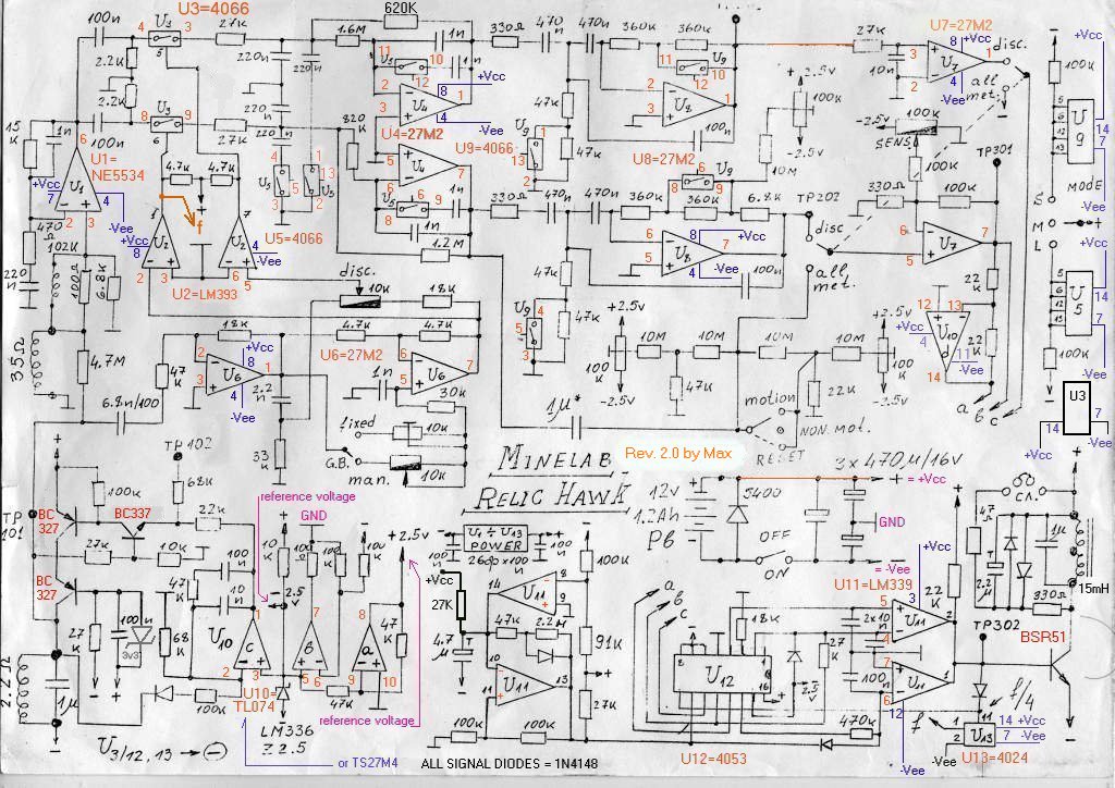

                    • last schematic revision (2.0) , reposted here
                      here is again last schematic revision 2.0.
                      It works. I think no mistakes anymore on this...
                      Kind regards,
                      Max
                      • I will post the last version of PCB today. It would be great if ivconic could make it, as he owns the original coil and with oscilloscope, could tell how it works with it.
                        Nights are becoming longer and soon i will continue mine.Probably when hours change

                          • Here is last RH PCB for Sprint layout 5.
                            I donĀ“t think there is much difference from this one and the last one posted here,but i am not sure.
                            Fred.

                              • RELIC HAWK
                                AFT_72005 , Nice schematic you posted . Dated today !! Where did you find this one , and is it correct ????................ regards.........................Eugene
