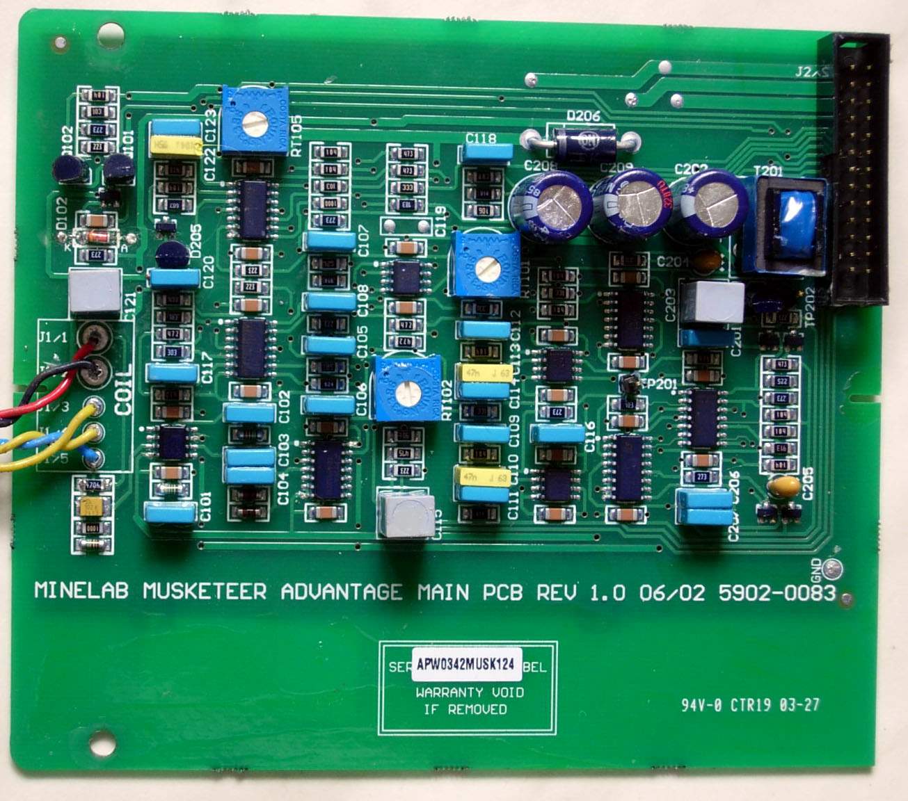

      But it would be very interesting we to analyze Musketeer's audio, cose on skim look, those 2 audios looks exactly the same. Yet Musketeer do have speaker and volume control and RH dont???
      I had both RH and Musketeer, but at the time, i was not interested to open box and examine details....how lazy i was!? Damn!? Now i do have regrets!!
      Now i am trying to spot something interesting on photos i have...yet without success...photos are low resolution, low quality, and it is not possiblle to use them and see some details arround audio at Musketeer...sheeeshh!

        Ivconic , Somewhere posted on Geotech , are very sharp Musketeer photos , I am searching again , and I will re-post the photos if I am lucky and find them !!........Regards....Eugene / Stalni-clan / Junior Member
        • Yes you are right! I remember saw those somewhere....but where??
          Might be we pull out some benefits from those?
          • RELIC HAWK
            MR. IVCONIC , This might help ?? I will keep looking for the other side . This one today is not too bad and its from Forum member GTK , ...........I will keep looking........Regards....Eugene / Junior Member / Stalni-Clan of Hobi-Detektori

                  • Eugene that is the one. Yet i can not see audio wirements proprerly....all the components seems same asa on RH..
                    Anyway thank you!
