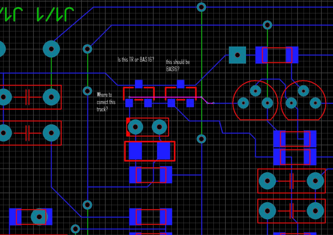

    No,no...this is totally wrong,mismatched.
    I am not gonna waste my time and nervs on this trash. Schematic is full of mistakes so logically pcb too. Also pcb is not good drawn at all.
    5kg hammer will do the job in a minute!
    I dont understand:
    -at first you got 45cm , now it´s no good
    -PCb have Ground plane, but you didn´t make it, now you sayt it´s bad design
    -we checked errors, and corrected the ones we found (specially Max), now it´s full of them...
    If you don´t like the diagram for political reasons, fine, but if it´s tecnhical i´m sure that can easily be improved.
      I dont understand:
      Fred...!?!?!? What political reasons??? I am apolitical totally, i dont even know you and your origin. Or maybe you think i reffered to Minelab....Australia...it is on the top of my favorite list! What political reasons ...dear Fred!?!?
      You did excellent pcb draw according to schematic, but schematic lack...now i am sure. It is not your fault, you used incomplete schematic...that is all. I am not acusing you or anybody else here for nothing.
      Yes i had 45cm and more on 1e coin but with huge instabillity, uselles on soil. Now i have doubts that it was not real detection at all but some wild reaction in the air...?! Not sure at all?
      Also i have in mind original RH pcb and serie of measurements and tests me and my friend done recently - totally oposite behavior than this one.
      This one is not promissing at all.
      Than ..capacitors..omitted from pcb, not good - bad very bad. It is not "work" to do like that - to add capacitors after..very bad and sloppy job.
      So...we need another, new pcb with caps included.
      But what if we draw another again according to inaccurate schematic?
      I spent some time on "Coinseeker"...now on this...no results.
      So...that was my point....not some "political" (God oh no!) reasons or whatever else...!!?!?
      Fred best regards, man! Take it easy!

              Hello Max , I believe you had the Relic Hawk circuit board 95 to 100% correct !!! If there was an error it was something to do with transistor "types" and or the part numbers in regards to the TX oscillator section . I believe you just made a very minute 1% error with the search coil . MAX , I classify you here on this Geotech Forum as an electronics engineer / Design Engineer / Electronics Technician , all 3 , so you are in an elite Group with Geo, Ivconic , Fred , Carl , KingJL , KT315 , Aft72005 , and and maybe a dozen other Top notch Techs here , "Please anyone do not be upset if I do not mention your name here , too many to name to type "!!!!! Again , hundreds of top-notch techs are on this Geotech Forum from around the world !!!!!!!. Max , I have no-doubt in my mind that the Relic Hawk will be completed with your help . Me , I am just a repair Tech that can repair anything electronic , that is put in front of me , how I do it amazes even me !!!!! As for design work , I am not quite ready , but learning here everyday . As for Metal detecting in the field , I have a lot of experience since the mid 1970's ,even a lot of deep digging and in the worst possible "hard pan" dirt and clay ........This Geotech Forum is all about Team work and "every member" here I respect and appreciate. I hope this Geotech Forum is here for years to come . Max , as soon as you complete and conquer your personal issue , we all want you back here to complete and conquer the Relic Hawk Challenge , and all other Geotech Forum Electronic Projects / Headaches/Mysteries !!!!......Regards.....Eugene 52/ Formerly amtech2005 / Stalni-Clan member of Ivconics Hobi-Detektori site

                            • Hi,
                              I havent seen Max for a while.
                              And no progress here!
                              Maybe he have some problems.
                              Fred did you finish your PCB?
                              Ivconic,
                              How are you?
                              You have desoldered this one so please tell me where this track goes?Up or down?
                              Also are this both BAS16.
                              Thanks.
                              p.s.only few spots misssing now.I hope get them soon.
                              Help highly uprishiated.Mistery will be solved finaly!
                              • As i recall those two are diodes. Dont take my words 100% true.
