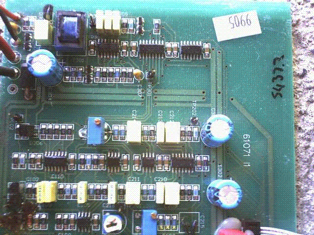

    RELIC HAWK
    DOES ANYONE KNOW THE EXACT PART NUMBER OR ANY RESISTIVE MEASUREMENTS ON THE BLUE TRANSFORMER SHOWN . SCHEMATIC SHOWS A CENTER TAP CONNECTED TO NOTHING. AND I ALSO DO NOT SEE A SECONDARY WINDING ON THE SCHEMATIC???SO IS THE PRIMARY WINDING USED AS A CHOKE OR LC FILTER ???? THANKS...................... EUGENE
    • #62
      15mH (L) parallel to 1uF (C)
      Regards!
      • #63
        with 15mH there you have LC resonant frequency at about 41Khz... then you have two antiparallel diodes (for limiting voltage in the interval 0.7..-0.7 and also some resistor function seem quite clear to see I think: it's filter stage that will provide supply to audio tranducer (phones ...) without intermittent propagation of too spurious frequencies on supply rail... this will improve stability of amplifiers chain vs audio stage impact.

          RELIC HAWK
          THANK-YOU, IVCONIC , MAX FOR THE FAST ANSWER. I AM MAKING A PART'S LIST . AND I ALSO WANT TO MAKE A THROUGH-HOLE PCB BOARD . I DO NOT WANT SURFACE MOUNT BECAUSE OF MY BAD EYE SIGHTBUT IF THERE ARE NOISE PROBLEMS OR OSCILLATIONS I MAY HAVE NO CHOICE. I STILL HAVE A LOT OF WORK TO DO ON THIS BECAUSE I AM JUST GETTING STARTED !!!!!!!!!!. I WILL POST MY PART'S LIST FOR EVERYONE TO DOUBLE CHECK. THANKS AGAIN...........EUGENE

                        RELIC HAWK
                        WHEN I WORKED ON BROADBAND AMPLIFIERS FOR CABLE TV , NO ONE TAUGHT ME HOW TO WORK ON SURFACE MOUNT PROCEDURES AND I HATED IT.WHEN I FIRST GOT STARTED I USE TO BREAK SMT'S WITH TWEASERS, ALSO OVERHEATED THE SMT DEVICES AND THE FOIL ON THE BOARD.IT TOOK ME TIME LEARNING THE HARDWAY AS USUAL. BUT ANYWAY I THINK THE NUMBER ONE PURPOSE OF SMT IS SAVING SPACE AND ALSO IT HAS LESS STRAY CAPACITANCE AND STRAY INDUCTANCE PROBLEMS. NOISE PROBLEMS HAUNTS US ALL , IF YOU COPY A PERFECT WORKING PCB CIRCUIT BOARD "THE PART LOCATION'S "MUST BE IDENTICAL" TO THE ORIGINAL PART'S LOCATION OR YOU WILL HAVE EXTRA PROBLEMS THAT YOU DON'T NEED!!! LIKE THE ORIGINAL GOLDEN SABRE HAS GREAT DISCRIMINATION AND IT'S DEPTH IS VERY GOOD. AND IF THE NEW CIRCUIT BOARD'S BEING MADE ARE IDENTICAL TO THE ORIGINAL GOLDEN SABRE PCB BOARDS THEN THE NOISE PROBLEM IS A FAULTY COMPONENT OR COMPONENT VALUE OR THE SEARCH-COIL IS NOT RIGHT. THANK-YOU MAX , IVCONIC, GEO, AZIZ,CARL, TINKERER, THE WIZARD, AND EVERYONE FOR HELPING TO MAKE GEOTECH FORUM AND HOBI-DETEKTORI FORUM SO GREAT!!!!!!!!!!!!..............TAKE CARE ALL.......................EUGENE
