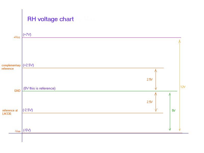

            Uhm... let make it clear, if we can.
            The U5b it's a not-inverting op-amp there.... so... let consider negative reference the -5v and we see the reference is at -2.5 (so 2.5v up the -5v).
            Now look at the gain of a non inverting op amp: gain is = 1+Rx/Ry... in our case 1+(100k/100k) = 2
            Then if we put +2.5v (think respect the -5V, absolute negative voltage there) you get vout = +2.5*2 = +5V
            In other words the vout of U5b is exactly +5V above the absolute negative voltage (-5v , aka -Vee).
            Now... that's actually the GND level in the circuit, that's cause we indicate that for gnd and the two opposite -2.5V and +2.5V respect to that GND, used for e.g. references in trimpot section.
            Why that ? Simple... RH needs that, needs a floating GND level with two simm up and down voltages, very stable (lm336 is temperature compensated) probably cause it's required for correct alignment by trimpots: remember that whole gain of chain if fairly high there in RH, so voltages must be VERY stable respect e.g. to thermal variations.
            Now... you probably were misleaded by all that voltages... you suppose there were 2.5v drop at R28 with big waste of power....+62mW... resistor will be hot! actually isn't so hot, though the resistor is there for a reason.
            The reason have to do (probably) with impedance required. You know ... at gain=2 the op amp has very low closed-loop apparent output impedance (that's a good case for us in general) but what about that ?
            The current the op amp must provide to the rest of circuit is a factor, the noise propagation is another factor and so on: the resistor is there cause THEY WANNA MAKE an higher impedance separation between the op amp output stage and GND rail.
            Why that so ? I think good explaination is about noise propagation : at some frequencies the noise can play a role in op amp gain variations , with potential effects on stability. Think about e.g. some digital noise that will enter inductively the GND tracks... it will be picked-up by op-amp closed loop too and will affect stage gain a bit (small variations but relevant if md whole gain is high such in RH). A solution I saw in e.g. audio hi-fi amplifiers is separate output of op amps from next loads by increasing impedance between stages : that keep noise back propagation harder and let amplifier chains gains be fairly stable vs noise, also at higher gains.
            So the answer is maybe a single word.... stability.

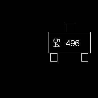

              Now I have some "idea" about that TR.Could it be this?

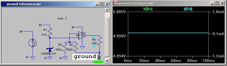

                  • ground reference
                    Yes, the circuit is ugly but that does not mean that it will not work.
                    Now I've got it. My test setup was faulty and I was acting like a dog chasing his tail.
                    One bad thing about spice is that it is hard to simulate circuits that generate ground because spice likes for ground to be the starting point, not an end. And, if it's ground then it's always going to be zero volts. (duh) You can't measure it, it's just THERE. Believe it. It's true.
                    Here I have hopefully corrected my error. It would take a lengthy explanation or else a picture. I'll draw a picture because I don't feel smart enough to make a lengthy explanation.
                    Here I have called battery(-) "ground" and ground is "0V". LTspice will not allow me to draw the circuit as it is would be in real-life, but I must transpose. In my picture we can see that if you have a 10V battery, the "0V" will be almost exactly half-way between B+ and B-. V+ and V- would get out of symmetry when the battery voltage is NOT 10V, so I don't understand why Minelab would do this. But, if it works, who cares?
                    Whew, I hate these crazy power supplies, but so what? Max, I thought your drawing was wrong but it was me that was wrong. Sorry.

                              RH use 12V seled lead-acid battery.Max have excplained all.Just read.This diode that we tweeked at TX stage have to be 3V3.All there excpained.
                              Now when I switched on this PCB refuce to work like when I worked early.
                              Need time and then start oscilate.
                              I will recheck all.
                              Can you fins similar TR like this that I showed.Can this be the mistery SMD TX?
