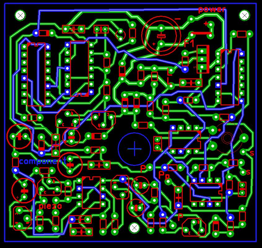

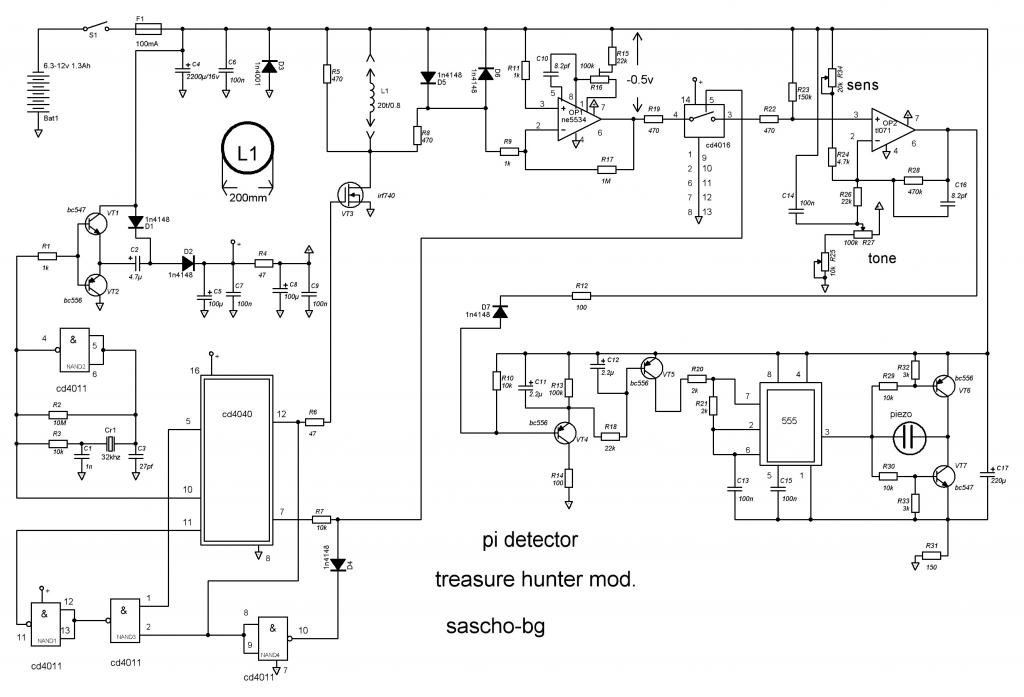

It seems to be a good and simple detector. Only "problem" that it is a single sample detector. But if there are not electrical lines near then it will be a fine detector(small bettery, good gain and why not a very light detector)
