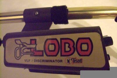

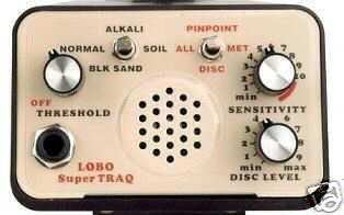

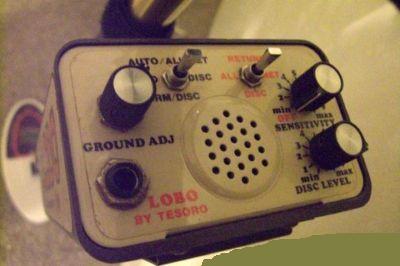

        I'm looking for a photo of front panel, lobo classic not supertrack!
        I need better understand the function of all swichs.
        Bye Maxbiri
          Lobo improoved
          Hello again , Maxbiri. I looked at the last pdf schematic you posted again . Two things I noticed , 1. What is the capacitor network of "8 Caps" doing in the upper left of the schematic ? Are they for all the I.C.s ?? and 2. Did you complete all the power supply voltage connection's ? I will look at your schematic again tonight. This is a Great detector and I will try to find some close-up photo's of the original Lobo but it won't be easy !!!.....Good work you have done so far !!!! Also a week ago or so I read from another member's post about the LS204 chip , Are they almost obsolete/discontinued ??...Does the LS204 have a lot of noise ?? Maybe you should search for a better replacment ?? ...........Thanks..........Eugene
            lobo improoved
            Maxbiri , the older the metal detector the harder it is to find a decent photo !!! Remember the "Original Lobo" was 20 khz. The new Lobo ST is around 17.5 khz......You can see the difference in the switches and the potetiometer to the left ...This should help a little....take care....Eugene

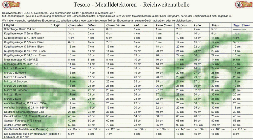

                  Hey guys look at this, Lobo is high rated!
                    you must consider that Lobo have standard coil 10'' DD... so the gain in depth is partially due to coil employed respect to e.g. eldorado.
                    Sure is a good one by tesoro... but coil is important too in such considerations.
                    I mean they are all similar about e.g. TX stage, power... and components employed so the depth is about the same for same coil type and dimensions... I think TGS has exactly same power of Lobo, but cause Tesoro sold it for other purposes (nugget hunting mainly) it was discredited as low depth capable... though there isn't really... just you need proper coil for it.
                    Just my 5cents
                    Kind regards,
                    Max
                      I Max
                      I'm agree with you about standard lobo's coil, so may be that the test is a little falsed.
                      More or less all tesoro schematic are similar but i think that lobo is a little different.
                      Tx stage is forced by 555 and not a pure LC oscillator as in silver, eldorado ecc ecc.
                      The tx stage is equal at diablo or similar at fisher 1280-1266 ecc ecc.
                      tx F is 20 khz and not around 10 khz as other tesoro's device.
                      Filter stage look as all other tesoro design with little difference.
                      I like thery much eldorado and it's discrinating power and power line immunity.
                      From lobo i aspect same power as eldorado but a better sensibilty to small target.
                      On eldorado i have about 30 cm for 1 euro coin in air and disc mode.
                      Bye Maxbiri
