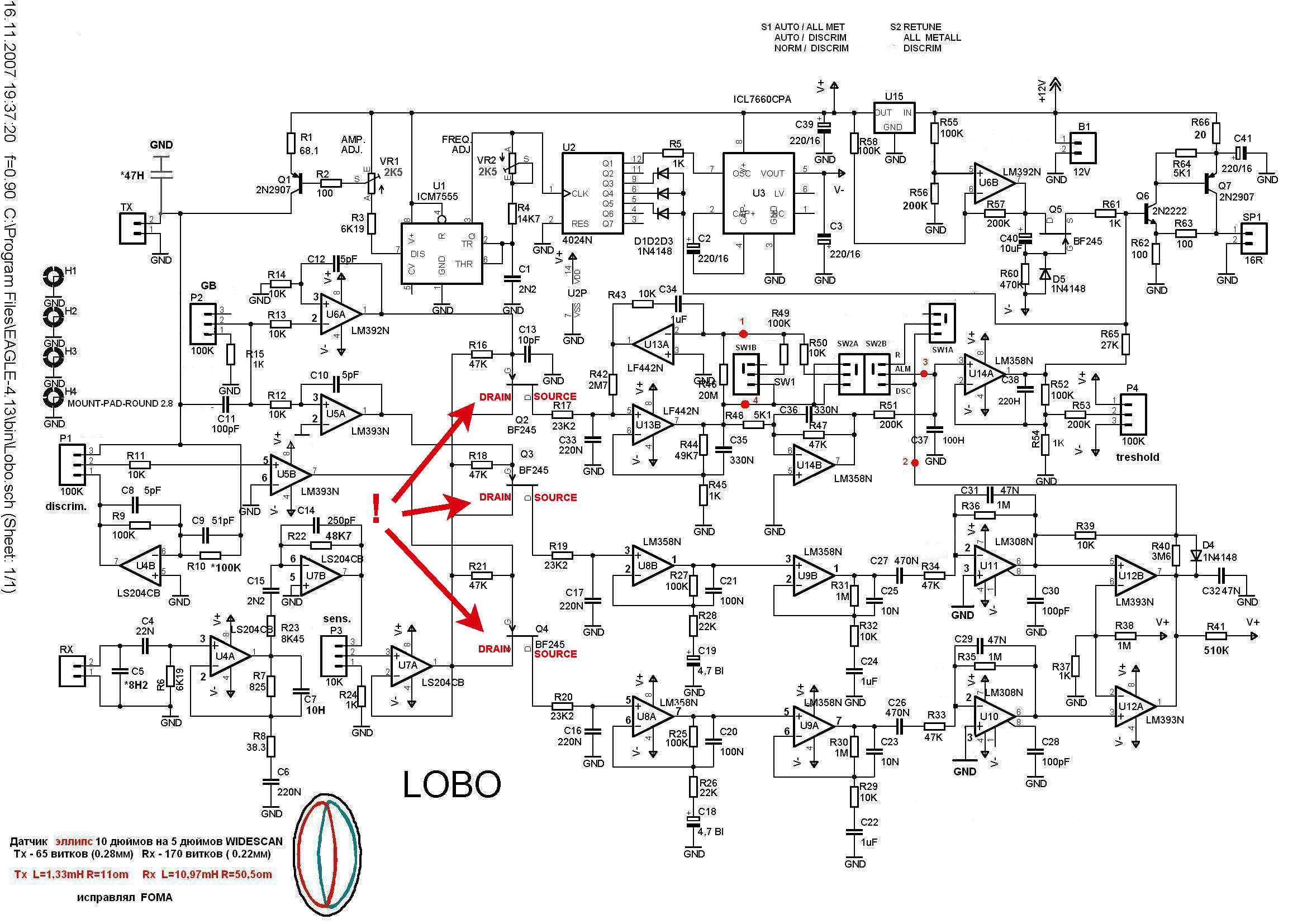

              How to calculate capacitors RX TX for coil parameter up my post?
              What is type of mosfet in original pcb lobo?
              • there may be a mistake in schematic. jude me it is principally or not. Click image for larger version
Name:	LOBO 3 done by Foma_fixed.jpg
