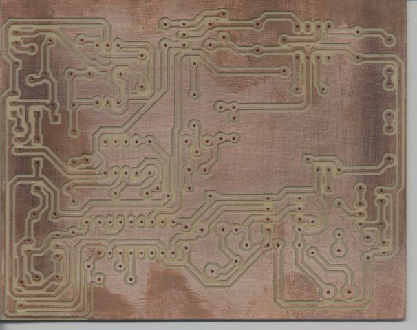

        Here is a photo of milling pcb.

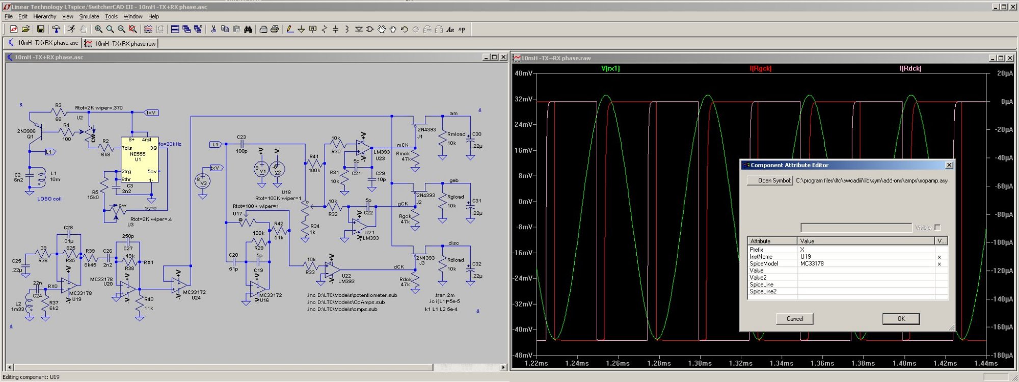

                          I try a simulation on input stage of lobo, the 2 ls204 form a passband centered on 13.45 khz and not 20!!!!!!!!!!! the gain at 20 khz is about 36.
                          Not very nice, i will shift a little the passband centering around 20 khz.

                            I do not have simulation models and symbols for LS204. I use the MC33178 model because I think that
                            LS204 and MC33178 are reasonably close substitutes for each other.
                            Linear Technology does NOT manufacture a close substitute for MC33178, and this "third party" model require some extra effort to get working.
                            LTspice was originally crated to demonstrate LTC switching regulators so third party models are added extras that must be kludged in.
                            By using the XOPAMP.asy symbol and editing its attributes (see the attached screenshot),
                            many different opamp and the LM393 comparator can be simulated. ST products (TS922 for instance) use a different
                            virtual pinout, and the xopamp.asy symbol must be modified to conform to this oddity... the device pins are ordered in a different sequence.
                            I will not go into detail... they're a pain in the neck.
                            The phase response of the receiver section is just as or maybe even MORE important than circuit gain. The LOBO receiver amplifier components
                            determine a particular phase relationship to the TX phase reference.
                            RX gain is only part of the problem - receiver phase is also VERY important. Receiver section components impart gain but they also cause
                            the necessary phase change to rotate the received signal in relation
                            to the TX signal so that the ground cancelling (GCX) and discriminate (DISC) pots work correctly!!!
                            MC33178 and LS204 opamps exhibit a slightly higher dynamic range than most garden
                            variety low noise & low power opamps. (Output voltage swing is better). MC33178 is superior in this respect.
                            Otherwise, we could simply use an LT1007 model (included with LTspice),
                            for instance... or LT1784 might be useful... but, these are NOT suitable substitutes, only tools for simplification
                            should it be necessary.
                            Look at my posts in "Full m/lab SD2000 schematics" - there is more information, and also some CD4000 series models and symbols.
                            https://www.geotech1.com/thuntings/s...t=14001&page=6
                            Most (but not all) of the opamp models in the opamp.sub file can be used with the xopamp.asy symbol. Xopamp+.asy is different only
                            because the "+" input is on top.
                            I know I haven't told you everything, but it's been a long day. so I'm wrapping this up. Oh yeah, notice that I have grounded the
                            JFET gate resistors, otherwise there would be no pull-up in this incomplete circuit.

                              I forgot to include the actual simulation file.
                                Hi Porkluvr
                                Very interesting stuf!
                                You are perfectly right phase is more important respect simple gain but as i said i'm not skill with pspice, i need more time for remember how set spice for phase schift.
                                I notice what i think is a error, not sure, but i think that 1.3 mH must be tx coil and 10 mH the rx coil.
                                I'm working using a about 1.3 mH tx, maybe this is the problem i have around distorsion in tx stage?
