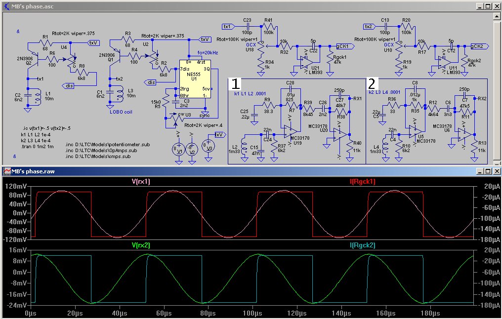

              I think that the LOBO RX section is NOT a tuned circuit. I want to repeat one of my previous statements: phase response is a critical issue,
              as is circuit gain. The receive circuit components are selected to rotate the phase so that GCX and DISC work correctly.
              So, although there is a higher amplitude signal with a 47nF RX tank capacitor, it throws the RX signal completely out of whack
              in relation to the TX phase reference.
              You don't say which version of PS you use, but LTspice is FREE, and there is
              no restriction on the number of components that you can use.
              My screen shot shows your circuit (1), and the original (2). (Actually, I have modified the original circuit in #2.
              There is more gain, but my modification gives almost exactly the same phase response as the original circuit
              and uses components that I have on hand. More gain, but same phase response... the MC33178 @5MhZ GBW
              should be able to handle it. Circuit #2 is how I will go.)
              I used .0001 as coefficent of coupling between the TX and RX coils. This might represent NO target, but a small
              residual backround signal - such as a slightly imperfect null or maybe a nuetral ground return.... ummh?
              This "k" selection is only a guess, but:
              Notice the wide variation in phase response between the two circuits. The GCX pot is set at 100% in both circuits
              and (besides my modification that maintains the same phase response) the only difference is the additional 47nF
              tank capacitor in circuit #1. (Not shown, there is series 51r and 11r in the TX and RX coils.)
                Hi Porkluvr
                You are perfectly right, phase is more important respect total gain.
                Because i'm not skilled about PS, i asked a friend and he suggested me to put a resistor in serie with generator, only for simulation not in real circuit, and now i have result in good agrement with yours.
                I have a difference about 78 degree with and without 47nf capacitor.
                If i have well understood yours plots you have about 90 degree of difference.
                I think that the better solution is to leave space for capacitor on pcb and after see what happen in "real word".
                The gain of rx stage is about 30 around 20kH.
                I need study Lt spice because seem a very powerfull soft.
                Bye Max

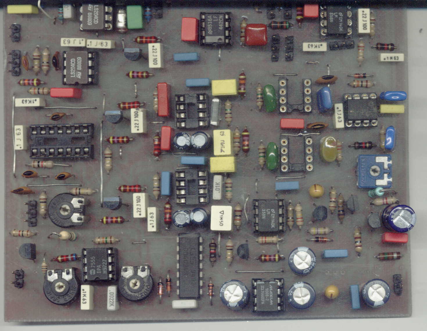

                  Hi all
                  This is the new version for Newlobo, the board is populated about 95%.
                  After testing the tx + power supply i preferred design a single board and not a splitted board.
                  After test if all is ok i will post pcb design.
                  Bye Maxbiri
                    Originally posted by maxbiri View Post
                    Hi all
                    Bye Maxbiri
                    seems good work.
                    Have you made the coil ?
                    Kind regards,
                    Max
                      Hi Max
                      No i havent still built coil, i need copper wire and need found my old template for ellitical coil's shell for cheking exat dimension.
                      It look nice but usually when a board look too nice dont work !
                      When a board look terrible usually work in a beatifull way!
                      I hope this time theory will be not confirmed!
                      All component are recicled, only LS204 are new.
                      I need even change ceramic NP0 with polistirene type, very difficult find value < 500 pf.
                      Bye Maxbiri

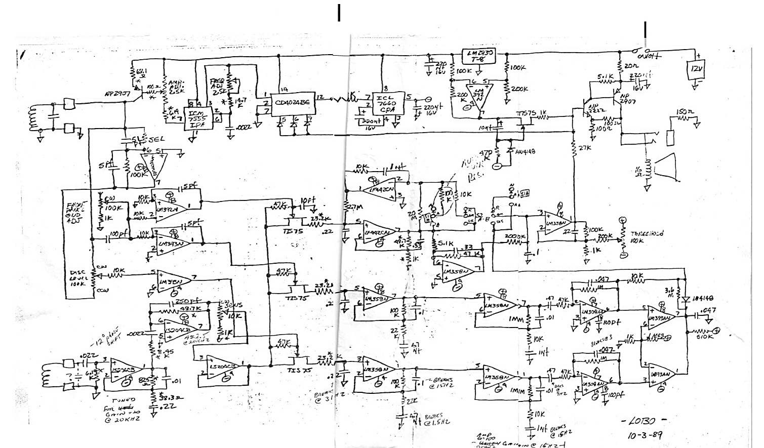

                            Maxbiri , when this project finally gets going , it will become one of the top projects to build on this forum . Here are the Top Projects to build from Geotech , and each are almost ready for that final schematic posting !! And also the "Engineering Members" who highly contributed :
                            1. Tesoro Golden Sabre Light from "Ivconic"
                            2. Tesoro Lobo "1989 VLF version"
                            3. Minelab Relic Hawk from "Max & Fred"
                            4. Hammerhead P.I. latest version from "KingJL"
                            5. Delta Pulse P.I. latest version from "KT315"
                            Regards.............Eugene

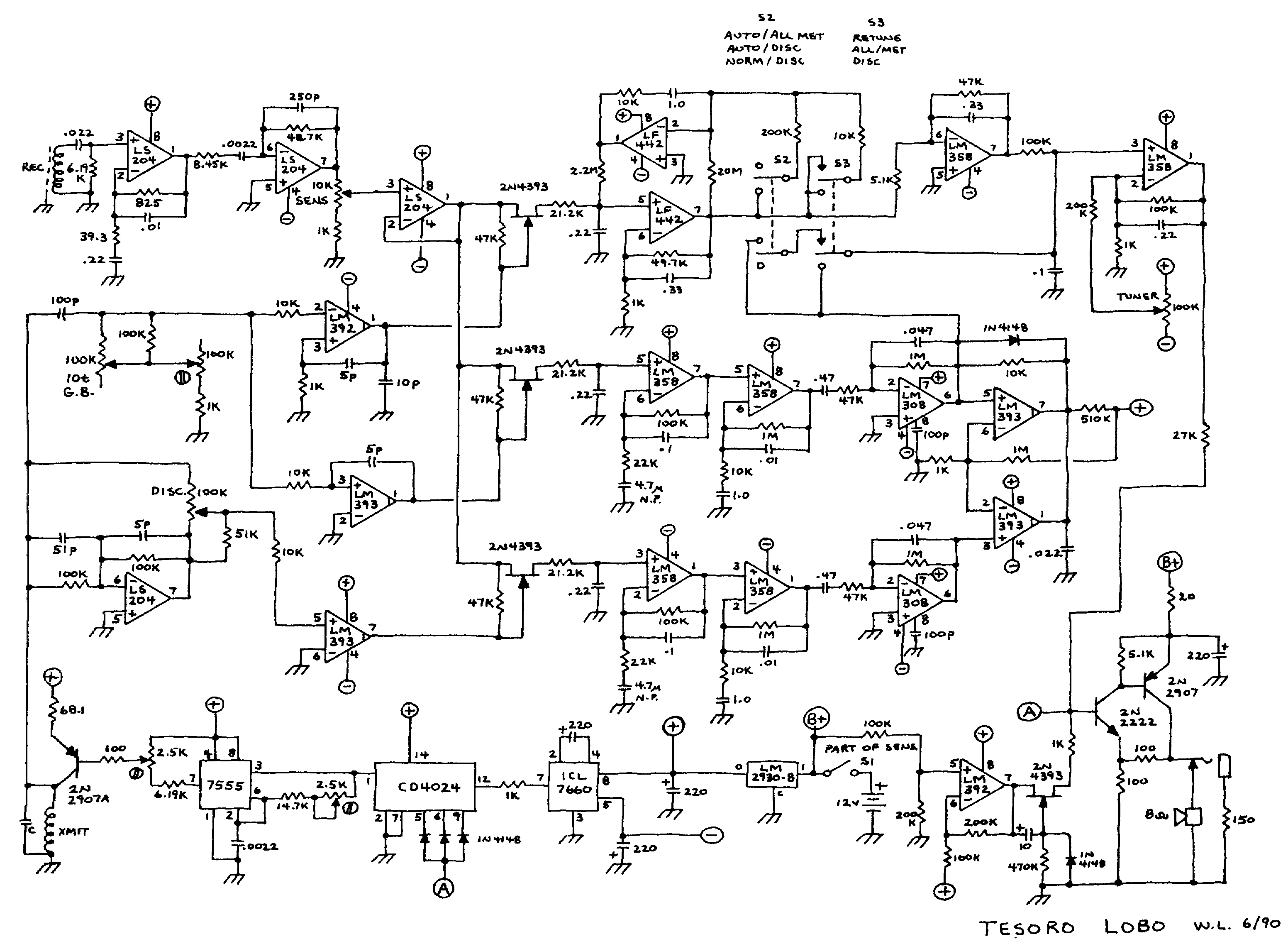

                              • #45
                                lobo improoved
                                Yes Maxbiri , LS204 is the correct opamp to use . W. Lahr did excellent reverse engineering work , Always !!!! He was very correct and accurate . Use his LOBO schematic on your first prototype , then test your new Lobo circuit. And if it works great , make a case for the circuit board , and seal the search coil and put it away !!! And then if you want to improove or modify the lobo circuit design , build a second lobo circuit board for experimenting !!!! And your first Lobo will always be working for test points , and a reference for comparison ..........Regards.........Eugene
