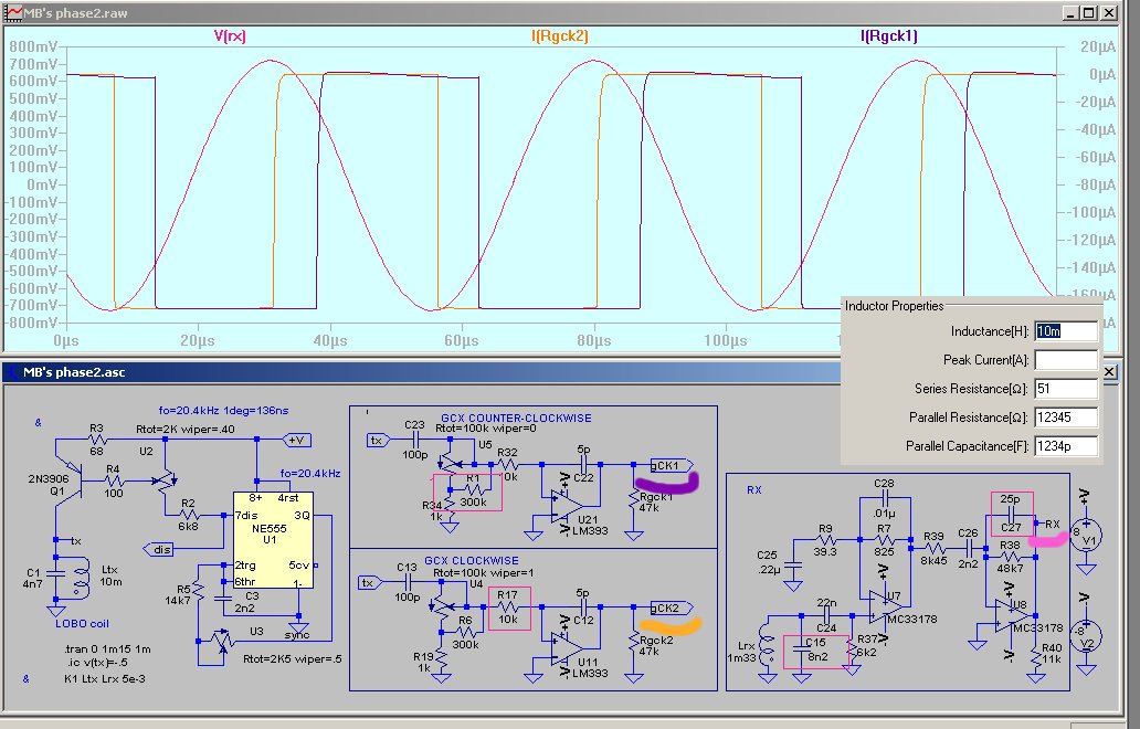

    Maxbiri, I wish I had thought to ask you what frequency you have set.
    I have the freq.pot set at 50% and have tweaked parallel (parasitic) properties of the 10mH coil so that I have a good peak
    using a 4.7nF tank cap. Adjusted drive pot for a -reasonable- combination of amplitude and waveform symmetry.
    TX setup is complete (fo=20.4kHz).
    Here is how I would set the RX phase:
    The russian (?) drawing shows 8.2nF parallel in the receive tank. Give it a try.
    Maybe the cap marked 250pF is actually supposed to be 25pf? I try that.
    According to your schematic, you have placed 100k resistor across the GCX pot. Remove it, or put it from the BOTTOM terminal to the wiper.
    That makes a big difference. 100K gives 35 degrees of adjustment. 300k increases the range to about 48 degrees.
    A whopping 55 degrees of GCX adjustment results from removing the 100k altogether.
    Probably better to use 10k resistor instead of 100k on the LM393 input(s).
    Now, take a look!!! One of the coil's leads may need to be reversed - one day maybe I understand why. Not today.
    The red trace is the RX output. Purple (it looks brown) is GCX ZCD output, knob turned CCW. Orange is GCX ZCD, knob turned CW.
    (I hope CW and CCW are not reversed. I find this all very confusing.)
    I think this is pretty close to what is supposed to happen, except that I would delay rx signal maybe 3 more degrees?? Changing the 25pF to 33pF
    would take care of that. Maybe it's not necessary, but would assure that received signal of neutral soil is within range of GCX CW adjustment?
    Putting a 250pf capacitor across the 48k7 resistor shifts the rx signal about 45 degrees to the right. I think that would ruin your GCX channel's response.
    I thought I had this thing figured out before? Um,hmmm. That shows how easily I can fool myself. If this setup is wrong, I hope
    somebody will explain why. I have no scope to check this stuff in real world.
    I might have the CW to-the-left and CCW to-the-right movement mixed up, I dunno.
    Heck, this whole thing might be wrong, but it looks good from where I see it.

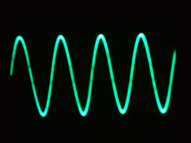

                  • #69

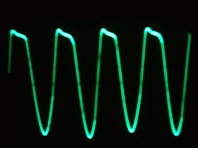

                    Hi all
                    In these days i'm tryng to calibrate oscope and built a simple L-meter for testing coils.
                    I found that 7555 generate a square signal not costant, i put a 100nf capacitor from ground and pin 5 but not solved the problem.
                    Now i post 2 sample photo take from oscope, this is the best i can do, sorry graticula is not visibile.
                    First one is signal on tx coil 10 vPP, good sinusoidal, if i increase power driver on tr base signal began distorted on top side, second photo.
                    Bye Max

                      Distorted signal looks similar to TGS oscillator when the feedback JFet is removed -- But Ivconic says doesn't matter in his tests. Is air depth affected?
                      -SB
                      • #71
                        I need a break from trying to hack Pspice models from OrCAD into LTspice. grrrrr. Usually pretty easy, but tonight the LM385-2.5 / LM385-1.2 are driving me crazy. Foundation work makes me tired. And it seems to be never-ending.
                        Not meaning to step on anyone's toes - but I disagree about signal distortion. Maybe on TGSL it doesn't matter so much, but this is not TGSL. Don't assume anything until you have a product that makes you happy, and then you can start testing fudge factors.
                        The TGSL has no adjustment comparable to the amplitude adjustment on the LOBO, and you don't know how much distortion is acceptable. Power vs discrimination accuracy is what you are trading. You might not gain very much transmitted power compared to the amont of distortion in the phase reference !!! (Looking at Fisher detectors, it seems to me that they take phase reference 50/50 waveforms VERY seriously!)
                        Waveform distortion on the TGSL (using a Colpitts oscillator) cannot be eliminated, but Tesoro DID attempt to minimize it with the FET amplitude stabilizer. And, it is possible that Tesoro's reason for using the LOBO scheme was -total- (well, almost) elimination of a distorted signal going to the ZCD comparators. Just a thought.
                        What really bothers me is your saying that the 7555 output is not uniform. I suggest you try another one, maybe that one is defective? Or, check the RC components first. That seems like serious issue. God forbid it's a problem within your o'scope!

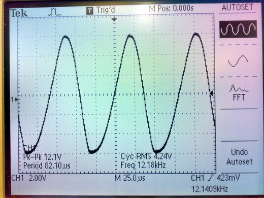

                          Hi maxbiri
                          See pictures, from my golden sabre light , osc out put having distortion ,
                          I did try to better it with some changes in automatic level control section ,
                          Contain Fet and zener diode . anyway, I dident important reaction at tgsl
                          Work.
                          Best regards.

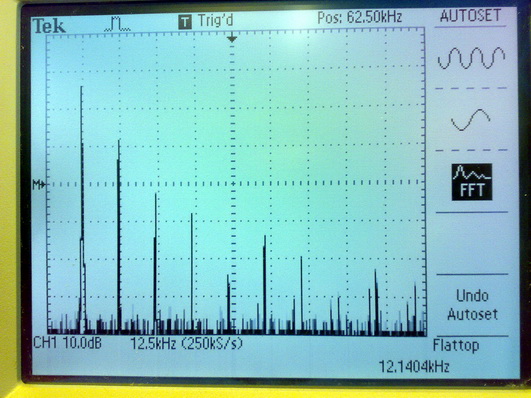

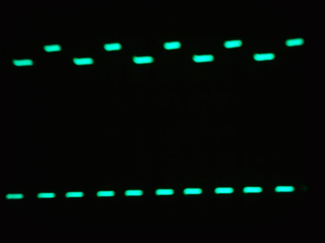

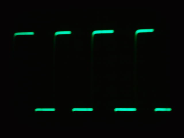

                            Hi All
                            I presume that little distorsions are not important but strong distorsions like that in photo give big problems at comparator output, you havent a sigle square pulse but a little serie of fast square pulse that can afct ground cmpesation and disc.
                            I take same other pictures from o scope, very strange thing happen around 7555!
                            I change all components aruond 7555, and different 555 type, and put a ceramic multilayer 100 nF capacitor on pin 5 and ground.
                            Noise at pin 5 is less than 1 mv.
                            It seem that 20 khz signal is modulate at 10 khz.
                            Tested oscope, it's ok.
                            Thinking that problem coming from 7660, that work at 10 khz half F generate from 7555, i remove it but nothing change!
                            Next step is: remove 4024 and woodo rite!!!
                            first photo is on 7555's pin 3, second on pin 7.
                            Bye max
