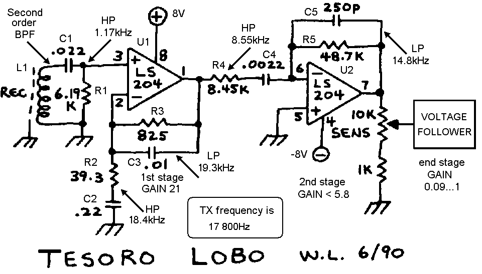

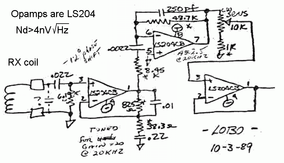

                          • Let we improve the preamp circuit
                            Different designed preamp.
                            Lobo is designed somewhere at end of 80-ties. I think the desiner is not Jack Gifford because the preamp circuit of Lobo differs significant from other primitive preamp circuits used by Tesoro. The differences are:
                            1. The preamp is formed as three stage amplifier. Other Tesoro preamps use only a single stage.
                            2. The resistors of first stage are designed for low noise. The resistors in other Tesoro preamp circuits have much larger resistances, ie they generate more noise.
                            3. RX coil is connected to form second order band pass filter. In other Tesoro circuits, RX coil forms second order low pass filter. That means they can not suppress enough the audio frequency (330 - 550Hz) and
                            third harmonic of mains frequency (150 or 180Hz).
                            However:
                            1. Despite its three stages, the preamp operates with low gain. I see something is written for gain in the circuit diagram attached below.
                            2. Resistors and RX coil have low resistances, but this is useless because opamp generates spectral noise density more than 1kohm resistor. That means the designer can decrease the weight and price of RX coil without increasing input noise..
                            3. The tuned circuit (band pass filter) is damped with 6kohm resistor. That means increased noise because a) the damping resistor also generates noise and b) damping forms wide band input (noises are proportional to bandwidth)
                            Let we make analysis, revision and redesign of this circuit.
                            • If the coil allows it, I'd go for a true differential input, and leave filtering to the subsequent opamps. True differential setup has a moderate input impedance that is symmetrically distributed between each input and a ground. The only problem with this design is that resistors values are not easy to pick. However, I calculated values for 6k8 total input impedance that has amplification 48.5 and uses only E6 values. These are 6k8, 330k, 68ohm, 3k3. I use this setup in my IGSL.
                              • REVISION AND REDESIGN OF PREAMP
                                Calculation of cutoff frequencies.
                                Every RC timeconstant forms a cutoff frequency fc at which the phase is shifted with 45 deg and magnitude is changed with -3dB. The formula for calculation of cutoff frequency is fc=0.16/(RC). Below are shown the results from calculation.
                                C1 and R1 form a high pass filter with Fc=1.17kHz. That means it will suppress significant a) the audio frequency and
                                b) the third harmonic of mains frequency. Both frequencies are additional suppressed because R1 and C1 form with L1 a second order bandpass filter.
                                Timeconstant R2*C2 is not correct calculated because this is high pass filter and TX frequency appears below its cutoff frequency.
                                Timeconstant R5*C5 is also incorrect because this is low pass filter and TX frequency appears above its cutoff frequency. That means the gain of second stage is below G=R5/R4=48.7/8.45=5.8.
                                The total gain of the whole preamp is less than 21*5.8=122 or <42dB.
                                The SPICE analisis will show how the circuit operates.
