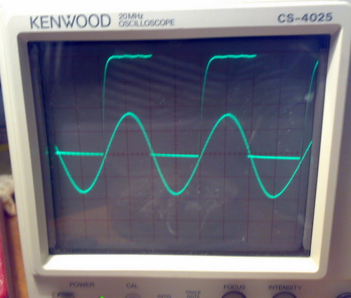

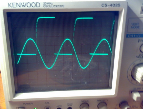

                      • Greetings, ivconic!
                        Good work and correct discrimination F1265 depends on correct adjustment of synchronous detectors. We leave a payment the first (where RX and TX), and the second payment while it is disconnected. Further, we disconnect resistors R220, R222. One channel of an oscillograph is connected to U101/14, and the second channel is connected U202/14 and received:
                        If the picture it is arranged R205 is impossible.
                        If the picture is impossible, is added in RX – 33-39 nF and again arranged R205.
                        If the picture turns out from a negative impulse of the channel of synchronisation we change exits U101/1, U101/14.
                        Similarly we look the second channel – U101/1 and U202/8.
                        After that we put to the place of R220, R222. All! The first payment is finished!!!!
                        Yours faithfully, Michael.
