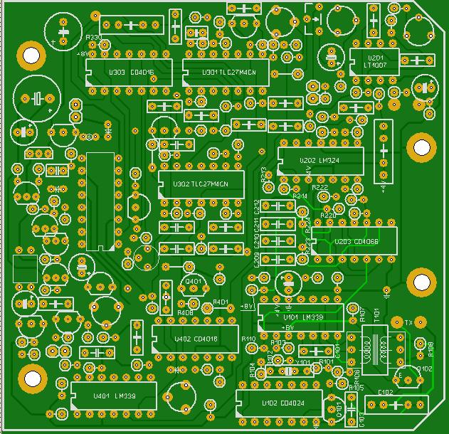

                • There is good quality image from the top side? I can not wire the top side. Too dificult for me.

                  • PCB at work. Needed the top layer correct drawing.
                    not_final_1266x.zip

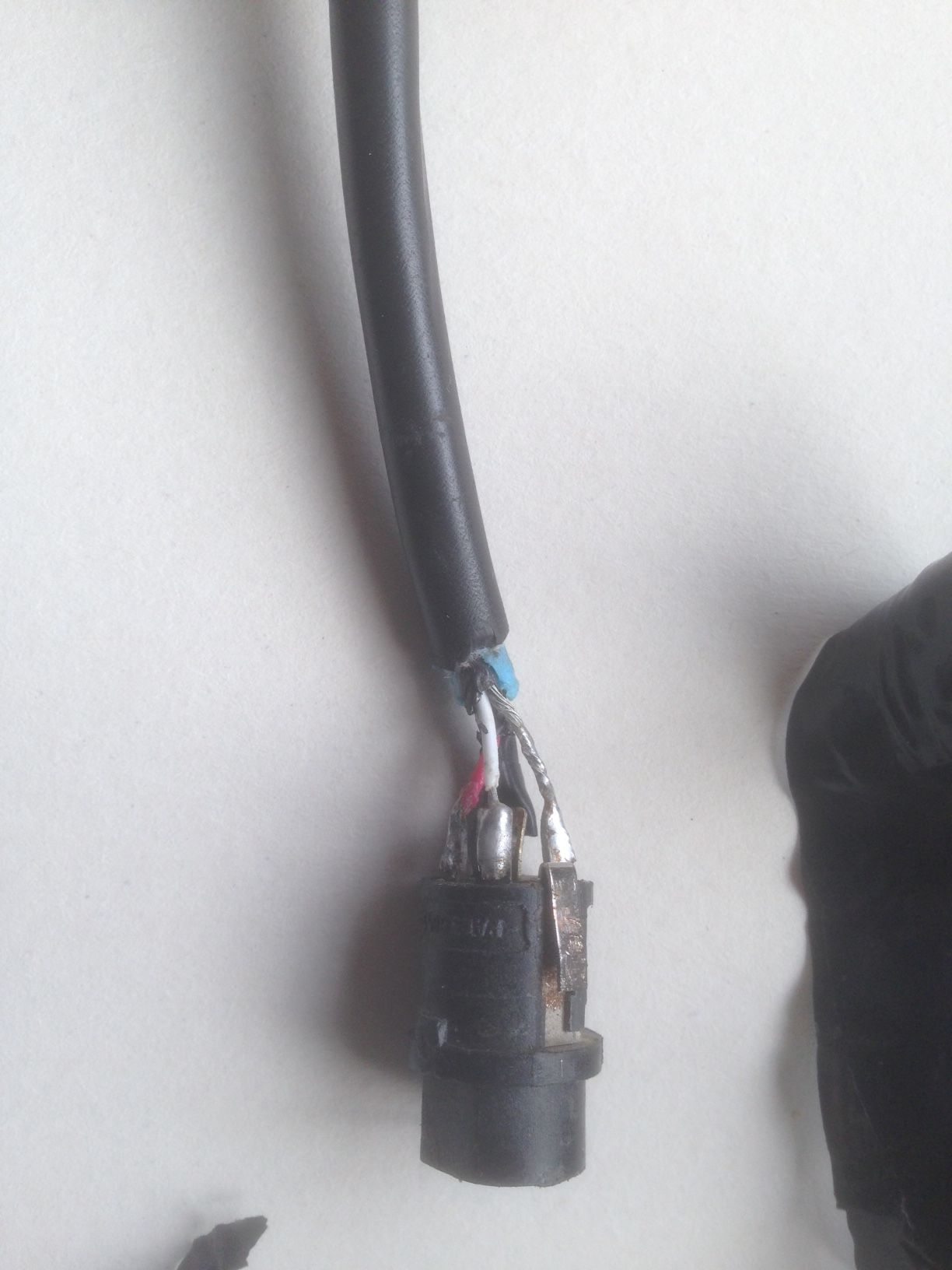

                      can anybody give the specs on a cable fisher used in 1200 series? or pics
                      tia
                      • No numbers on the cable
                        It's two cores that are individually shielded. No outer shield.
                        Just four connections at the connector. Two outer bare shields twisted then wrapped with insulation tape plus the two cores

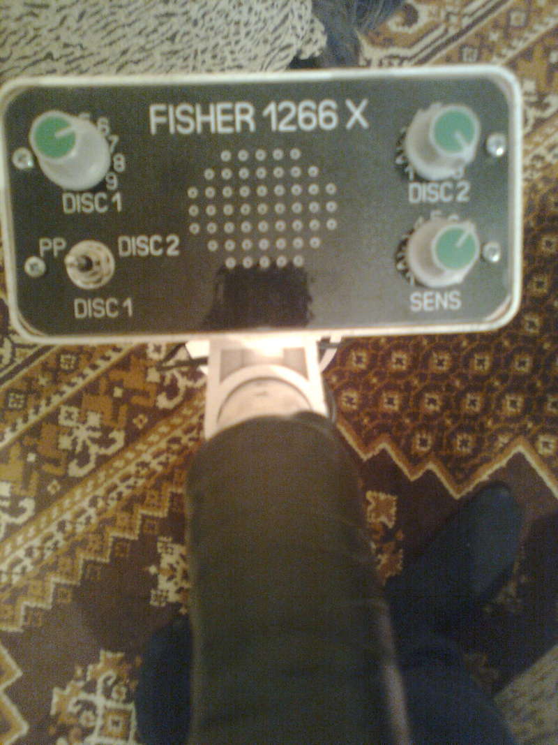

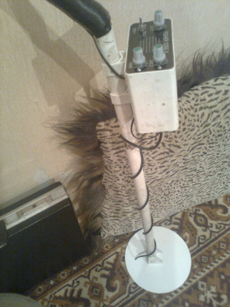

                        • sorry i do not see the pic in details. i ask for vlaser (vlaser is active russian member doing projects).
                          here i give pics of vlaser of his fisher. why he asks me... what that question...
                          this world is duped...

                              Here is a photo of the cable.
