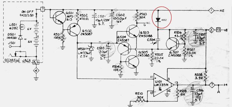

        Just finished 1265. Workable but with certain problems...

        Also i noticed some components differences beetwen this schematic and previous one posted long time ago...
        Instead fet at pow. supply stage i put only one diode (4002) beetwen D and S. All the voltages are proper, just like i measured on original 1265...something arround +6.35V and -3.89V ... so this not suppose to be a problem...
        The role of this rare (at local shops) fet is very simple; when something goes wrong at power lines it simply "close" (disconnect) the power path and prevents some major damage. (Also when battery drains under range).
        So in testing purposes we can use simple diode to provide all the functional voltages.
          Actually, this PMOS (VP0104N3) provides regulation. My 1265 provides +3.92 -3.87. I have substituted a FDV304P with good results. Any PMOS with similar specs should work (watch out for the pins when substituting this as some pins are different sequence). If the source/drain is reversed you will get voltages similar to what you are experiencing also (ask me how I know).

            • #66
              J. L. King
              That's new for me? I measured voltages on one "accurate" device which works well and voltages were in ranges +6.xx and -3.8xx volts...?!
              So...considering this, what you are saying, i start to think that my problems with Disc are maybe tied to inproper voltages? Right?
              For sure i can not find that or simillar fet here in local shops. So i should make quite different supply stage with available components.
              I am asking you now; are the symetrical voltages so important for this design? Cose those are NOT in TGS case at all...Maybe this fooled me?
              If not than i will search for some other cause of problem, but if yes than i will make another supply stage instead.
              I am not quite sure about 1265. I had 2 devices so far but never had any problems working with those, so logically i never performed deatiled measurements and checks. Also had few on service, but almost by the rule i had to replace LM339 and MPSU51 and nothing else (reversed battery poles...ha,ha,ha...quite a "hobby" among local prospectros here!!!)...and damn VPOxxx always survived such piffle with batteries!?
              ... "...These enhancement-mode (normally-off) transistors..."
              "Normally-Off" says....yes you are right, i understood it wrong! Not only that switches but also can regulate voltage....sheeshh!
              But...how the heck device (the other one) works with voltages such far from being symetrical??? Like i told here, i measured pretty close voltages as on my handmade and still device worked correct. Usually i do keep papers with schematics and later added comments on those. So in this case i found out old paper with 1265 schematic and my old remarks and measuring results from that time. At the time i measured voltages and few other points...cleary do remember that device...
              Ok..whatever...i just need to know your opinion on how important is to achieve symetrical supply here..? Thanks in advance!
              • #67
                I can't say with complete confidence. Although, considerig the methodology that the 1265 uses to discriminate, I would be biased toward the balance between +/- to be faily important. It uses a comparison between the resitive motion channel and the discriminate motion channel. The discriminate level potentiometers(s) bias the disc motion channel between the I & Q (they are actually 208 degrees apart) phase detector channels. The output of the Q channel phase detector is a negative voltage that goes more negative and then to slightly positve for maximum signal phase change. The resistive channel goes from 0 to positive back to 0 for maximum signal phase shift. If the +4v & -4v are not somewhat close, you will not be able to adjust the comparison point (which flips the comparitor) to achieve proper discrimination.
                I would vote for important that they be reasonably close.
