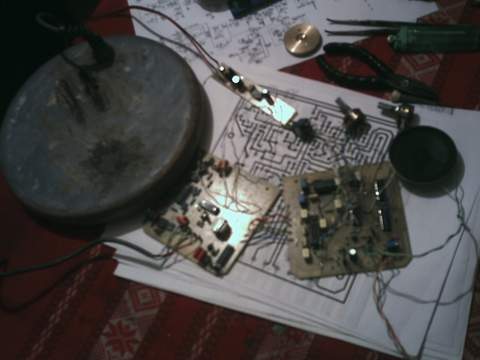

                                No, it is not voltage issue here, at my handmade. I desoldered all the supply parts out from pcb. Than made another on small pcb, providing regulated +4.5 and -4.5 . Handmade is acting the same!? In nonmotion mode it is working excellent (same as original) but in Disc mode detection is weak and phase looks out of range to much. On iron acting like detecting hotrock and no detection or very poor detection on some coloured items. Turning GEB trimmer i can achieve some so so detection on masive colured item with famous Fisher 1265 "bang" in audio, but than it is not detecting other types of coloured metals. For example if it detects masive bronze washer than it is not detecting 2cm coin or Al plate...etc...
                                Back to nonmotion mode it is detecting nicely all the metals!?
                                More and more i am sure that there is some mistake on pcb. Need good concentration and to recheck pcb's again and again. I am kinda "used" to these pcb's so it is hard for me to spot the mistake. Need to take few days rest from it...
                                All other thing seems to be ok, power drain is approx. 40mA, voltages are as noted....in nonmotion mode audio is pretty ok while in Disc mode it is a bit silent..?
                                Huuuh!
                                P.S.
                                Like i assumed; fully simmetrical supply is not needed here. I alredy measured (long time ago) +6.35 and -3.89V on one accurate and good 1265 which worked excellent... So.... kind a returned back to the place where i started!?? Right? Sheeeesh!
