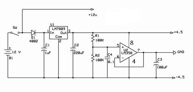

    No, it is not voltage issue here, at my handmade. I desoldered all the supply parts out from pcb. Than made another on small pcb, providing regulated +4.5 and -4.5 . Handmade is acting the same!? In nonmotion mode it is working excellent (same as original) but in Disc mode detection is weak and phase looks out of range to much. On iron acting like detecting hotrock and no detection or very poor detection on some coloured items. Turning GEB trimmer i can achieve some so so detection on masive colured item with famous Fisher 1265 "bang" in audio, but than it is not detecting other types of coloured metals. For example if it detects masive bronze washer than it is not detecting 2cm coin or Al plate...etc...

      Schematic of simple supply i made for this check...

            Yes, like i said; connected and providing +4.5 and -4.5 vots... 1265 drains approx. 40mA...everything cool...nothing bad with supply.
            Considering this...even when i discover the problem..i am thinking to adopt this supply and integrate it in 1265 instead original...cose damn fat is not possible to obtain here in local shops...
