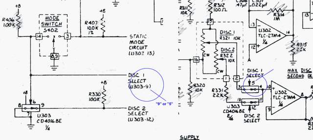

      • Maybe this could be the point of confuse;
        it cleary says "9" but i think must be a "5" ? Right?
        When i draw those pcbs's i connected this with 5. pin not 9.
        Am i right? Or not?
        To connect with pin 9. doesn't make any sense? Right?

          You are right! I will recheck some other areas later on today. I think there were others. They were minor errors if you were troubleshooting a 'factory' board, but could lead to problems if you were creating a board from the schematic.

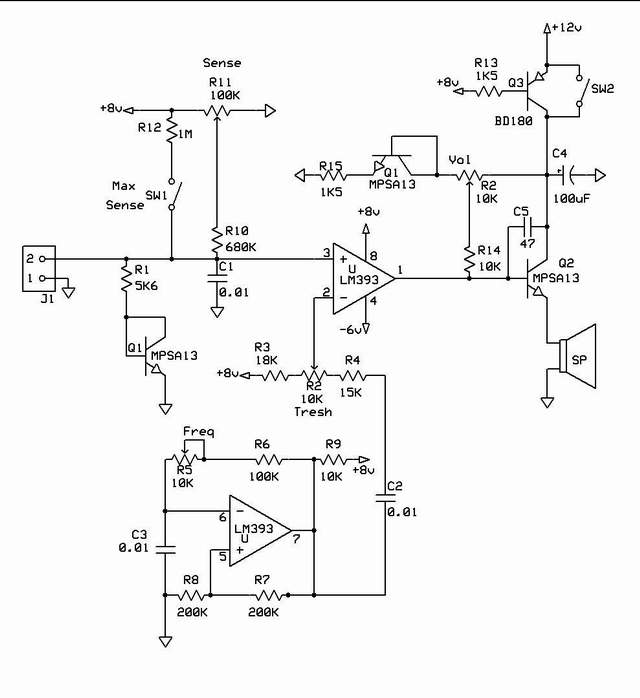

                  I was under the same opinion as you. The first indication that this opinion might be wrong occurred when I happened to obtain (before I obtained my real 1265) the hand drawn schematic (included in my zip in previous post) of the external contols. In studying this hand drawn schematic, I just assummed this to be a major mistake. How could this be, it must be wrong, I assumed. Then i obtained my 1265, and low and behold, it was wired hust as the hand drawn schematic. I don't put a lot of faith in coincidences. It may be just a coincidence and be in fact wrong, but my 1265 works perfectly with great sounding audio.
                  How i know this? Simply, in working modes without MPSU51 we gonna get pretty "smutty" audio without distincive 1265 "bang" at clear detection.
                  But if you involve it in working mode, acting as current limitter it will smooth and limit current to MPSA13 and when incoming signal reach certain level it will release full current and MPSA13 will produce very nice and smooth "BANG" at clear detection.
                  Mine has distinctive bang with clear detection.
                  I realized this just few minutes ago experimenting with it.
                  And i am 100% SURE on this. Please do some experiments and test this, than let me know.
                  Thinking on this , it actually makes sense to use the MPSU51 in the battery check mode. As the battery discharges down to close to 8-9V, the MPSU51 current will decrease and give weaker audio, but with fully charged battery will limit current during battery check and keep from "blowing" ears and speaker.

                    • "...Thinking on this , it actually makes sense to use the MPSU51 in the battery check mode. As the battery discharges down to close to 8-9V, the MPSU51 current will decrease and give weaker audio, but with fully charged battery will limit current during battery check and keep from "blowing" ears and speaker...."
