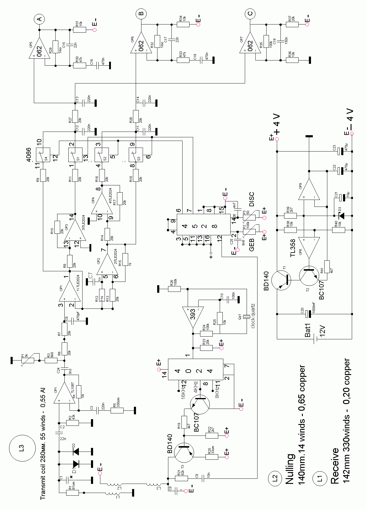

    Hi KT315
    Thanks for original circuit.
    Regards.

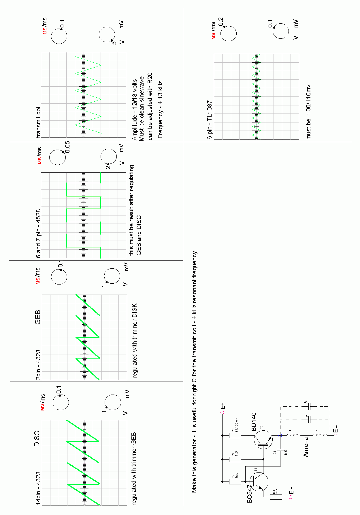

        Also thanks, 1266 waveforms pictures that you upload are new and very useful.
        Regards.

            people, I see your problem that you are really ABSENT out the forum. you are NOT LIVING IN FORUM and it is your VERY HARD PROBLEM!!!
            I repeat ALL INFO ON COIL HAD BEEN IN FORUM! ... and I say nothing new now
            simply get it and enjoy!
            Attached Filesfisher coil.zip

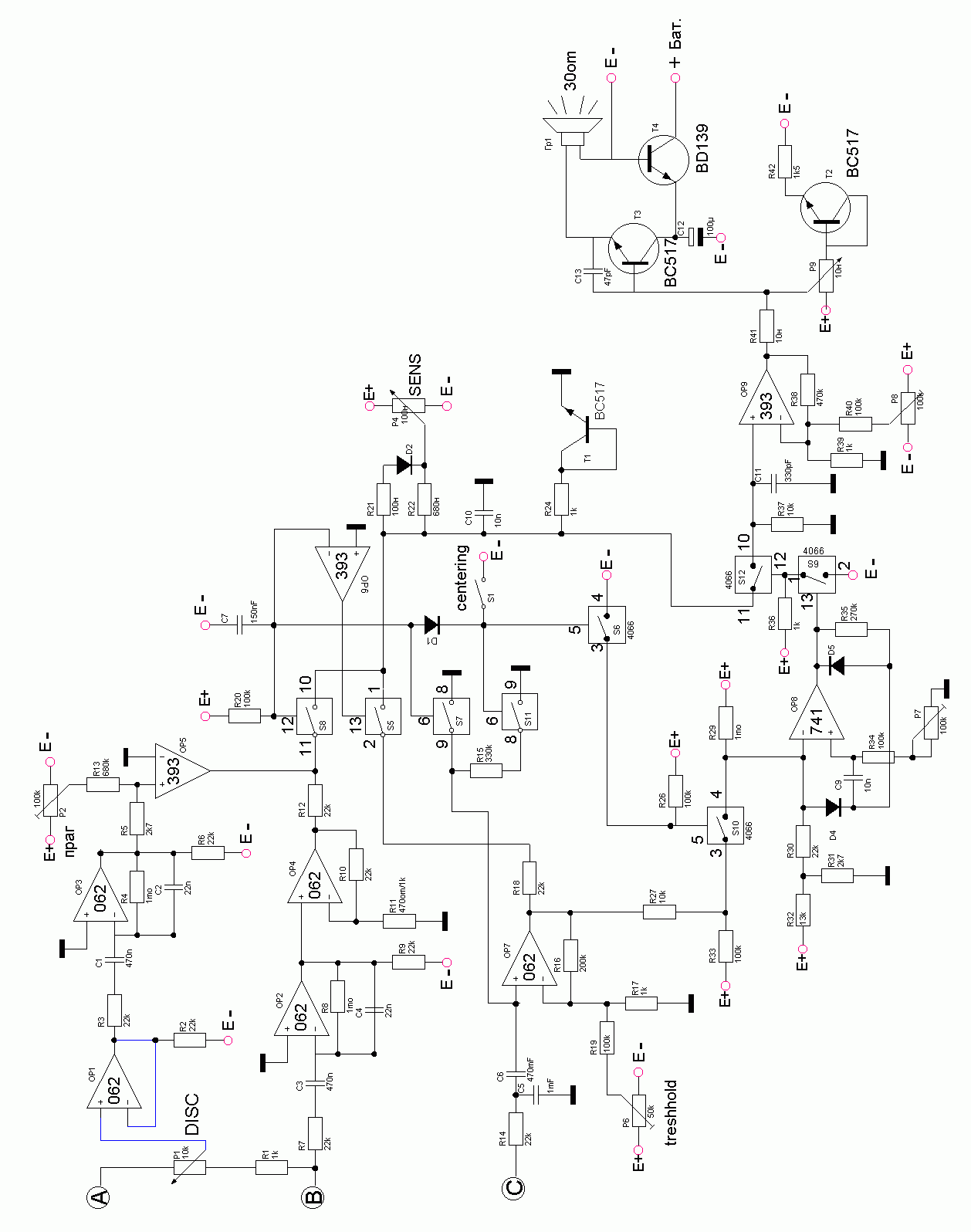

            Hi KT315
            I saw that pages latter, but I don’t remember where I saw them.
            With those pages, was another circuit diagram.
            Are you having them complete? Can you upload it completely?
            Do you know circuit model?
            Regards.

              KT315, I have that somewhere too, originally from the UK repair centre (the OLD one). It's amazing what you can get with a little spare change
              T101 is a STANDARD centre tapped AUDIO output txfr. The sort you find in cheap transistor radios. All you ae loooking for is the 180 degree phase shift.

                  Hi KT315
                  Thank you, yes this is my intention. I had that file completely
                  But I can not found It on my cd’s .
                  Are you know any body built it?
                  Or anybody built it?
                  Best regards.
                    sorry, it's enough on today. this last file I keep of 'a project'.

                        Hi KT315
                        Thanks for all. Yes, some parts of circuit seem as fisher 1266x.
                        Best regards.
                          Hi KT315
                          Please see 1266x clone circuit, on the pot. Wrote “npar”.
                          what in meaning of “npar”?
                          Best regards.
                            Hi KT315
                            Please see
                              seems like Bulgarian but maybe Serbian. I think PRAG means POROG in Russian then it would be THRESHOLD.
                              yours.
                                AKA detektor
                                yours.
