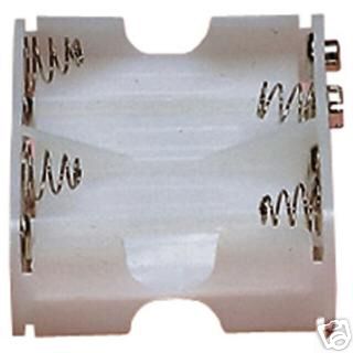

          RED BARON 7
          THERE ARE SO MANY RED BARONS 3-5 AND 7 WITH THE SAME PROBLEM NOT WORKING AND IS MAINLY THE BATTERY PACKS.THEY ARE SO TIGHT AND SMALL MADE COMPARED TO THE SAME PACK BUT SLIGHTLY BIGGER BETTER MADE BUT THEY DON'T FIT IN THE CONTROL BOX HOLE WHERE THE BATTERY PACKS GO INTO.THE START OF THE PROBLEM IS NUMBER ONE THEY CRACK BREAK ON THE THING WALLS EDGES OR SPRINGS RUST OR BREAK.OWNERS THEN LOOK FOR THEM MAYBE FIND ONE BUT DOES NOT FIT AND GIVE UP ON IT.NEXT PERSON OR OWNER LOOKS AT IT AND THINKS I CAN PUT TWO NINE VOLT BATTERIES HENCE THE SNAP ON CLIPS WORK ON THEM.BUT DON'T REALIZE THAT BY LOWERING THE VOLTAGE YOU DO MORE HARM SINCE THE IC-LM358 GETS HOT VERY HOT AND UNTIL IT GIVES UP.ALSO THE SNAP ON CLIPS BREAK OR GET BROKEN BY THE WIRING INSIDE AND THAT'S THE PROBLEM I THINK YOU HAD.THEN THEY TRY TO FIGURE OUT WHERE THEY CONNECT AND THE PROBLEM KEEPS ACCUMULATING.BOUNTY HUNTER SHOULD HAVE KEPT LIKE THE 840 VLF/TR MODEL THE POWER SOURCE WITH TWO NINE VOLT BATTERIES.THAT'S WHY WHEN YOU GET TO THE RED BARON-10 THEY ONLY USE ONE 12 VOLT POWER PACK.AND THEY ARE ACTUALLY MORE POWERFUL DETECTING WISE.IT'S A SHAME THAT WITH LIFETIME WARRANTY THAT THEY HAD.THEY PUT SUCH A SYSTEM OF WEAK POWER PACKS AND LOUSY SNAP ON CLIPS.SPECIALLY THE COMPARTMENT SO TIGHT TO PUT SO MANY BATTERIES.THAT'S THE STORY OF THE RED BARON WEAK BATTERY SET UP
          ATTACHMENT PIC IS THE RED BARON AND RED BARON-10 WITH ONE PACK A LOT BETTER BUT STILL TIGHT COMPARTMENT TO PUT THE TRAY INTO AND THE TRAY SOLD ON eBay SOMEWHERE IN ENGLAND.

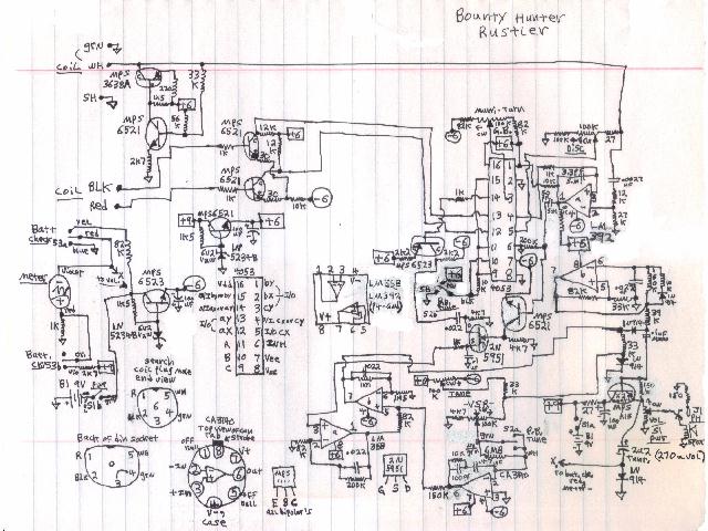

              Forgot to mention but in the middle I state P4-gnd, refers to the LM392 on the right side being run single ended whereas the 358 in the middle is running dual polarity supply. As I stated had I been able to draw the coil portion properly I would have taken the time to make a better drawing, in the one shown it was my first try tracing the board and using whiteout corrections when I realized I had made errors in following the circuit. I post the drawing as it may be useful to someone working on a broken Rustler. Also the pot marked multi-turn is an interesting design using 3 large steel balls as a reduction drive which allows for slipping at the ends of rotation.

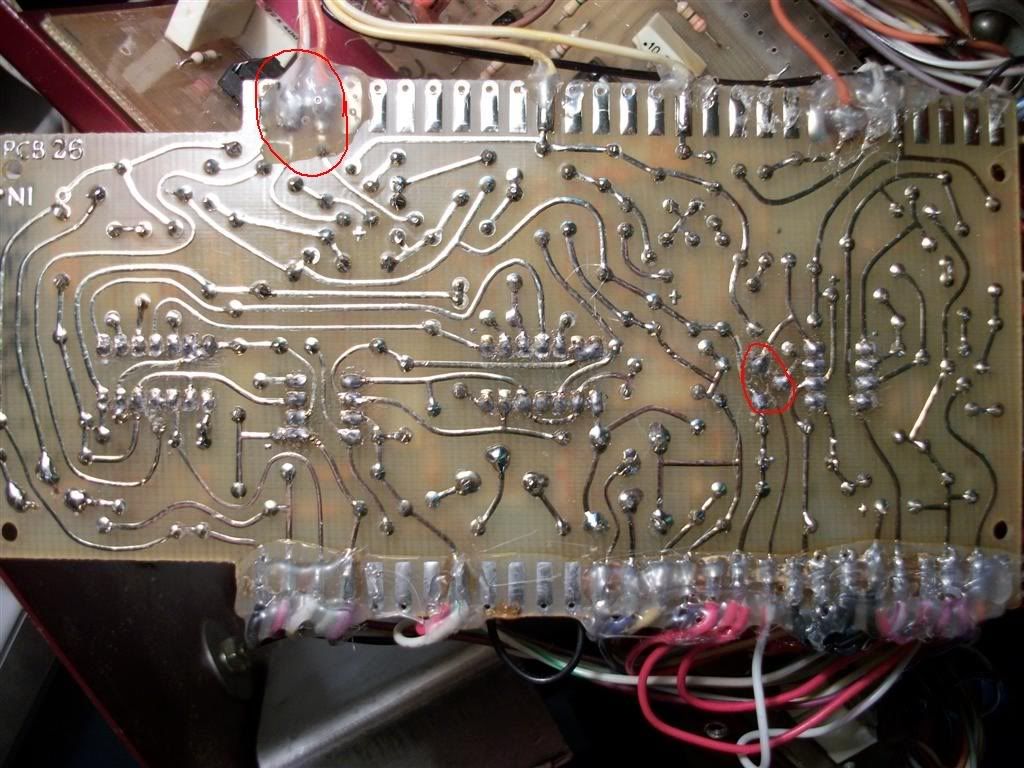

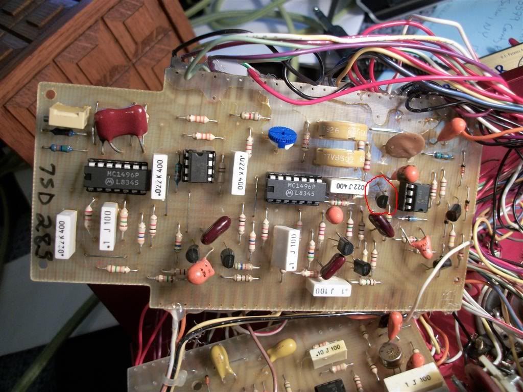

                Red Baron eating transistors
                Hello been reading quite abit of this thread during my saga of repairing my grandfather's old Red Baron (may he rest in peace). Been in the family since new and trying to get it working again to use. Worked great before it was put into storage but when taken out and powered up started smoking. To my knowledge no 9Vs were ever put into it but not sure. One transistor (MPS3638A) keeps burning even after replaced. It is circled in red on the pics. Not sure why. An orange capacitor nearby while in the circuit has a reading of 0 ohms (or really close). Will be taking it out to check though seems odd. Could it be shorted? How can I figure out the uf? Doesn't seem to be listed on it. Doesn't seem to be an electrolytic type. The power hook ups are original and the rest of the wiring looks correct (except the orange and orange/ white wires to the board which are circled in one pic). Could a bad coil cause this? It is the original and was never swapped. Anyone have a clue and can help? Power/ volume switch has been gone through and appear to work fine now. Thanks any help is greatly appreciated.
                The pic of the board is out of a 3 board model from the 1980s and is the one with the most wires attached (its NOT the Synchronous phase or the one mounted on the back of the meter).
                Don't know how to add pics yet so here's a link to Photobucket.
                and in case the above don't work here are the links
                http://i632.photobucket.com/albums/u...s/RedBaron.jpg
                http://i632.photobucket.com/albums/u.../RedBaron2.jpg
                ThanksI really appreciate any help.

                        Thanks Qiaozhi but I already downloaded those schematics and still can't figure it out. Actually the schematic for the coil hookup and the pics of Mark's RB-5 show 2 different hookups for the orange and orange/white wires going to the board. Mine is a RB-7. Tried both ways and no difference. Transistor still burns (one time it burned up so bad the terminal conections inside could be seen). So far a few of the Caps on various boards seem to be shorted? At least the ohm meter shows a connections to be shorting (haven't taken them out of the circuit to check the caps yet though. I think they are tantulum caps though (all orange).

                          Electrolytics at this age are more often shorted than not. They make them much better now. Especially true with 10 volt or lower rated electrolytics made around the 1970's. In the Cobra 148 GTL CB radios this effect was coined the "ten volt blues" by Nomad Radio. Just start replacing them and then repair whatever semiconductors which got lunched from the shorted capacitors. Only then power it up again. I had this mindset in the 60's and 70's on TV sets. For some reason I could not quite get it in my head capacitors were often more trouble causing than any other parts.
                          • #58
                            Thanks. Are those orange ones electrolytic? I replaced the blue electrolytics already before powering it up. I thought the orange ones were tantulum or something like that. They sure look like the tantulum type to me. The orange ones say 10v and 33. I know what the 10v is but what is the 33? Is it 33uf, 33pf, etc? Thanks
                            • #59
                              Tantalum 33 uF 10 volt. You should always replace tantalums with the same, higher voltage is OK within space considerations. Tantalums often short for no reason other than age but it helps if you at least measure them. None should show a short circuit. If they do replace it. The only reason to use them is low leakage applications. If in non critical power filtering use I do not see why regular cheap electrolytics would not work. However unless you know for sure its function in the circuit better to stick with what is. Increased leakage in say the input circuit of an opamp could cause havoc to operation of the unit. I cannot read the caps in the pic but from the size no doubt 33 uF is correct. The yellow ones on the bottom board are also tantalums. I do not see any regular electrolytics (blue or otherwise) in the pic you posted but you chopped off part of the lower board. Just a wild guess but I think the yellow tantalums are the plus and minus 6 volt filter caps, likely where your power supply short is, replace the transistors even if they test OK unless you are able to also test for micro amps of leakage. Do not know what you are checking them with. A Fluke could beep normally on a slightly leaky device and it is hard to imagine if they fed power into a shorted tantalum they did not suffer harm.
                              "So far a few of the Caps on various boards seem to be shorted?"
                              I am at a loss as to why you are not removing these and installing new ones before you replace the burned devices and turn on the power. Somewhat of a mystery to me. Sounds like buying new tires over and over yet never sweeping the nails out of the driveway?
