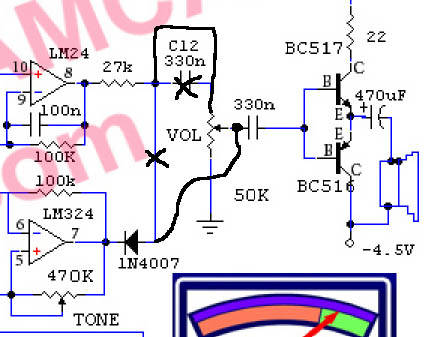

                        hi
                        emekli amca has build a TARSOS and it works very wonderfull
                        these are test video:
                        http://www.savefile.com/files/1687231
                        http://www.savefile.com/files/1688307
                          my vision on this part
                            hi kt315
                            when you do the variation my dedector I experiment
                            I write tomorrow result
                            emekli AMCA us on the project better work for Every various the variation You can do Say
                            GöMüCü...
                              hi KT315
                              i want to ask this and learn your idea
                              why you suggest as this connection _?
                              thanks
