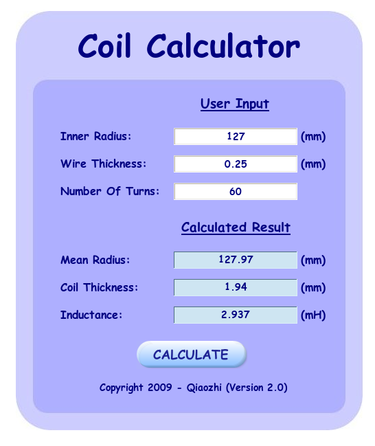

    10'' coil:
    Tx=60 turn of .25 mm wire = .176mH
    RX=90 turn of .25mm wire = .375mH
    and for 20'' coil:
    Tx= 38 turn of .25mm wire= .176mH
    Rx= 57 turn of .25mm wire= .379mH
    TRUE?!!
    Your calculations are still incorrect.
    For a 10" diameter coil (127mm radius) with 60 turns of 0.25mm wire, the inductance should be 2.937mH.

      what is this? ((Tx coil = 2.5 nF Rx coil = 5 nF)) since the calculate software dont need those!!!?
      please see the image, is it true for 20'' DD coil?!
      RX=14.128mH
      tx=6.87mH

          I don't know what you're doing wrong with the calculator, but for a 20" diameter coil, and using dfbower's inductance values:
          TX -> N=36, L=2.5mH
          RX -> N=52, L=5.0mH
          If these windings are for an OO coil, then the number of turns are correct, but for a DD coil you will need to fudge the results to compensate for the different coil shape.

                          A 20" diameter coil is 508mm in metric. This means the coil radius is 254mm not 500mm, as you have entered in the dialog box.

                          When you ask for wire thickness in your Coil Calculator program, do you intend for that entry to be conductor thickness, OR, don't you expect for the entry to be overall diameter such as conductor thickness plus 2x insulation thickness?
                            Qiaozhi,
                            The calculator assumes you are using enameled copper wire. It does not have the capability for the user to enter the insulation thickness between individual windings. In practice there are many factors that can cause a difference between the calculated inductance and the final value. Although the insulation thickness is one factor, this is minimal when compared to discrepancies in coil shape, inner radius and the way the bundle is tightened. At the end of the day, the calculator is just a tool to get you into the right ballpark. Often you have to either add or remove a few turns, but generally the prediction is quite accurate.
