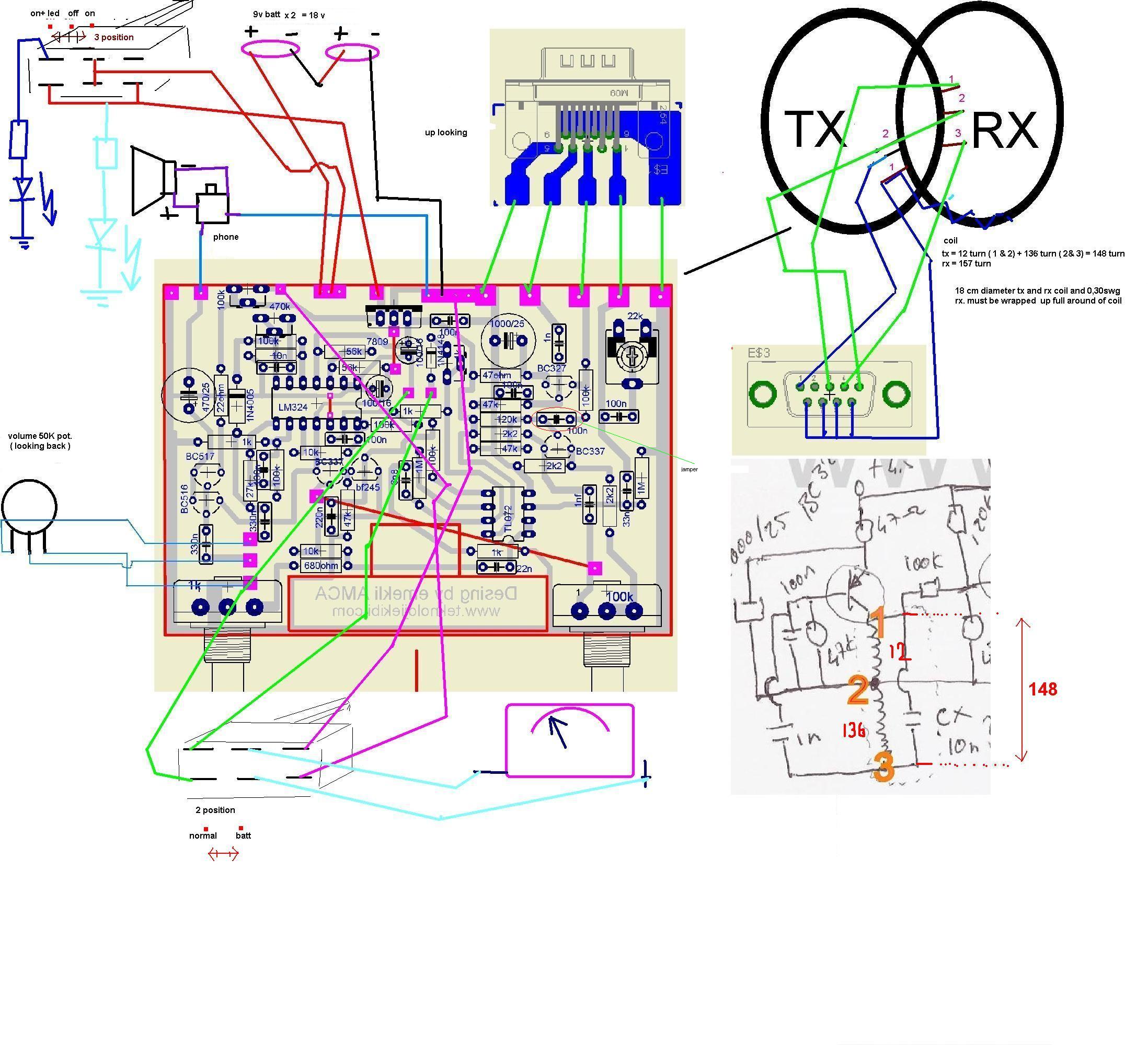

    here is correct pin number and plan

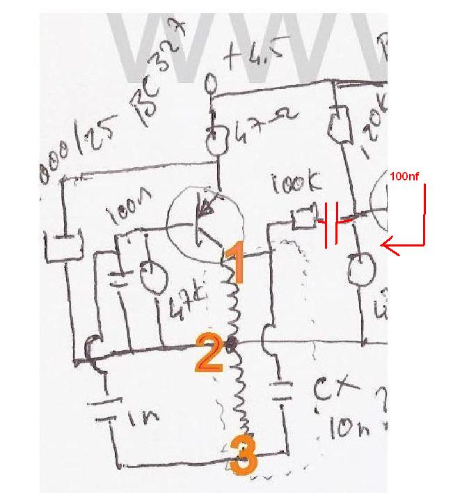

      In the first transistor BC327 oscillator to the departure of the collector there is a resistance of 100k and the pcb also below that of resistance there is a condenser 100nF that plane did not appear. Which is correct?

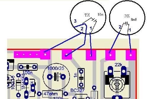

        Explain wire connection from pcb to coil ? 4 wire + ground or ?
        coils to pcb connection...
          wire tipe ?
          3 wire + ground or 4 wire + ground ???
              montage pcb error

              Error in montage pcb.......instead 100 nF....should be jamper !!!
                hi karlos x you are right
                our ovrelooking this error thanks...
                  jumper or condensator?¿?¿?¿?¿?¿?¿?¿
                  Carlos
                    put condansator(100nf) carlos....

                              question
                              Regards...
                              Shematic corect ,or no corect ??? In shematic only resistor 100 k go colector
                              to baza second tranzistor,no capacitor 100 nF !!!
