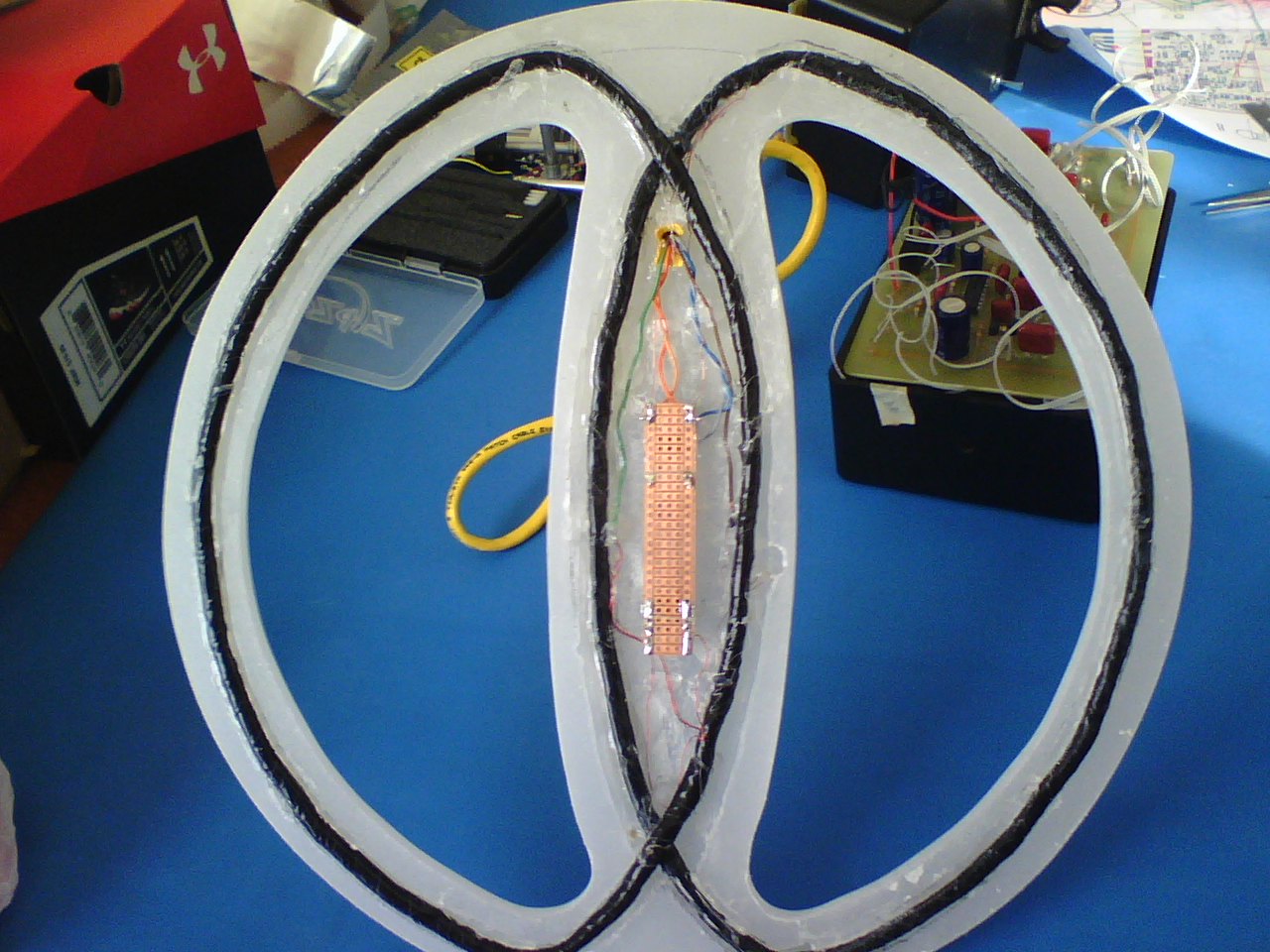

                          Hi Aziz , ı need calculation for Tarsos Omega coil tx-rx.
                          Mrb. Aziz , Tarsos'u Omega bobinlerle çalıştırmak için hesapları ne olacak TX-RX turları nedir.

                            A few words on assembly though. If you do the math with the stated values for Tx & Rx resonance, it doesn't add up. I used about 5.8 nf for the Tx coil. Am I missing something?
                            Also, it took me a while to figure out how the controls work. The best way to tune the circuit is to set all the pots at max resistance, set the "disc" somewhere in the middle and bring the coils to the best null. Use the "disc" control as sort of a "course" threshold control and use the "GEB" as a fine tune control. You can put the circuit together without an o-scope, but if you have one, it really helps.
                            Don
                            • #74
                              Hi all! Who know to make coil for this device. If you can to explain could you do this in details.
                              • #75
                                Making Tarsos coil
                                There is enough detail in the text above to build the coil. You just have to study it a little. Also, if you look at some of the links to a few of the videos it shows you how to tune it also. Pay attention to some of the corrections that have been posted on the schematics though (Pins 5 & 6 on one of the LM324 op amps are switched and a 100n cap is missing from the schematic). Other than that, if you just use the circuit board layouts provided it should work just fine. Just a few notes, I added a foil shield to the TX coil and ran a separate ground, as the circuit will false without it.
                                Also, the circuit does not seem to be too pickey about the coils being in full resonance. I even left the tuning cap off of the Rx coil and it seemed to work OK, but much better in tune. Also, would recommend building the circuit with the autotune option. It works but is difficult to use when you need to keep retuning all the time
                                Don
