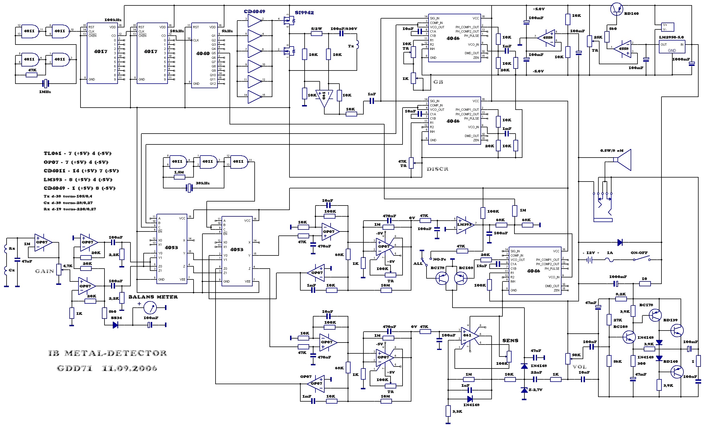

    Hi all,
    GDD71-IB Metal detector. Schematic and PCB.
    Hi rael
    It is interesting, thank you .what is performance?
    Best regards.
      Hi, now you presented such info, would you please describe this MD ?and tell its' abilities and the technology it uses; BFO, VLF or PI?

              Hi Aft and michael,
              Exactly, GDD71-IB is VLF induction balance MD with 38 cm coil and 5kHz working frequency.
              I have not experience with GDD71-IB or Thunder and can not comment them.
              Using of two oscillators is designers choice. I think, one oscillator and another counter is possible.
              IGDD71-IB is Thunder modification.

              Some comments from GDD71:
              "Power consumption is 115mA."
              "MD is very stabile and tuning is not necessary during working."
              "MD work perfect with 38 cm search head."
              "I find targets in depth out of reach for usual MD."
              "The Temperature stability is excellent during two month testing."
              "GB - phase shift ~45deg.
              DISK - phase shift ~145deg.
              (4046 VCO OUT pin 4) "

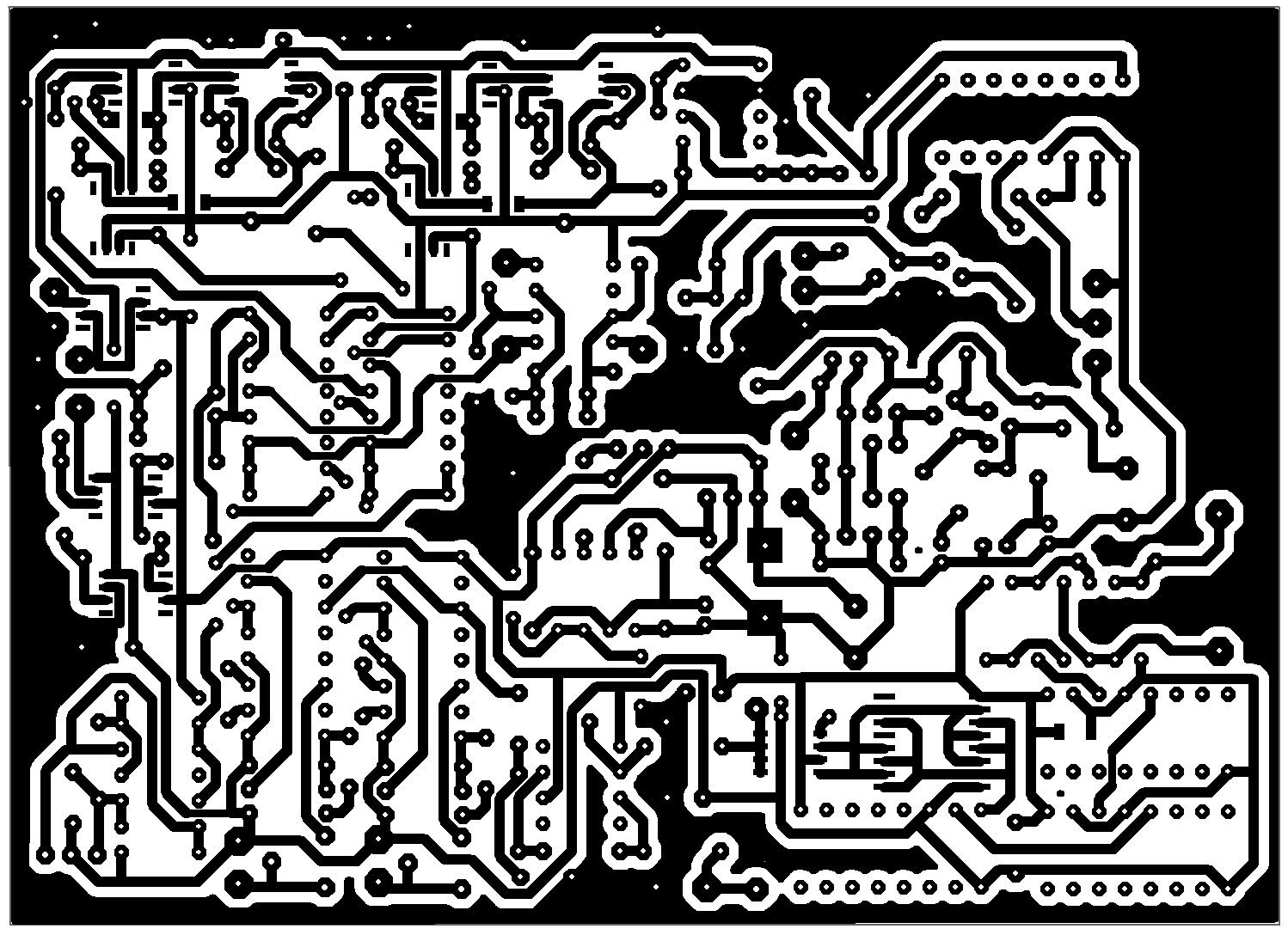

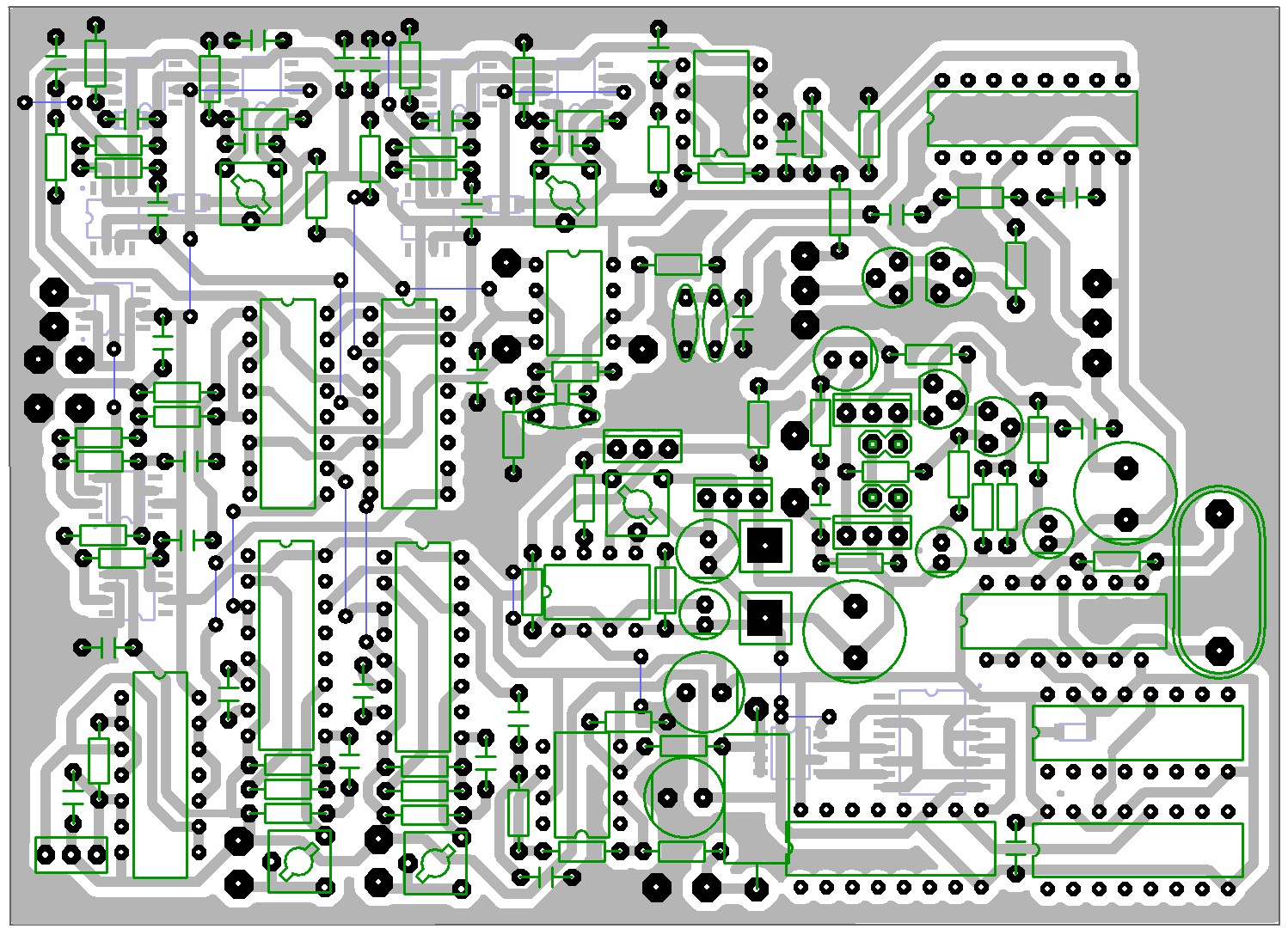

                Hi Rael, thank you. although I'm not electrician and don't know enough electronic, but it sounds to me the schematic is incomplete. where is coil formula and PCB layout including components on? Have you made yourself this or know anybody's made?

                          gdd71 give next coil data :
                          Tx - d-38cm 105 turns 0,4 - 100nF/630V
                          Px - d38cm 28 turns 0,27
                          Rx - d19cm 220 turns 0,27 - 47nF
                          He not comment targets and depth in md4u.ru forum.
                          The big coil have bad discrimination and low sensitivity to small object.

                          The missing diptrace file is attached.
                            Hi rael
                            Thanking so much, but gdd71.zip at MD4U contained 1.3MB. may be cannot
                            Uploaded here. Please send me completed file to my mailbox.
                            It was also contain circuit diagram in *.dch format.
