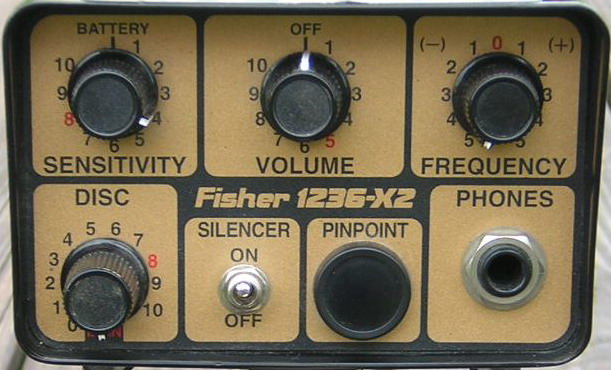

    This is the best place to ask - so here I am!
    Thanks in advance.

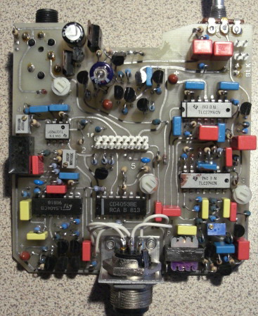

    so... can you open your box and do a scan PCB of your 1236X?
    sorry if best place has not what you sharply need now. it is 1235X PCB. I must compare both PCB's and find 10 differencies.
        dead silence topic...
          KT315
          Nice fotos.
          But I am not familiar with fisher brand.
          What is the coil?Can we see other side of the PCB?
          It look like top range.Manual multifrequency,pinpoint,.,.,.,.
          Also high quality elements TS27M4!Nice.
          But its a hard project
          Wish you luck

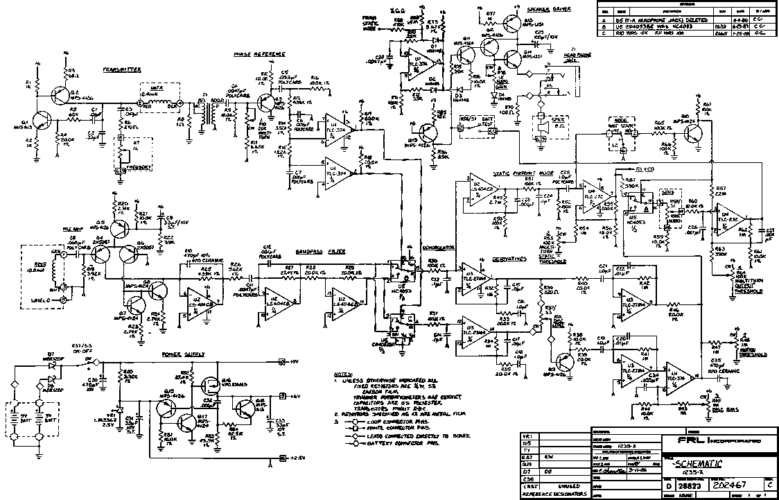

            Thanks for the schematic, KT315. The "factory original" is hard to read, but taken in conjunction with the PDF, everything is very clear. Good deal!!
              Schematic of the 1235x
              Hello KT315,
              would you please be so kind to post a better copy of the 1235x factory schematic, so that i can read the letters and numbers correctly?
              I also need to know whether the frontside potentiometers are linear or
              log. I think at least the 'sens' potentiometer is logarithmic.
              The marking is 'A100K' - but the marking of lin and log has changed, so i am not sure.
              Thanks and kind regards!
                good luck my friend. this is all 1235x I keep on.

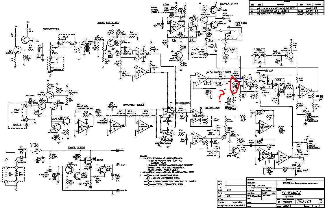

                  Is not it WRONG here?
                    do you want to convert a static mode in dynamic, or what?
                    why you CHANGE the fabric schematic in your fallacy manner?

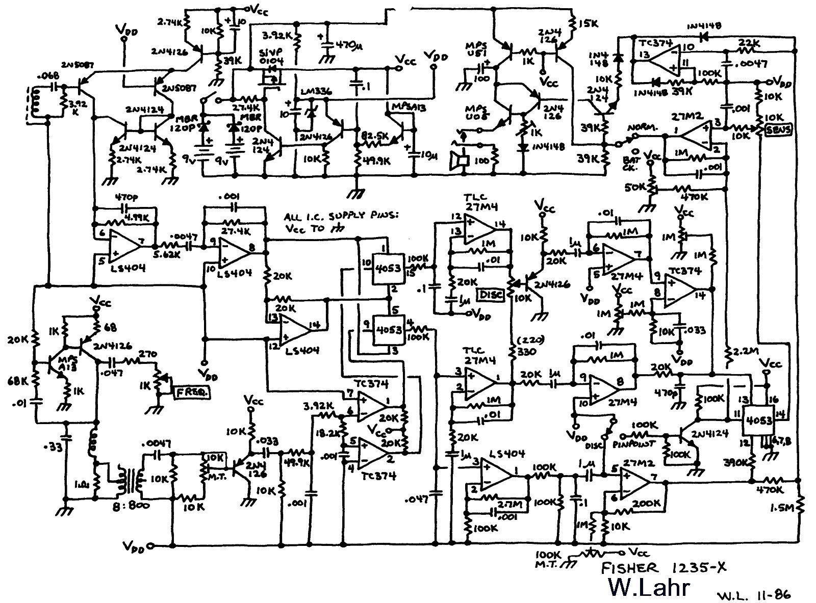

                      Thanks to 6666 here's another version by our friend W.Lahr.
                      Found it here:
                      http://phazitron.narod.ru/archiv/schmd.htm
                      Of course I make no claim as to accuracy
