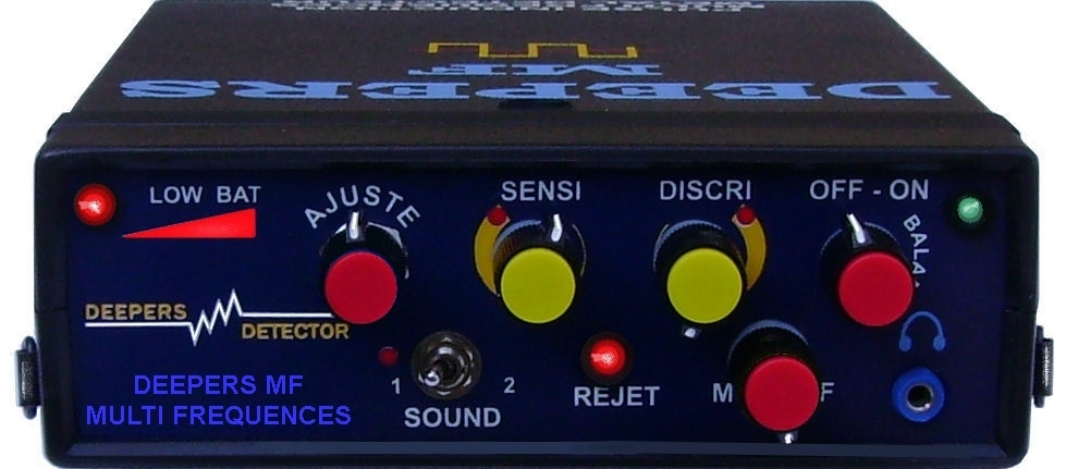

    Hi Alexismex.
    Last weekend i receved an original Deepers MF (that have all items show on the pictures), that looks the same has the Deppers 8. The only deferent i can see, is that Deepers 8 have an LCD meter. The rest look to me the same.Next weekend i will have time to take many pictures from Deepers MF (10 DD).
    By now i think the most important part is to have good details of the pcb traces and components placement.
    I donĀ“t think that a conversion from Deepers MF to Deepers 8, will be to much complicated.
    By the way i had just an air test with a coke can, and hipersensitive coil, adn results was almost the same you got. Looks like a good machine.
    Another function that i did like, was the way you can shift frecuencies, very easy and also helpfull to get te best sensitivity you need for the target you want to find.
    Inductance is the same has you, 285 uH and 2 ohms for the hipersensitive coil.
    I wil also like to make a smaller coil,that is also easy, cause the coil is a 4 pin standar conector.
    Well lets keep in touch to share more informatoion about this detector, that for many peole looks like a mysterie cause the is not to much review information on the net.
    Kind regards
    Nelson

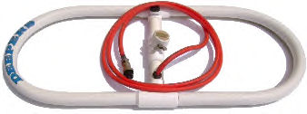

      • #63
        Hi Alexismex.
        Do you know how to make a DD coil for Deeperf MF and how to connect to it?
        Also do you have any PCB?
        In advance many thanks
        Nelson
        Originally posted by Alexismex View Post
        Hello Nelson ,
        The schematic is 100% functional from original ,is my contribution for 2009....
        • #64
          Hi Alexismex.
          I have tested Deepers MF and i think is a good detector, but when you go to a high mineralized ground, it beeps all always. I have tested all kind of setups, but when i got off the beeps, deep range gots short.
          This test were made with the Hipersensitive coil.
          I also made a 20 centimeters coil, working good, but on high minerlized ground, the same thong happends.
          Now i m looking to make a DD coil, but i need information on how to build it and where to connect it to deepers MF.
          This week i have to make a desicion if i m going to buy it at a good price or just leave it.
          Nelson
