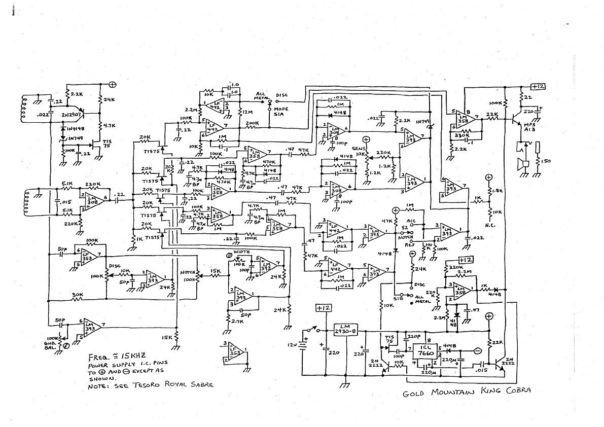

    Does anyone have a cheked TRS schematic?
    Tiktak,
    Hear is unchecked if any use

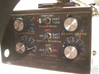

      Here is front panel I think?
      Molzar

        I cant open PDF now because use vista and still havent all programs but I will check it ASAP.
        I think that this should be even deeper then owe TGS.With custum coil!

            Its look prety like TGS.
            I wonder what is this build in mineral rejection?And what is the disc?Same like TGS or other tesoro disc stage?Also on board there is fast thuning switch!What is this for and how is used?
            This device should be deeper than TGS but I dont see how this is gonna happen.Hope I can find and post some pictures on the PCB here.
              Another similar TRS schematic...."Gold Mountain King Cobra"

                Thanks for posting this.I am waiting for some fotos.I will share when I recive them from a friend.

                  Can somebody tell me is that on molzars picture royal sabre or royal sabre plus?
                  What are diferances?
