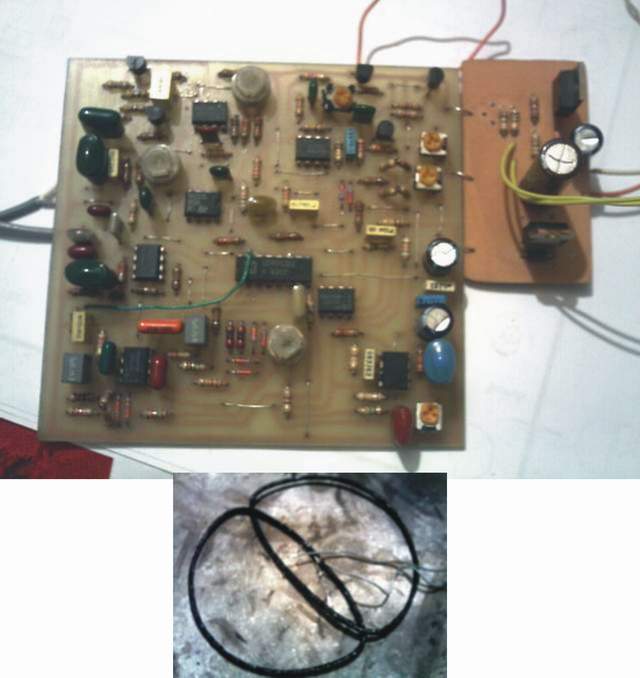

                Finished and working. Although i havent made coil yet. I tested it with some TGSL coil from scrap, just to test is it working at all. Frequency now is 8.4kHz. 1e coin detects at 22cm distance, but must say coil is not nulled at all. I just constrained those 2 D shapes approx. just to make some so, so balance. Way out of good balance. Still it is working and it is very fast and sensitive. I can not pull any conclusions about final performances mostly due unproper coil. All the presets are working and affects behavior. I tried even with this bad coil to achieve something. It is for real making differences; high pitch for coloured metals and low pitch for iron. Yet at some point when iron is far away it produces high pitch like on coloured metal and vice versa when coloured metal is to close to coil it is switching from high to low pitch in audio. Must say that audio is splendid, very nice,pleasant, adjustable freq. and very,very loud!
                So...that was preliminary test 20 minutes ago. I am pretty satisfied and do have a hunch that this might turn to very good detector.
                Only one important question for Sasho; before i made coil i must know what is proper residual voltage at RX when coil is balanced well? Or other words how to balance coil? Can you explain a bit and help. I assume that nulling method for this one is not quite the same as on TGSL..so please explain.
                Also i would like to void OO coil and make standard DD coil, any hint about this?
                Last...when coil is done and nulled well...can you explain in details adjustments of those offsets and phase trimmer...although i already have some ideas..

                    You see here the point is to have almost equal coils so they could be in fullresonance.This means great sensitivity.And this test coil of yours is DD 100/105!
                    Make proper coil and Enjoy!Remember?
                    Everything will go on place.
                    • #70
                      Yes, yes you are right. Just as i assumed...so this MUST be fully resonant!? Ahaaa...ok...i will make exactly the same coils soon...
                      Thanks!
                      P.S. now only nulling method is interesting me....
                      • #71
                        This is same as TGS.
                        You look for minimum residual voltage.

                            No Problems.
                            Pin 7 5532 or directly form RX outputs.
                            But still far from this Nexus datas.
                            Post your results when you are ready with proper coil.
