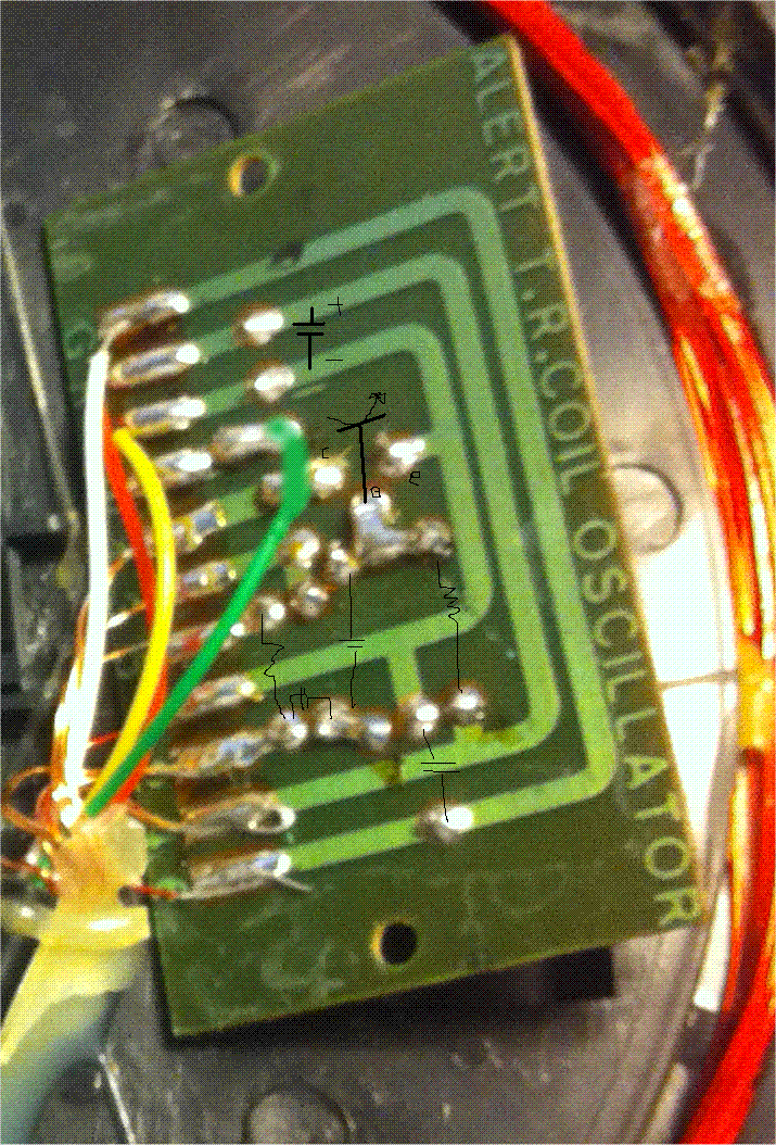

                    anyone got photo of viking ?
                    has anyone got a photo of inside the search head of any of the viking detectors ?
                    thanks in advance

                      I do not have a photo of the insides of the Viking 5 search head, but it is relatively simple to deduce what the internal coil windings look like from the wiring to the PCB, and by examining the schematic.
                      In my tests (when I still owned this detector) I decided that it was a DD coil arrangement.

                        i thought that with a TR type i have
                        dd yes but the one i have has a mini circuit in the head.

                          Can you post a photo of the whole detector?
                          I suspect this is a different (maybe newer) version of the Viking 5D.
                          In an earlier post I said there may be some tuning caps in the search head, which caused problems with the inductance measurement, but I am confident that the TX oscillator was on the PCB. You can easily see that from the schematic.

                            sorry it's not a viking
                            i didn't explain myself correctly.i meant to say it is a TR type .it's got "ALERT" and "made in china".
                            • #44
                              its Micronta 3001
                              the transmitter is from Micronta 3001,
                                So your photo was not from a Viking 5D?
