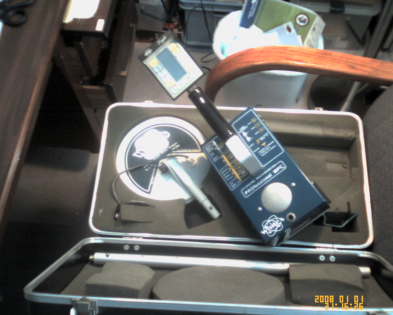

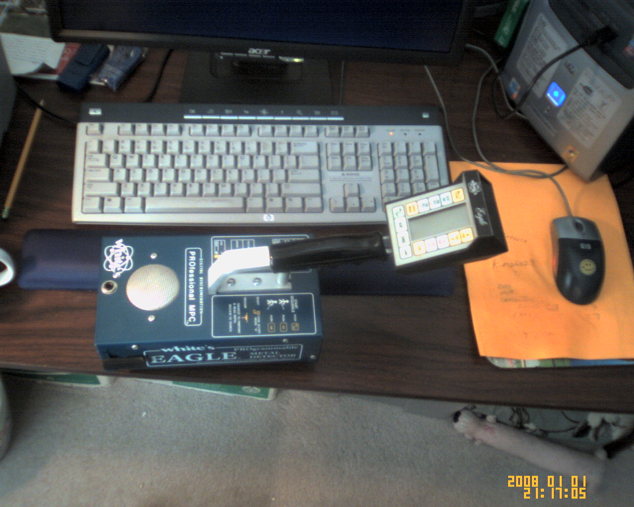

    I will be posting here and on Thunting.com complete H.D. photos of my Eagle I , MPC , It seems to have an occassional high current draw , somewhere right after the battery contacts are soldered to the circuit board . I do not understand why Whites decided to design the stupid 4 "C" cells with this model , maybe to save space or cost ??? I liked the Whites 6000 series 2 that had the 12 volt supply . Plenty of power and no voltage conversion problems . Reminds me a tiny bit of the stupid ICL7660 IC chip I do not like . These are just my personal preferences and not meant to get anyone upset but me................Photos and voltage reading's tommorrow "I hope'........Regards.........Eugene52

    The disassembly is easy ,only 4 screws I just need a strong light that does not cause a big glare . I have the "EAGLE I" schematic , sent from a "Great Geotech Member" like me........Sometime today during my very busy schedule , I will post total current draw in the idle mode and all metal and discrimination mode voltage reading's around the input section of battery supply voltage........I know I will fix it , but second opinions are welcome . Later I will send this old beast to Whites for the Big Software update and then I will try to find a cheap Blue max 950 search-coil ...........Take care all............Eugene52
