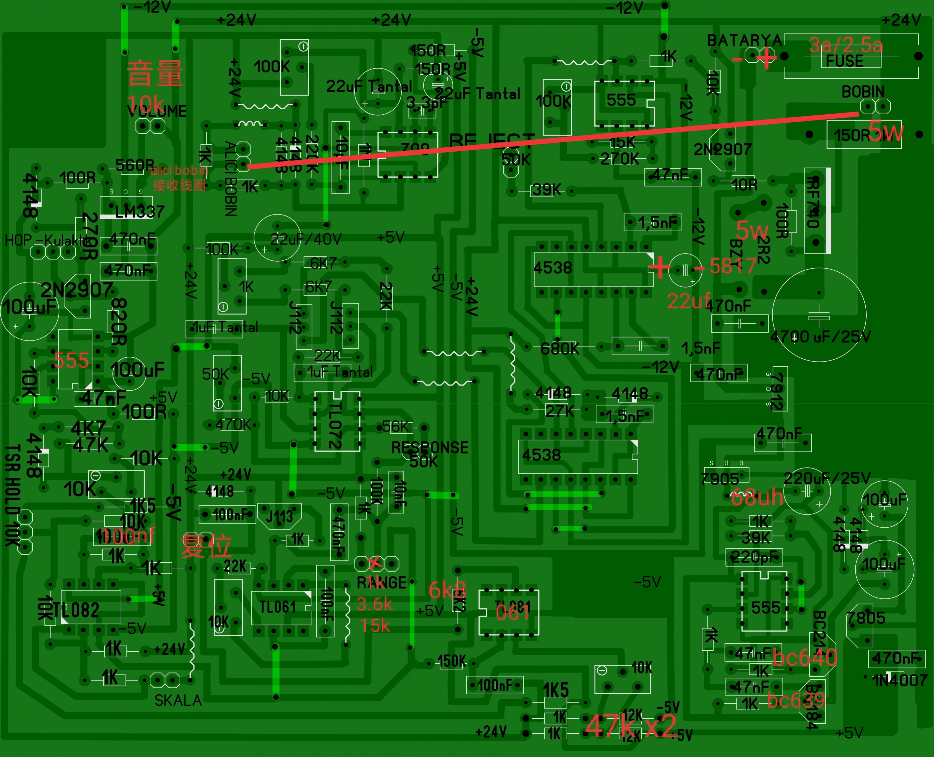

Superscan PI
  • TufaN,
    I have a problem. Which version of SL 6 was this file created with? A blank screen opens.
    • Hello
      Toros same file attached.
      • https://www.mediafire.com/file/rzudj...258F.lay6/file
        My own copy of the PCB, it is very simple, my first PCB file works.
        • Originally posted by samii View Post
          Hello
          Thank you Samii. Here the file opens normally.

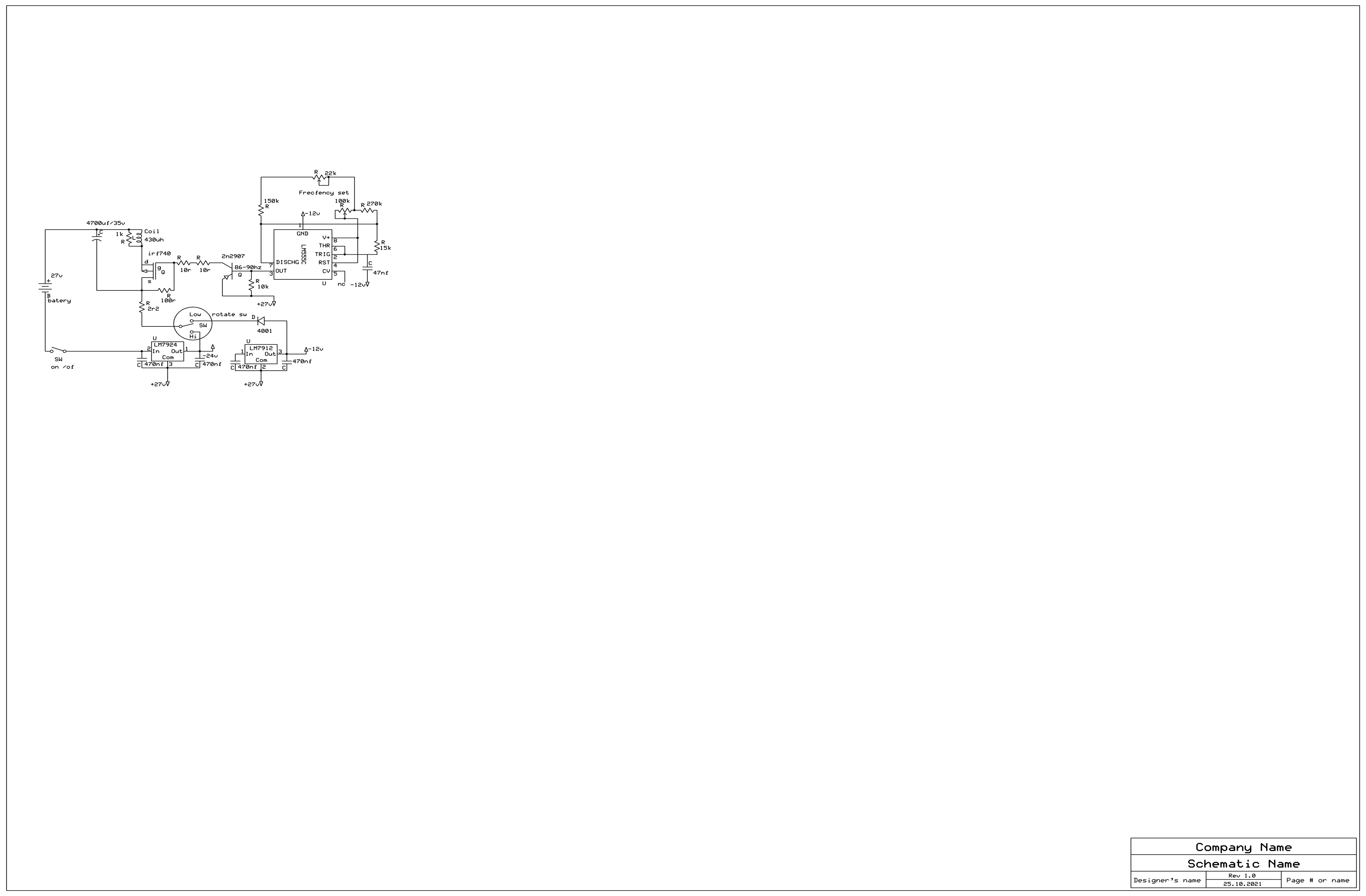

                  • Superscan does not have two mosfet but one irf740 !!It has two 1 amp stabilizers 7912 and 7924 ,the voltage in irf 740 goes either over 7912 or over 7924 ! low and hi power!
Name:	Super scan -tx.jpg

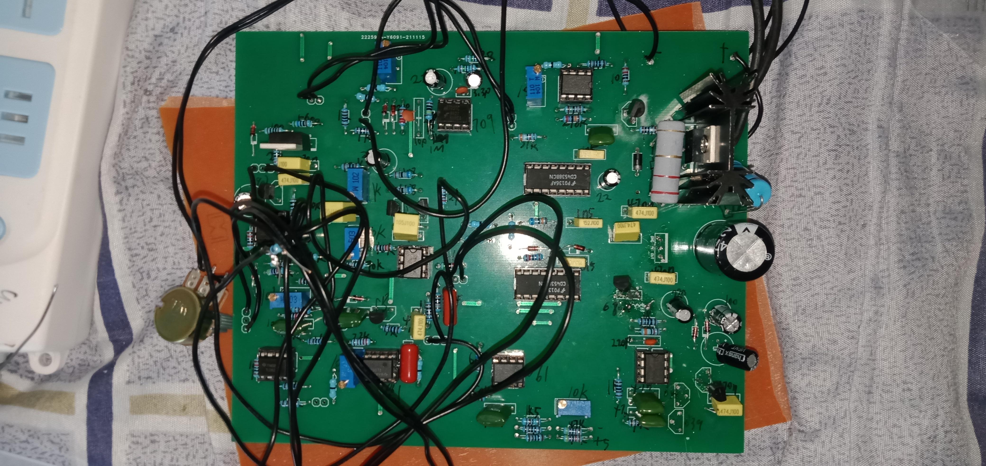

ID:	362128Click image for larger version

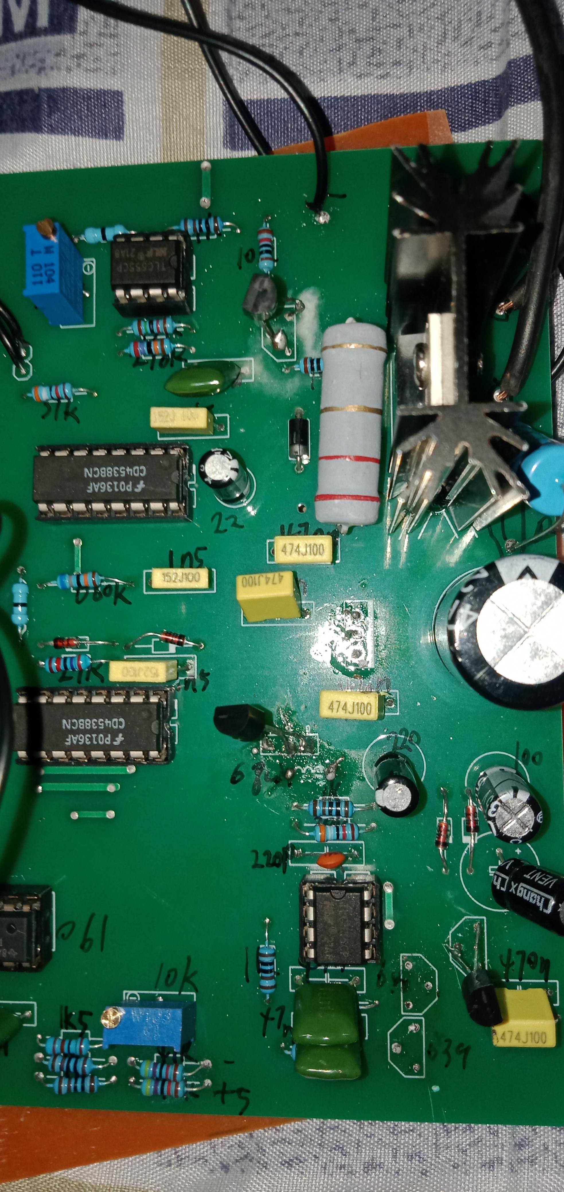

ID:	362128Make it again.
                            Inability to work
                            Wrong circuit, sound coming from the speaker
                            I can't get 5V, when I put the transistor in the right place, it goes to 5V, and when I put the chip in and measure the voltage again, it goes back to 7v
                            I don't know what the problem is with this circuit, it will never produce + 5V
ID:	362130Admittedly, it does have a lot of problems, and the triode in the lower right corner is not in the right position.
