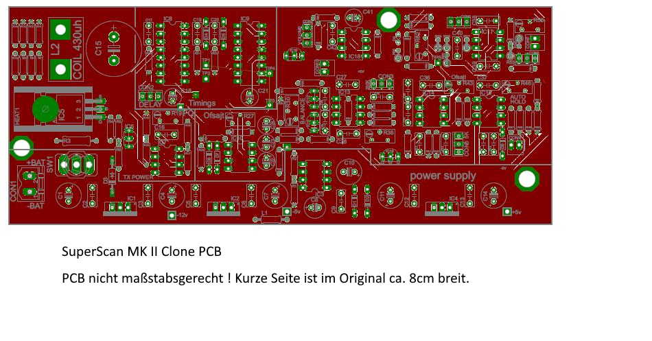

                • Hi ZOUJiarui,
                  there is a SuperScan PCB in the Internet. Someone made one. See picture. But I do not have information who made it and where you can buy it. Maybe someone from the forum knows more about it.

                            • One thing that can mess this project up is the transistors. Eric's detector designs, in many cases used transistors with ECB pin configurations. Where as most common transistors use EBC. This fact gets lost in the redraws and various pcb remakes
                              So in one pcb image in post #151 I see BC214(EBC) and BC184(ECB) with labels in red BC640(ECB) and BC639(ECB). This pcb uses ECB transistors. BC214, 2N3906 and 2N3904 will fail on this pcb
                              In your pcb image post #176 you have these labeld 2N3906 and 2N3904 and appears to wired correctly. This pcb uses EBC transistors. BC640(ECB), BC639(ECB) and BC184(ECB) will not work on this board
                              Which transistors are you using in your circuit?
