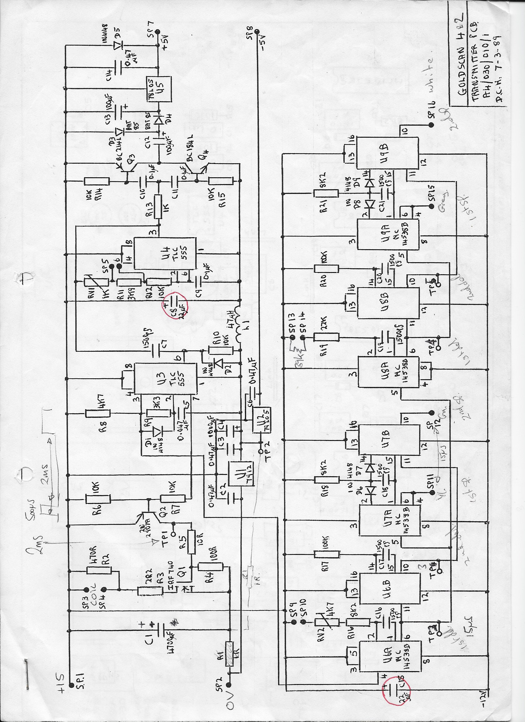

        One thing that can mess this project up is the transistors. Eric's detector designs, in many cases used transistors with ECB pin configurations. Where as most common transistors use EBC. This fact gets lost in the redraws and various pcb remakes
        So in one pcb image in post #151 I see BC214(EBC) and BC184(ECB) with labels in red BC640(ECB) and BC639(ECB). This pcb uses ECB transistors. BC214, 2N3906 and 2N3904 will fail on this pcb
        In your pcb image post #176 you have these labeld 2N3906 and 2N3904 and appears to wired correctly. This pcb uses EBC transistors. BC640(ECB), BC639(ECB) and BC184(ECB) will not work on this board
        Which transistors are you using in your circuit?
        This section of the circuit generates your +5 volts, if not working correctly, nothing works

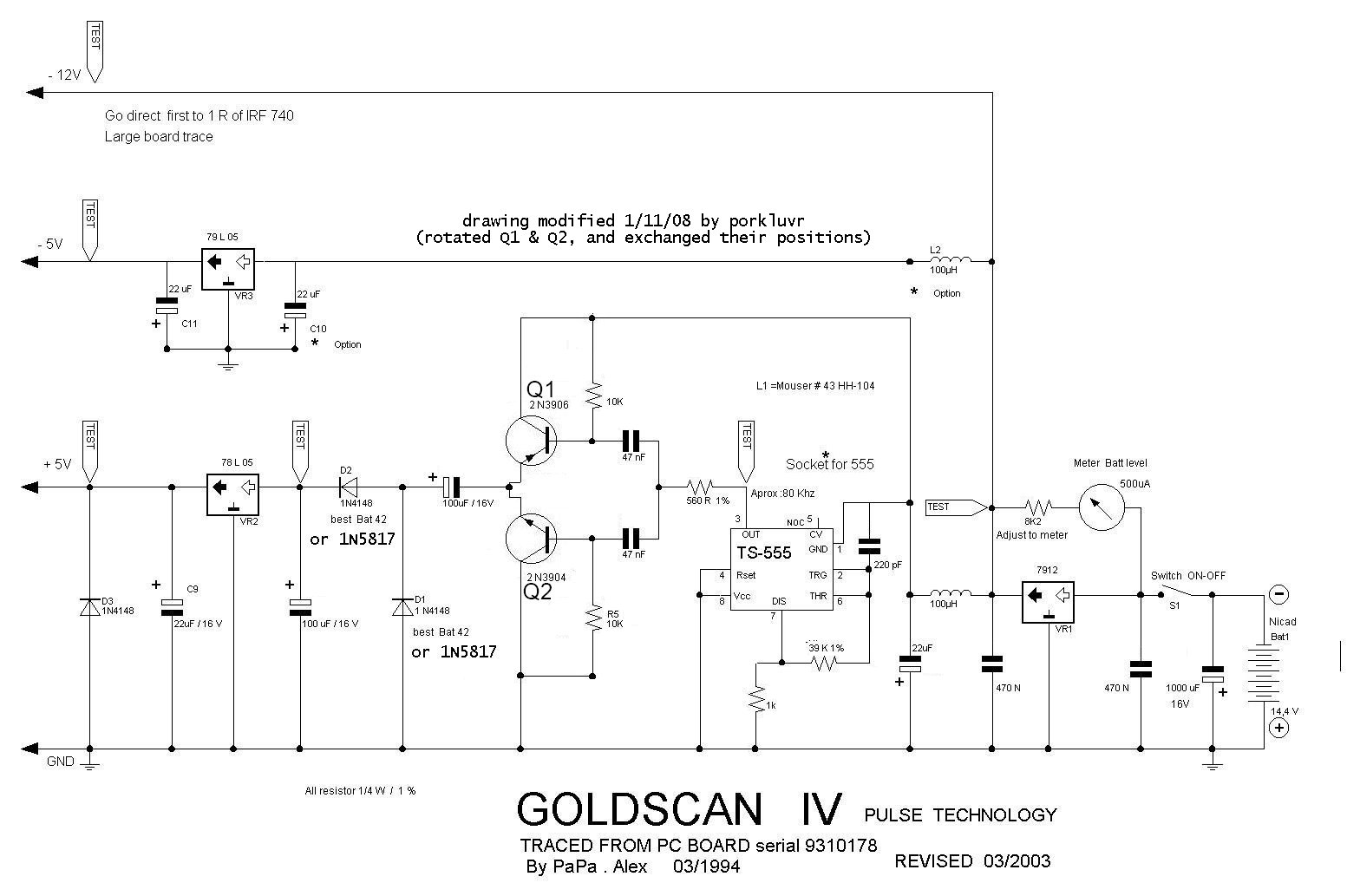

ID:	362140Eric's gold scan2 has the same circuitry, but it also has bc214 and bc184 on it
ID:	362141The transistor orientation of this gold scan4 is also different from it.

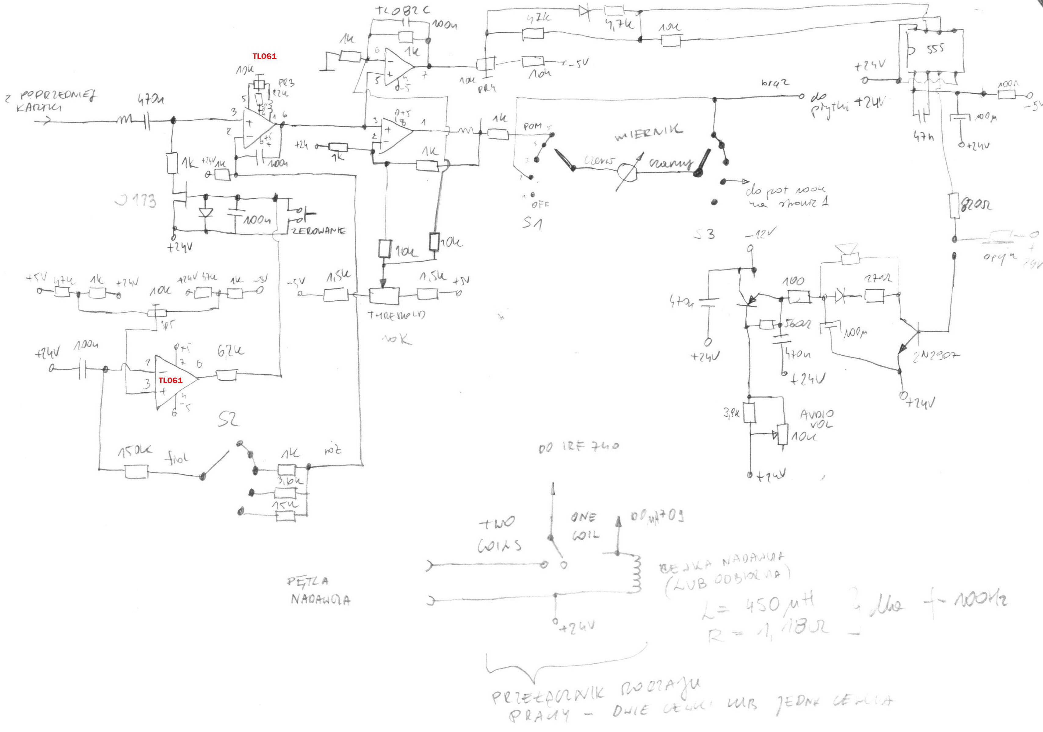

ID:	362142I built it exactly according to this sketch, and I didn't draw any drawings.
                • That doesn't do me any good because it's an unreadable mess. If you don't want to produce a clean readable schematic then don't expect any help.
                  • I do not understand that people with experience they can't read the schematics it is drawn by hand and is not inspected but anyone who has dealt a little with Eric Foster's schemes he can very easily understand everything. lm337 serves only for regulationn serves only to regulate the voltage in the speaker ,then a ground effect trimmer ,so trimmer potentiometer for reaction rate, then adjusting the active clamp as with gs 4 or 5 etc..it was not interesting for me to draw it again because this scheme served me only to fix the factory original super scan.

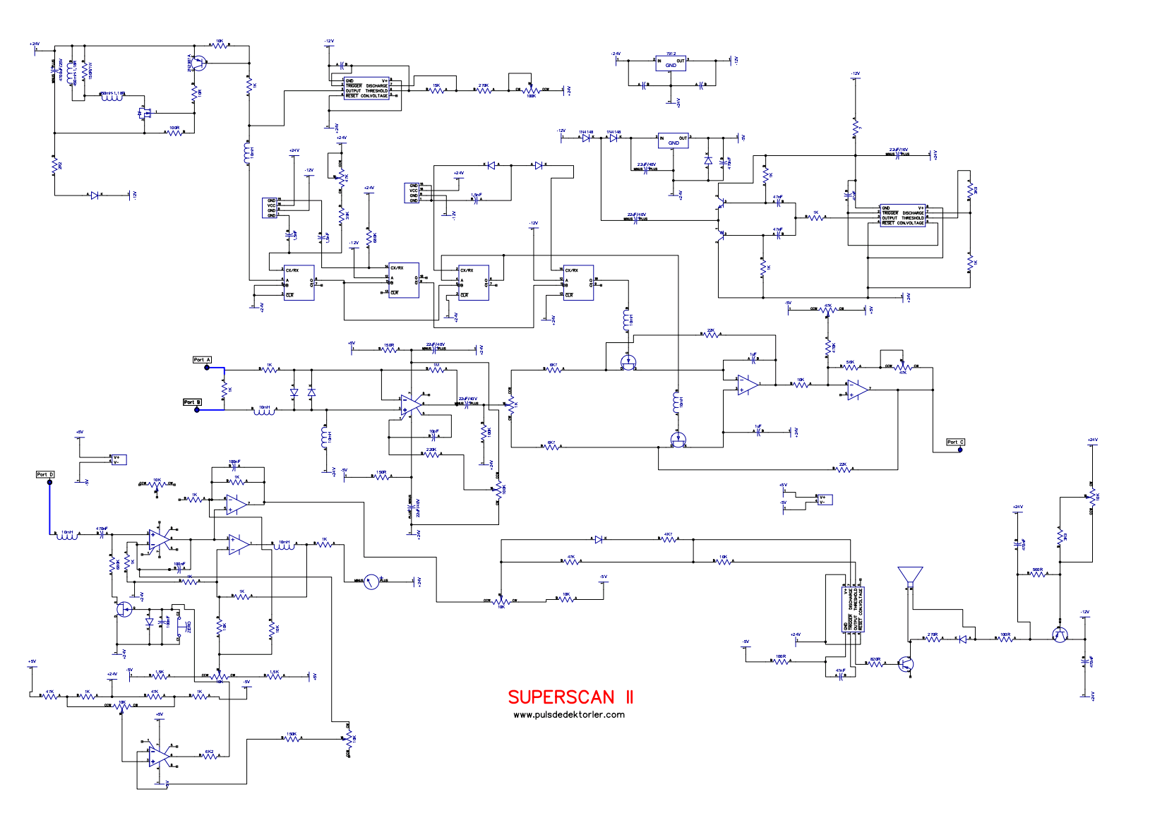

                          • Orbit hello, I think this sketch is mk2, do you think I am right?
                            thanks
                              No, all the drawings should be original super scan, I didn't find anywhere in the place where manual adjustment frequency, the Greece's MK2 sale instructions, MK2 should have digital circuits to perform data records.MK2 is still selling
