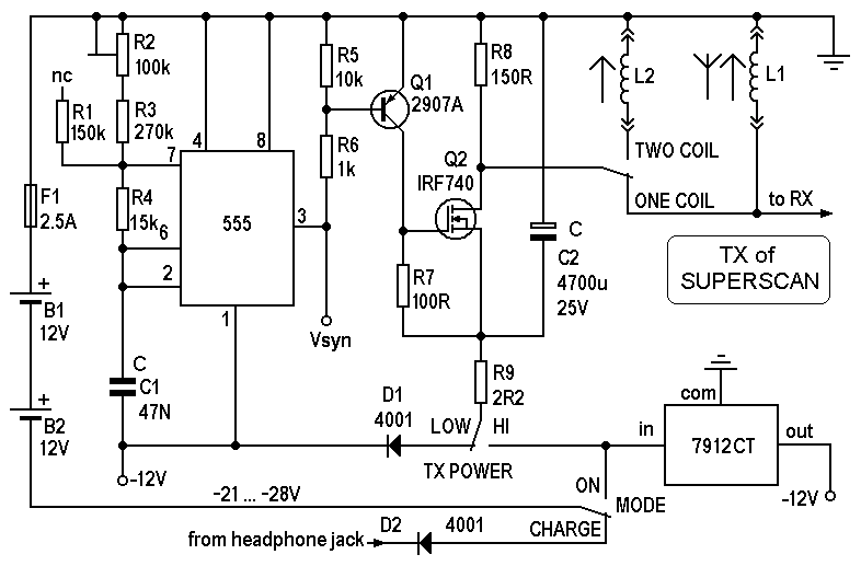

          • Ultra scan lm337 I think it is used to stabilize the voltage, I can not see it can control the sound. The original may be a triode.
              • The LM337 is used as a current limiter for the audio.
                    • Originally posted by Alexismex View Post
                      [ATTACH]56718[/ATTACH]
                      Hello, do you know what the 150k on the 555 foot 7 does?
                      I found that it doesn't have any connection on the PCB nor on the circuit diagram
                      • Most likely, it is used to choose to switch the potentiometer R2 from R3 to R1 in order to double the frequency of generator 555.

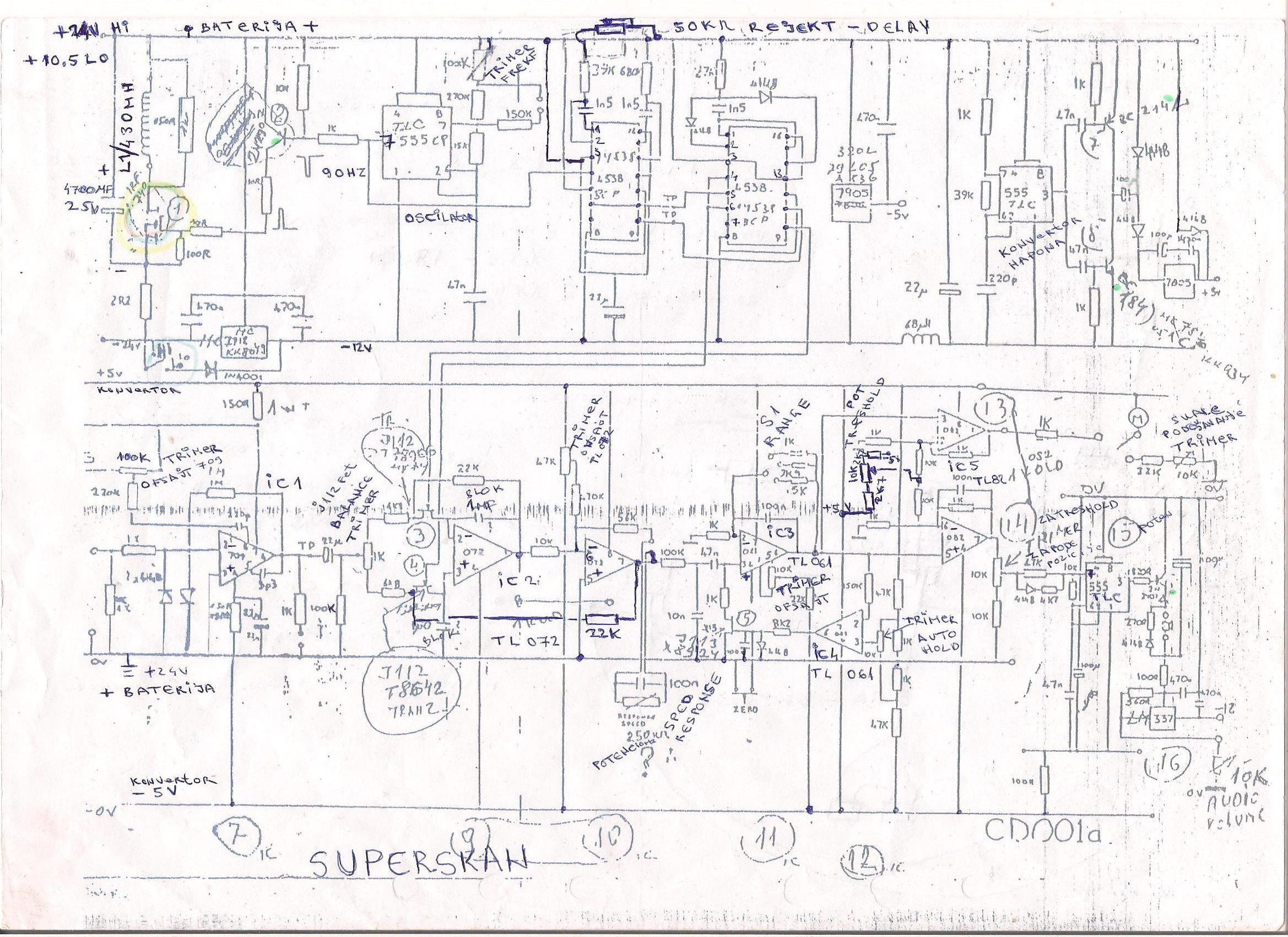

                          • can anybody share pics of high resolution (5-12 MB size) of the Eric's pcb? long way to result i see here... so if you did up the matter....
                            • There is a big difference in the position of the super scan sketch and the PCB, it is the place of the ammeter, it is hard to say who is right
