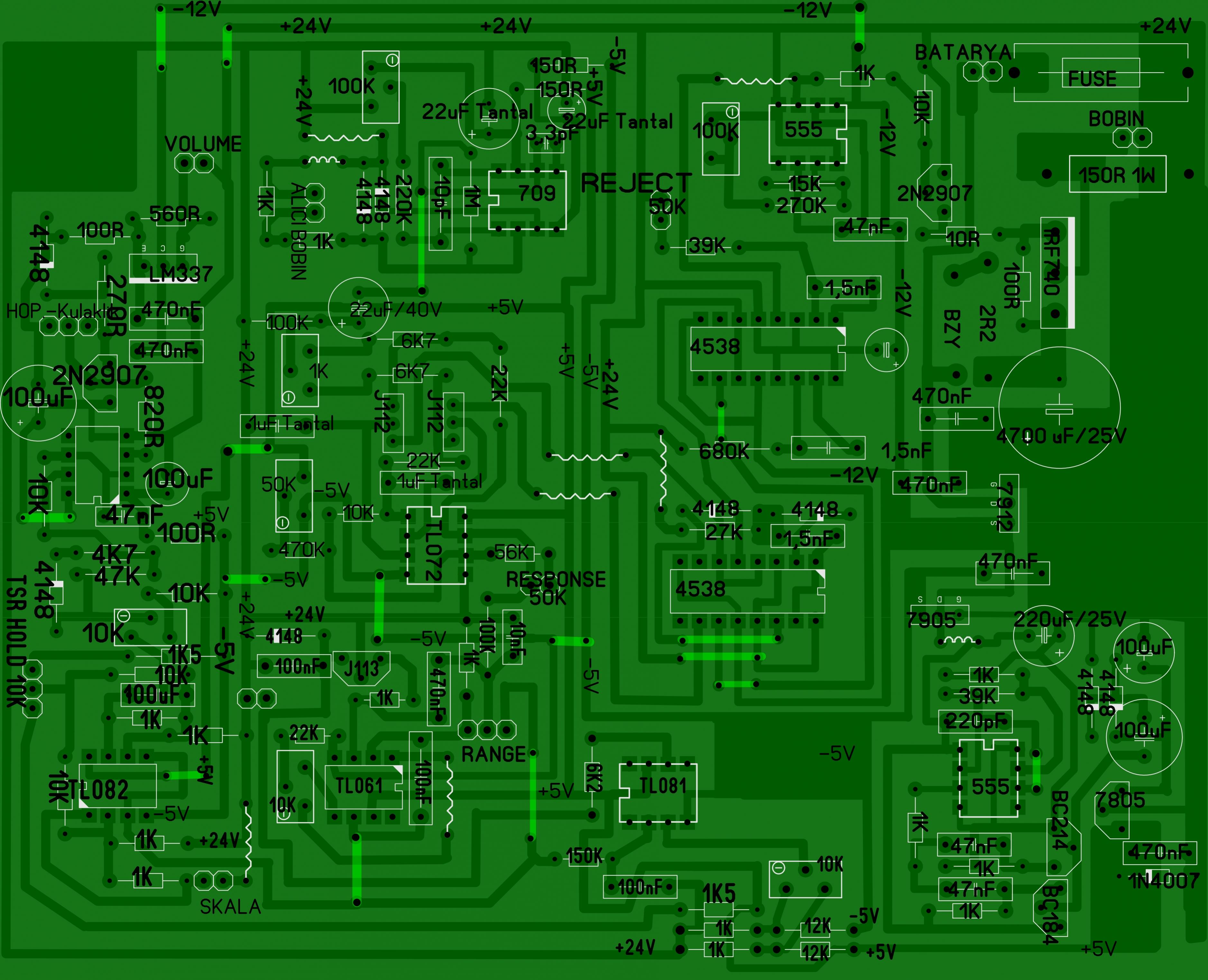

      Hello, a master told me as long as the adjustment 709 next to the 100K resistor, you can give me more explanation, thank you!
      • Originally posted by ZOUjiarui View Post
        There's no point trying to fix the problem using guesswork. You should have built the detector in stages, and tested each stage before moving on to the next one. The only solution for you now to is follow a logical fault finding approach as outlined by Carl.
        If you really don't understand correct fault finding procedures, then you should seek first-hand help from a friend who does, as it will be enormously difficult for anyone here to assist you remotely.
        • What circuit do you use? If you just solder parts on the board and call for help is not a good idea. No one would be able to help you with this.
          Provide more information about the circuit you're using /schematic not PCB/.
          After that verify +5V and -5V as starters. Measure the TX signal on mosfet gate /no coil connected/.
          Next steps would be preamp out, integrator out /then SAT which is a bit more specific stage to Eric Foster's designs/ but lets see first things first.
          • I'll measure it carefully until I find a mistake.
            • The machine has a pit, I found the problem, I want to rebuild it.
                pcb
                  [ATTACH]55289[/ATTACH]
                  can you upload the layout files please?
                    I Don't understand English, and it is difficult to upload with translation. Its layout is the same as that circulated on the network, and there are almost no problems with the circuit layout.
                        you can upload the layout into an cloud server and then put the link for download here, or you can send it to me via email please
                          You can download from here
