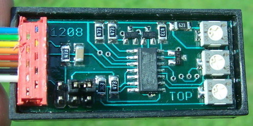

    Hey KT315 those closeup photos are terrible,I ought to know because I took them! Try these
    photos of my two 'Brand New" never installed kits! Notice the two C.B.'s they are different!!
    And How about my "Brand New" 6000 XL Pro
    just waiting for one of the kits to be installed!
      thanks duggr from all geotech community. seems you have a great nice sunny day there! please search possibilities of your digital camera in ZOOM mode.
      yours from Lietuva
        is this better

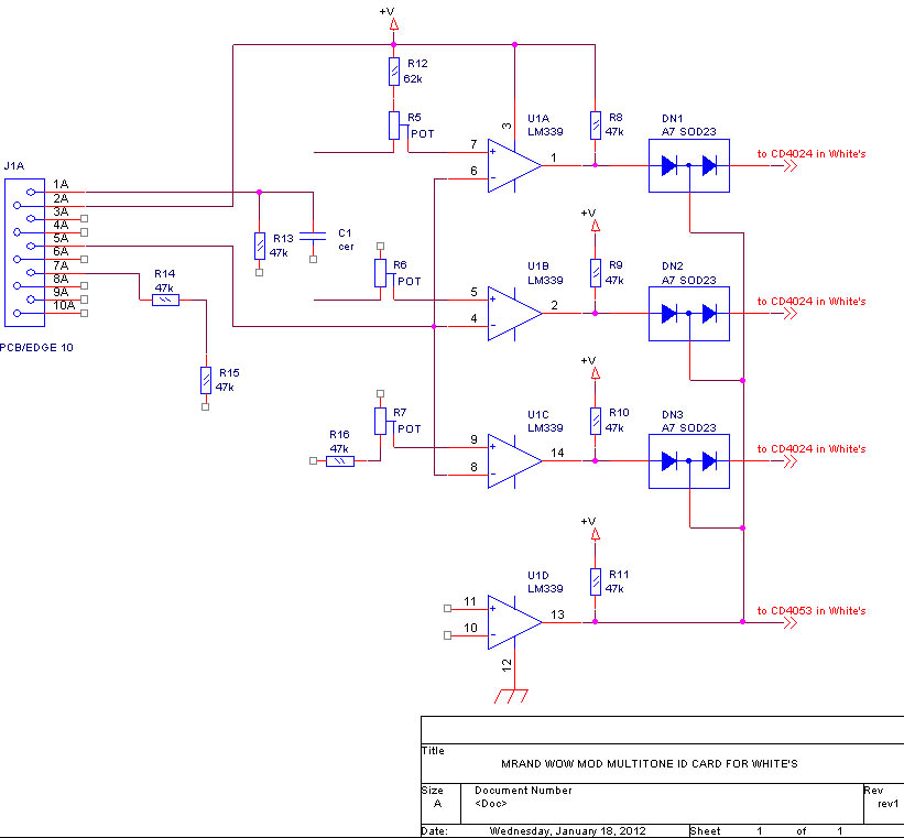

            thanks lots again, duggr. russian people helped to resolve the mystery of sir Mrand...
            this IC is... ARE YOU READY TO HEAR THAT NOW, FOLKS?!!
            LM339!
            cry, baby, cry! you long flout at all us!
              some traces are going not clear. update.
                Any schematics????
                Anyone have a schematic of the module PCB? Plus a schematic for the connection of the module to the main board of the Whites metal detector? Thanks for any information, for study purposes of course, very definitely to KT315...
                Whoops, just saw a schematic from KT315 pop up now. So thanks to KT315. Question on the connection to the Whites chips, any pin numbers here???

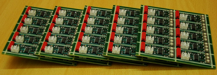

                  the photo done by Mrand (I believe his real name is Andhzej) 2-3 years ago... with huge bunch of the PCBs. thinking a price was 99USD for one.

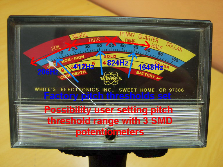

                        i can find this post of mrand he wrote about the pots at FINDMALL ... it is not a problem for me...
                        here one mrand pic from a post he wrote about 'tone ID on meter scale'...

                              I ask you again to give the people the full information. if you refuse I will continue to reverse the schematic anyway.
