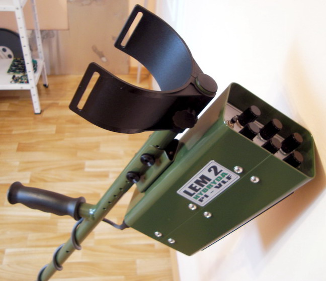

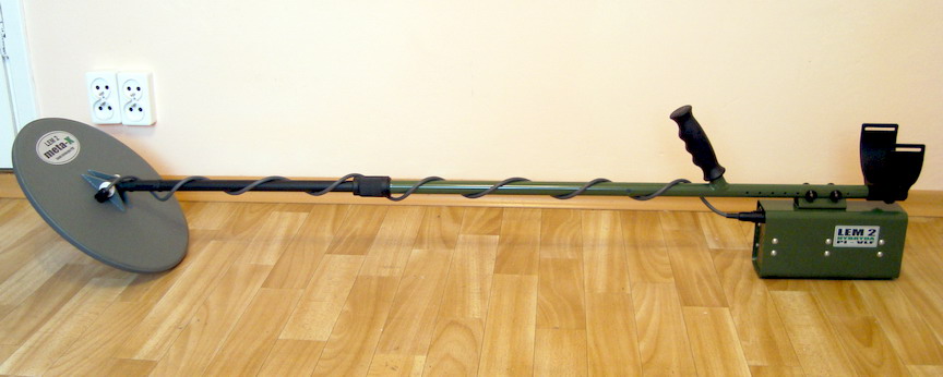

    I live off productions and service of the metal detectors, which serve mainly to works of sapper. My main product is the PI-VLF hybrid detector, which I have produced for three years. This is for me theme number one. MultiTone is only an appendicle. MultiTone is conceived as the commercial project. Therefore reverse engineering is an illegal and dishonest activity. It is so, if you burgled to the closed house and something it stole. If you will invent your own "315-Tone", you can do what you want. My project leave alone. Your approach testifies very badly about people from the east. To MultiTone I will come back when I will have few more of the time, or when will grow to me additional hands
    Mrand

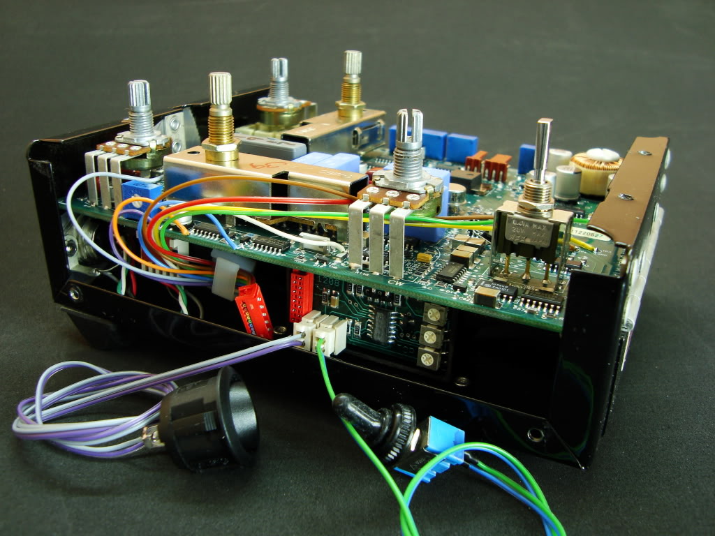

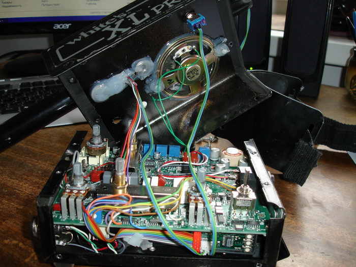

        kit installed
          yet one
            Here is a shot of a multitone card mounted on a 5900 Di PRO SL.
              thanks Turboair.

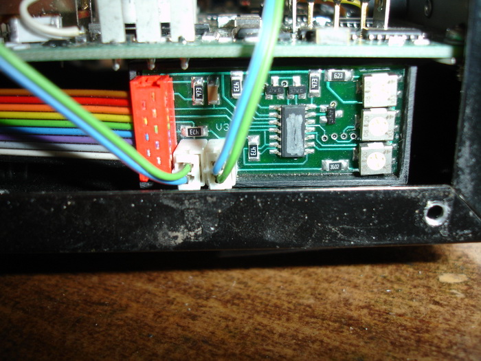

                people, you are waiting a result from me, but if there is nobogy ready to help me with information so I am not able to help you. I see only empty promises, NOT YET REAL DEAL. I need in THE DESOLDERING PCB IN MY HANDS. if you are ready to send the PCB write me PM.
                  The circuit diagram you've posted in the forum, I need are the connections to the PCB-PRO XL. The scheme I am sure that is correct. I do not know how to connect with the metal detector.
                    If I remember well, a track should be cut after you solder the pcb to the xlpro mobo
                      I've been thinking all night multitone mode and I think I accomplished something. To see what you think. The photo of the PCB of the 6000 DI-PRO does not look very good. I would like someone put a picture with more resolution to check all connections again. I have a PCB of the 6000 DI PRO SL and with his help I managed to make an identification.
