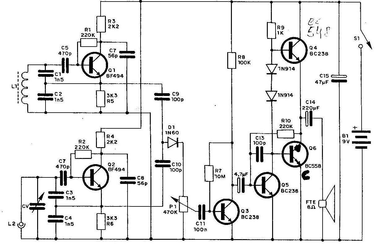

Non-metallic detector schematic!
    [ATTACH]Click image for larger version

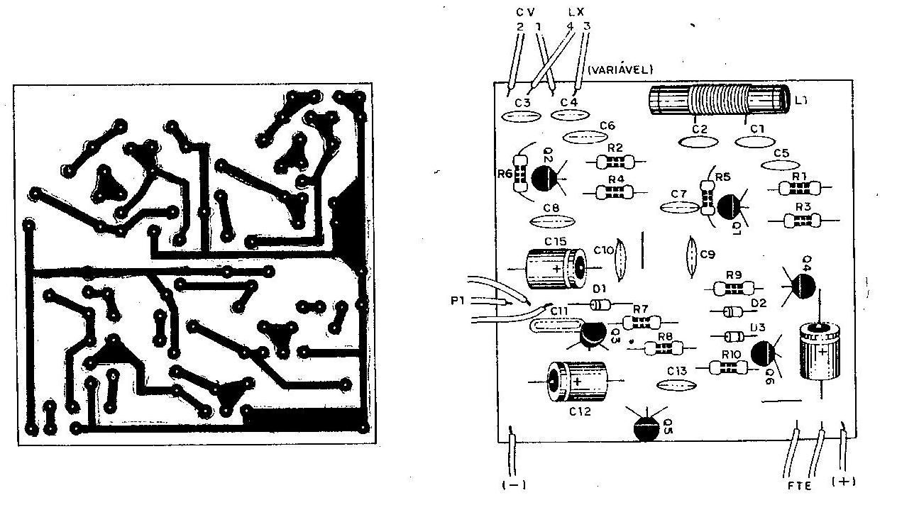

    Q1,Q2=BF494
    Q3,Q4,Q5=BC238 = BC548NPN
    Q6=BC558PNP
    D1=1N60 OU 1N34
    D2,D3=1N914
    CV=
    C1,C2,C3,C4=1n5
    C5,C6=470pF
    C7,C8=56pF
    C9,C10=100pF
    C11=100nF
    C12=4,7uF
    C13=100pF
    C14=220uF
    R1,R2=2K2 x 1/8W
    R5,R6=3K3 x1/8W
    R7=10M x1/8W
    R8=100K x1/8W
    R9=1K x 1/8W
    R10=220K 1/8W
    P1=470K COM CHAVE LIG/DES
    B1=9V
    FTE=8OHMS
      No infos about fix oscillator and variable oscillators? (L1 & L2) Text?

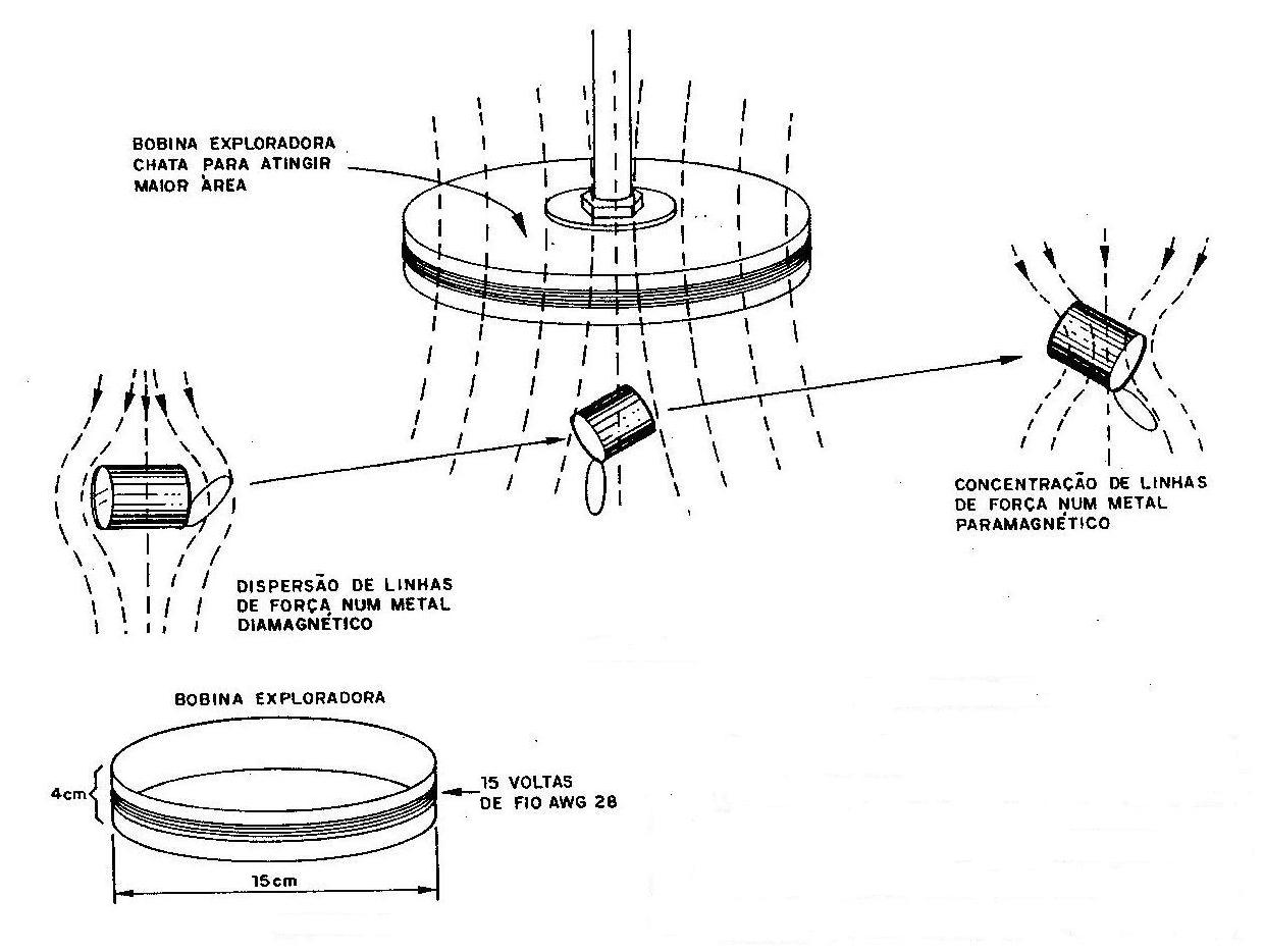

        Of course, dear friend, I built this detector, and sencivel.achei several coins, jewelry, etc ...
        Good ... ..

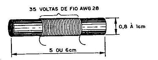

        L1 = ferrite rod of about 5 cm long by 0.8 or 1 cm in diameter. (Can break with one hit very careful if you have more difficulty in getting one of this size)
        L2 = a coil of diameter 15 cm with 28 AWG wire with 15 volvos together ok.
        My tests with this detector:
        # operating system ........ beats two osciladorespor change of inductance.
        # current consumption at rest .......( 5 mA)
        Food ..... # 9V (battery)
        OBJECTIVE # detected ...... ferrous and non ferrous, aluminum, copper, gold, etc ...
        # Diameter coil l2 ....... 15cm
        # Type alert ...... sound speaker
        # sensitivity ........ currency (5cm)
        ....... can of beer (30cm)
        ....... pot 30cm (80cm or more)
        note: I noticed that while the older the more buried metal sencivel is the detector.

          Note: the coil operator should leave 4cm height ok
            the CV or variable capacitor used in the setting and pelomenos 100pF, can be used CV type used in medium-wave radios are problems.
            Grateful for the space friends.

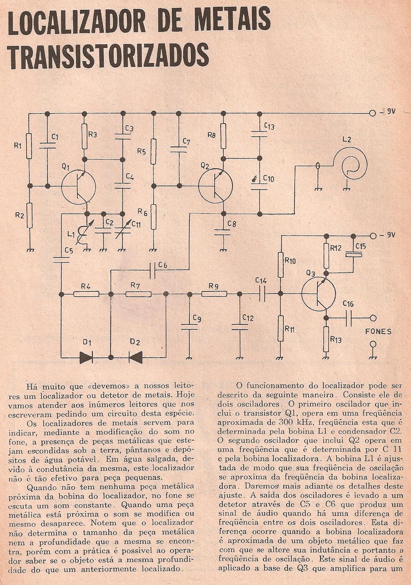

                                Localiser metal more good old schema.
