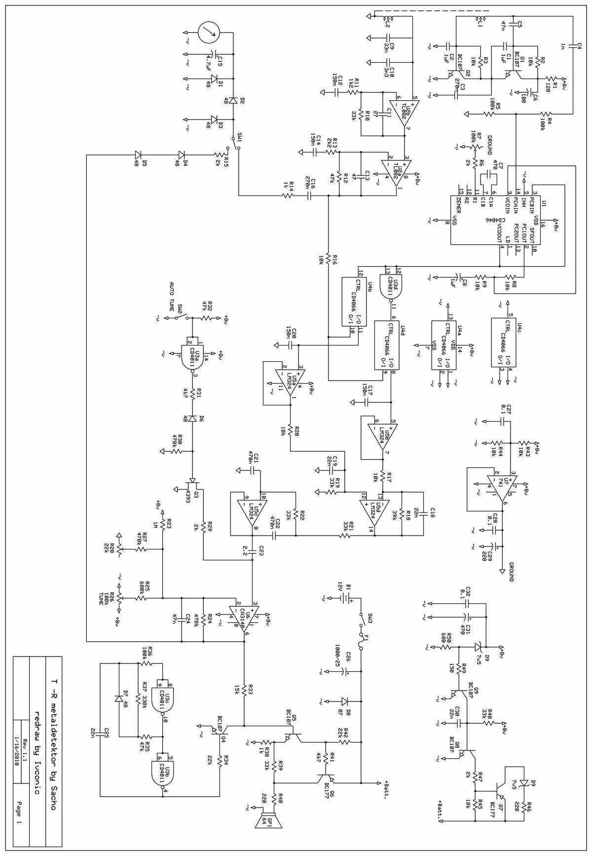

    I DESIGHNED PCB FOR TR LOCATOR SASCHO VARNA BULGHARIA .
    I WANT BUILD THIS DETECTOR, I THINK THIS DETECTOR IS POWERFULL .PLEASE HELP ME FOR BUILD THIS DETECTOR.
    YOUR OPINION ABOUT THIS TR SASCHO VARNA BULGHARIA .??????
    TANK YOU MY FREINDS
    I think that schematic is very unsuited (illegible) to follow in process of drawing pcb for it. Very awkward.
    Man can easily lost and make many mistakes on pcb draw.
    I don't know which method Sasho used to draw it but certainly it was worse possible.
    Since i am also interested in this design i decided first to redraw schematic and make it more legible, than later to draw pcb for it.
    So...here is my redraw.
    Not checked yet. It is possible that i made some small mistake (like always). Everybody interested is invited to check schematic. If there are some mistakes, please let me know to correct them.
    Thanks in advance!

      Hi ivconic
      Very nice drawing , please upload exprees pcb file.
      Best regards.

              Hi ivconic
              Redraw ver 1.2 changes include:
              D9 connected to +8v
              R27 , 4.7k
              Voltage divider by 2 , included r43 and r44 ,2x10k
              Although no problem and power section working ok but better
              Use 2x33k
              Best regards.
                Yes you are right about corrections, i see now my mistakes!
                Thank You very much!
                Best regards!
                (D9 designator is doubled...i did that mistake also, need to be redesignated)

                  Yes, it done .

                              Hi. Thanks for your answer. I'm trying to create the PCB from the scheme in the file sch. Unfortunately it returns me error. Does someone know how to help me?
                              The error is:
                              "The schematic file includes netlist errors that should be corrected"
                              I open ExpressSCH and try to use "checking schematic for netlist errors" and here some component not have pin number.
