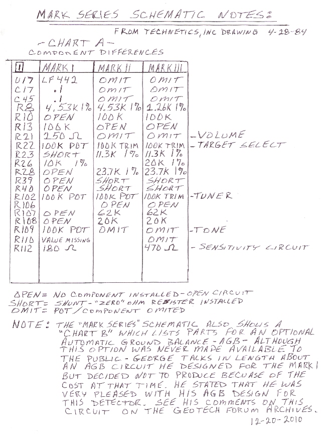

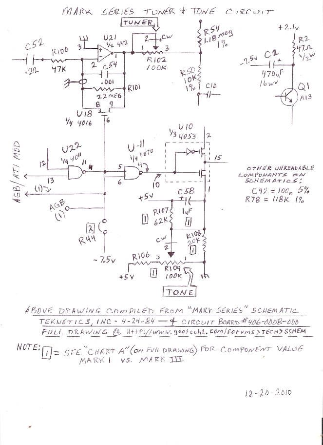

                        Clarification on the Mark Series Schematic_ Here
                        The following circuit drawings were created to clarify the "blurry" and missing portions of the Tektronics Mark Series Schematic found earlier in this thread. The drawing covers both the Mark I and Mark III. I traced and varified each portion using my Mark III Detector. It is very interesting to note that apparently the difference in the Mark I and Mark III are not a simple elimination of a few controls. The fixed resistors in the sensitivity circuit are also different as well as a few others. These are in addition to those resistors listed in the Original "Chart A". My "Chart A" lists these additional resistor differences as well. See below. Many Mark users have stated that they thought the Mark III was more sensitive than the Mark I. Waiting for more input from users on that topic.
                        Also interesting is the AGB circuit shown on the drawing that was never put into production becuase of the added cost at that time. See the link below for georges own words on this AGB design that almost made it onto the Mark Detectors.
                        http://jb-ms.com/Baron/gb.htm
                          Georges statement on his AGB Circuit Mark Series
                          I mis-quoted George Payne on his comments regarding the AGB circuit he designed for the Mark Series. Actually what I did was not give the whole quote. I stated that George said he was very pleased with the design and its initial performance. What I neglected to say was that he continued and said it needed alittle more developement becuase it could lock on to large targets. Matbe that was part of the reason he left it off the production model. Still very interesting reading though....see his artical link in my previous post if your interested in reading the entire artical on Ground balance circuits.
