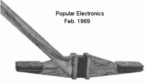

    Carl Moreland issued the following picture of orthogonal sensing head. We found the circuit diagram and sensing head described in a Czech magazine, but it is too short and gives no information about the method of adjustment. We are looking for original description in English.
    That looks like a proto "Big Foot" coil. If somebody can't dig it up, I can as a last resort from microfilm. But it might take a while (weeks).

        After doing a considerable search for this article online, I could only find an abstract that mentioned that this actually uses a bridge circuit to detect a change in inductance, rather than mixing with a second oscillator. As such, it will suffer from the same limitations to depth as a BFO unlike a VLF that transmits a signal. If you look at the coil above you actually see three coils, the fourth leg of the bridge is internal to the detector. It still would be interesting to take a look at the specific circuit though.
        However, I took a look at the index, and I did not see Carl Moreland's name. Leslie Huggard wrote the article, and there is another article by her in the schematics section on this site showing a design using a single lm386 with a bridge type circuit.

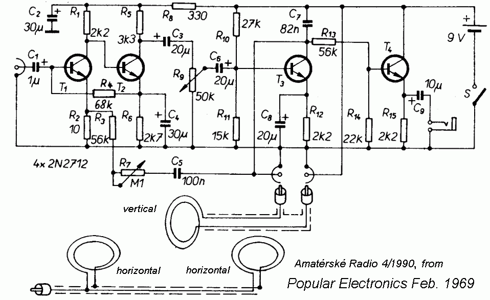

          Here is the circuit:
            Interesting schematic. Probably there are in Chech magazine Amaterske Radio some text too (about windings, coil inductance etc.)?
              It looks similar to this one. Same coil arrangement.

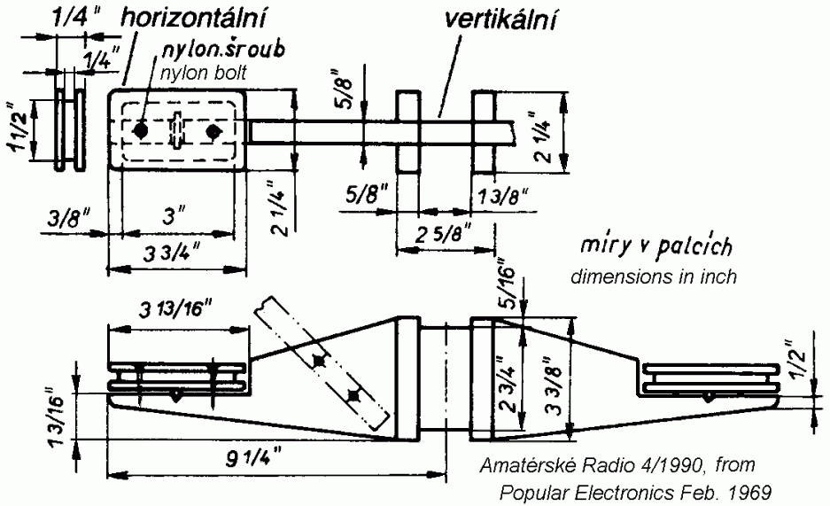

                This is drawing of sensing head:

                  For us it is important to read the original in English, because we can not disentangle
                  - why both RX coils are connected in parallel instead in series,
                  - why there are two potentiometers instead only one,
                  - why TX coil is tuned, but both RX coils are not tuned etc.
                  We have called this project IBR (Induction Balanced Regenerator). This is
                  principle for extremely economical metal detector, which meant in our jargon as QRP MD. With a battery it will work an year!

                      Here some google translation from Czech:
                      Atypical metal detector
                      This detector is based on the use of balanced -
                      mitted inductive bridge and is working with
                      low frequency signal frequency. Induktion bridge consists of two systems
                      coils, which are mutually perpendicular and form
                      input and output audio-frequency circuit
                      amplifiers with high amplification. When
                      coils so designed that in post -
                      bed very close to the ideal perpendicularity is the
                      them sufficient inductive link, which would
                      to introduce feedback to an extent suffi -
                      tangential to oscillate amplifier. When
                      However, the group gets close coils
                      metal, balance is disrupted, there is a backward
                      binding, an amplifier is vibrated and arises hear -
                      Net realizable signal. Diagram of apparatus is shown in Fig 14th
                      Basically, it is unstable low-frequency
                      amplifier with high amplification. From scheme
                      the obvious way system involving coils.
                      Because the intensity of magnetic field
                      distances are shrinking rapidly and the effect of metal -
                      tion course in this field is rapidly disappearing
                      with shrinkage of its size, is very ob -
                      Gravity to develop equipment that could zjiš -
                      indeed face small objects at a distance.
                      For detectors that are used for localization
                      coil ends, when the number of turns and da -
                      It current coil array at a distance
                      axis coil depends on its diameter. The
                      larger the diameter, thus making the field. The
                      However, the larger diameter coil, the greater must be
                      metal object from the field could not affect -
                      thread. For this type of detector is always necessary
                      use a compromise between the size of objects,
                      to be detected, and the distances in
                      to be detected.
                      Described detector detects aluminum ring
                      concluded beverage cans, or seven -
                      centimeter nail in depth of 5 cm. Larger
                      objects such as the lid of the bin, it is possible
                      determine the depth of 50 cm. Detector is more sensitive
                      for ferrous materials, because they are more
                      influence on the magnetic field.
                      When designing the electrical parts must be taken
                      to deploy components to the amplifier
                      stable, that has not been implemented parasitic neck -
                      between the input and output amplifiers.
                      Very important is the construction of sets of coils.
                      The main material for its mechanical
                      construction is wood, drawing, figure 15th In the
                      In addition to making non-coated wire
                      uses no metal. Note that both
                      horizontal coil with adjustable position
                      order to set the minimum bond.
                      Horizontal coils have 470 turns, vertical
                      coil has 870 turns. Coils are the cabinet
                      an electronic circuit connected coaxial cable, as shown in wiring diagram.
