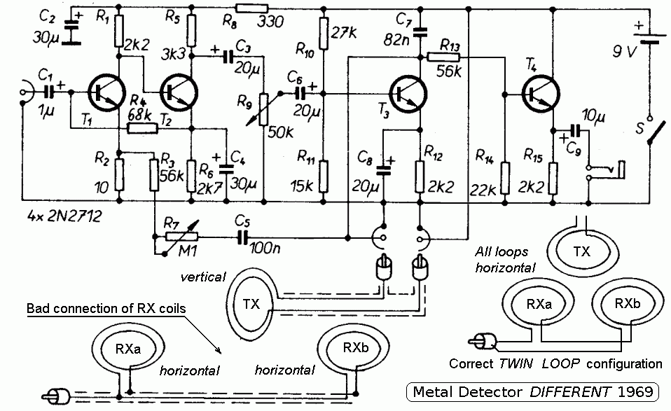

      When you know the right block diagram, you can find errors and weaknesses of the various circuit diagrams and designs using this principle and to correct them.
      Consider if the circuit diagram of "Different 1969" adhere to the block diagram according to our requirements.
      1. Coil configuration. The RX coils must be connected as TWIN LOOP, ie in series and in opposite directions to have their signals subtracted. Thereby suppressing the signal from the ground and the interference from distant sources and even by working nearby other metal detectors.
      This is not done. In the original, each RX coil shunt any signal generated by the other RX coil. The signal from the remote interference source and from working nearby metal detector is not suppressed because it induces synphase voltages in each RX coil. Proper connection is shown in the block diagram and below in an example design.
      The TX coil must be oriented so as to provide intensive and vertically oriented down to earth magnetic flux. However, in the original sensing head, a horizontally oriented magnetic field runs through the TX coil, which gives rise to two weak magnetic fluxes in different directions on both ends of the sensor.

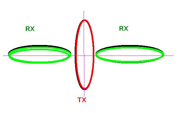

        You mean physical oriented, like this?:

          2. Block 4 PREAMP is a wide band amplifier because the RX coils are not connected in tuned circuit. That means more thermal noise generated in input. It is preferable instead capacitor C7 connected to TX coil, to connect a capacitor to RX coils.
          3. Block 5 PHASE SHIFTER in the "Different 1969" is formed by TX tank circuit formed by C7. The tank provides voltage signal without phase shift at resonance frequency, but its phase diagram is very steep in this point; in a narrow band the phase varies from +90 deg to minus 90 deg. That means the regenerative loop has trend to oscillate in a frequency determined preferably by phase characteristic of TX tank, instead by those of target.
          The phase shift control by R7 is insignificant because the cutoff frequency of this branch varies from 10Hz to 28Hz. The capacitance of C5 should provide for an audible cutoff frequency in order different targets to sound different.
          In fact, both potentiometers R7 and R9 control the gain of regenerative loop without phase shift.
          4. Block 7 for DISPLAY OF OSCILLATION is an amplifier without volume control. It amplifies the TX frequency, which is an unpleasant high tone.
            Yes, this is the principle of loop orientation used in "Different 1969". This is the sensor with orthogonal coil configuration given as example in article "Coil Basics" by Carl Moreland. The RX coils in this configuration can suppress the ground signal if are connected in series as shown in posting #16 , however this sensor can not suppress signals from remote sources and nearby metal detectors.

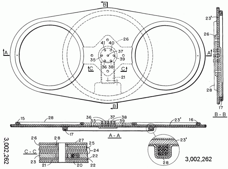

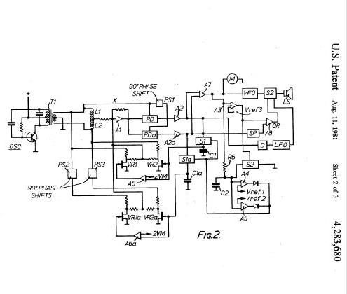

                Actually, the hounddog circuit posted above is a variant of a "bridge circuit," though a somewhat dysfunctional one. Estaban's schematic would be another example of a bridge circuit i.e. induction balance type. The russian miniature detector 1972 (I posted a link above - does anybody have the original Russian source for this??) is a very good example of a transformer coupled oscillator (it looks like a bridge circuit, but it's not) and is a simple TR detector that's close (but not quite) to offering VLF discriminating. "Different 1969" is most likely another example of the dysfunctional bridge/hounddog. I call it "dysfunctional" because it's not always oscillating and more like a BFO in performance instead of a TR. The CCO detectors are BFO circuits that use a transformer coupled oscillator and operate at 500 KHz (the one transisotor AM radio metal detectors are an example) like many BFOs (frequency shifts) do.
                The patent 3002262 is *not* a patent for a wide scanning detector (though it shows a search head for one), but rather a very informative patent for making one. Thanks mikebg for posting that one.
                    Thanks technos, for all clarifications.
                    Can you explain what does you mean by terms "wide scanning detector". Wideband regarding search frequencies, covered search field or some others mean?
                        Nothing with frequencies, but yes it means a large search area under coil. Like what the bigfoot coil does also - you cover a larger area with the detector than with a smaller coil.

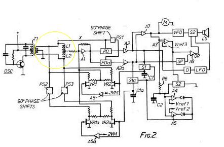

                              Hi technos. Coil Coupled Operation (CCO) Metal Detector:Search oscillator IC1a oscillates at around 500kHz, depending on the positioning of the coils on the search head. The presence of metal induces changes both in the inductance and coupling of the two coils, thereby inducing a shift in oscillator IC1a’s frequency.A second oscillator, IC1b, together with buffer IC1c, serves as a beat frequency oscillator, oscillating at around 2ยท7MHz. This higher frequency avoids frequency lock, and also increases sensitivity. An LC oscillator was chosen here for its stability, to avoid problems with drift. The CCO MD in postings # 39 and # 48.
